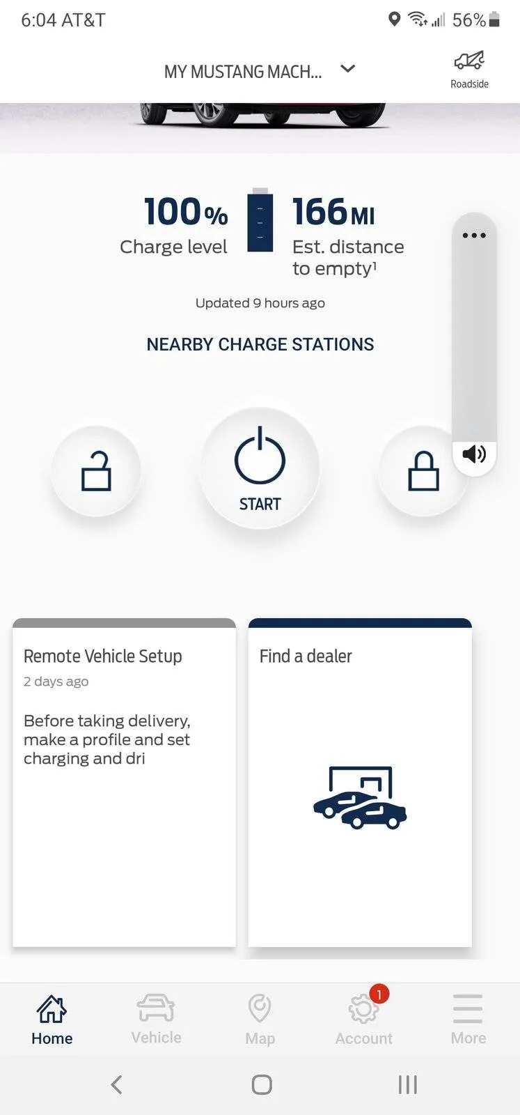

So, how could I have set up the app wrong? I created an account. Added the vehicle via VIN barcode on sticker, waited for the acitvation code on the car display. Got confirmation in the app. There are no prompts to follow to setup PAAK.
Uninstalling the app does not remove your login or the vehicle. When you reinstall the app and login, the vehicle will still be there because it is stored on the ford site.
I’m having this same result, both my wife and I are using iPhones, PAAK has never appeared as on option in the app and there hasn’t been any prompts about it
