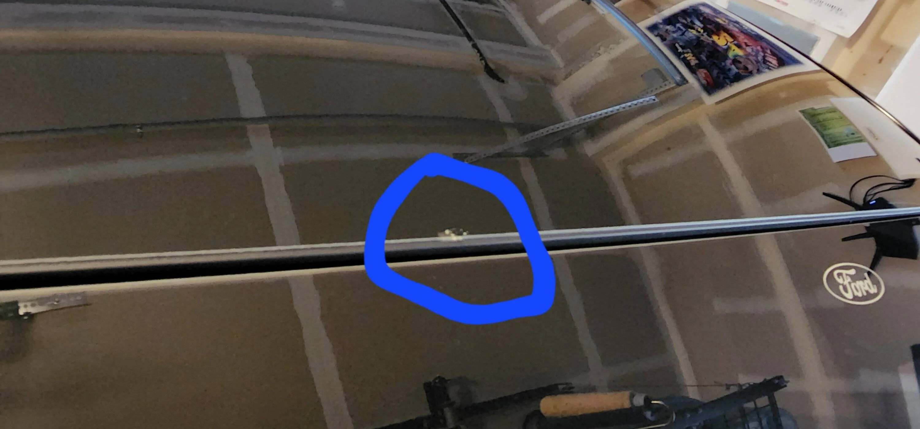

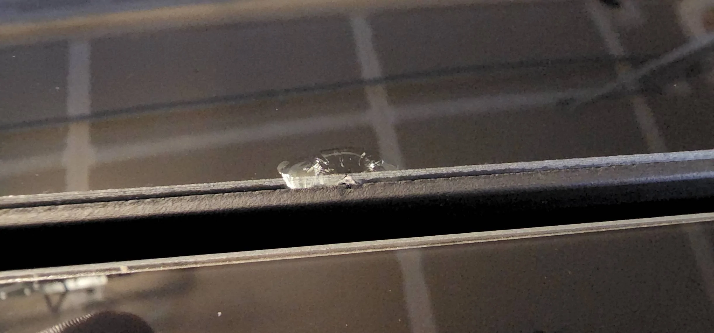

So my roof edge got hit by a rock. I've attached a couple of pictures. GTPE built in 8/21. Can this be repaired, or because this is the edge of the glass, it is replacement time?
Would this be covered by the recall for the roof?
And where does one obtain said "T" gasket?
Thanks!
Thanks!
A glass shop can look at that and determine if there is anything that could be done to stop that from cracking and spreading. This is covered by your insurance comprehensive coverage, or separate glass coverage. I have $0 deductible, so I would get a new roof.
Why would a rock hitting your roof be covered by any recall of any type, much less a recall that simply puts foam and adhesive inside?

I too have the complete, no deductible glass coverage. I learned the hard way two cars ago. :)
However, when I tried to do an online claim for glass (it goes through Safelite), there is no option to pick the roof, only the windshield, doors, and liftgate.
I was reading some of the posts about the roof line being too high, so not sure it is supposed to have that leading edge exposed like that, or at the very least, it should be reseated. As others have mentioned, the car is a rock magnet, especially here in Seattle.
Pick up the phone and call your insurance company if the online system doesn't work.
Yes, that is how it looks. 4.4mm is the spec. There is a TSB to check roofs on 2021s built on or before 2/15/21. https://www.macheforum.com/site/thr...d-noise-built-on-or-before-15-feb-2021.10791/
