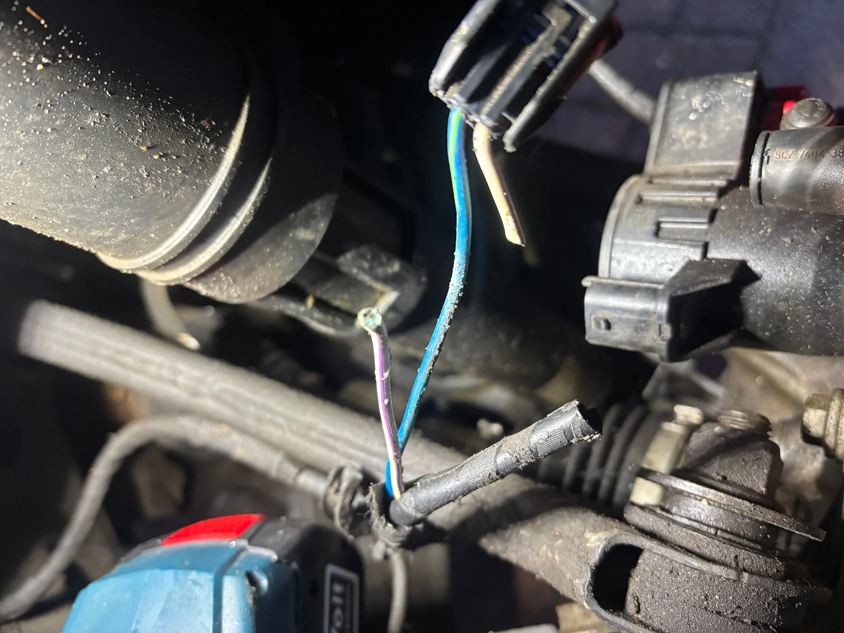

My lefthand (N/S) parkbrake (handbrake) failed with the warning as the OP describes. The purple/white wire about an inch from the connector broke (see photo). It looked like it had corroded but stripping the insulation back, the multi-strand wires were clean. Soldered a new bit of wire in, insulated it with a couple of strink teflon tubes and the warning light cleared. Common problem, but no recall in the UK.
A couple of links from this forum:-
https://www.macheforum.com/site/threads/parking-brake-fault-need-diagnostic-info.47812/#post-1045286
https://www.macheforum.com/site/thr...tronic-parking-brake-harness-connector.27496/

I’m doing a 3,800 mile road trip around France over 37 days in May/June and this is the only issue I’m concerned about happening while I’m away. Ordered the Motorcraft WPT1506 Wiring Kit from the US (arriving today). At least then if it breaks and immobilises my vehicle in rural France I’ve got the part and instructions to hand.
Suggest you also take a 12V soldering iron, solder, lengths of vehicle wire, shrink Teflon tubes, a lighter (to shrink the Teflon tubes) and maybe some crimp connectors + crimp tool. You never know. Also consider Mach-e jacking pads, jack and wheel nut brace (far easier to do the repair with the wheel off). Link to the pads is below (there are cheaper ones on Amazon). Best of luck 👍
https://www.amazon.co.uk/dp/B0CLL8W4ZN?ref_=ppx_hzod_image_dt_b_fed_asin_title_0_0
Sorry forgot - and some self amalgamating rubber tape to seal the harness after the repair.
