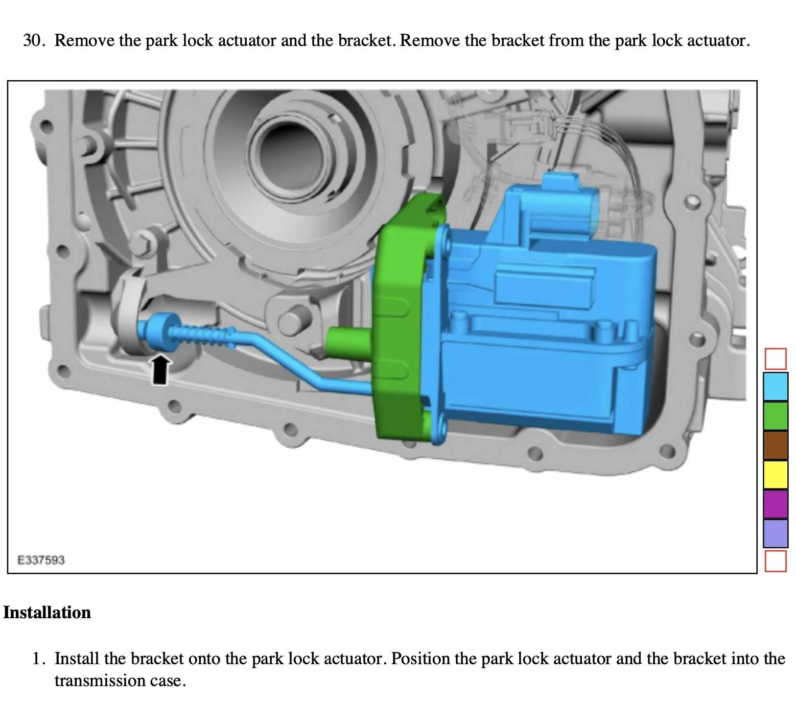

Per the service manual, there is a "Park Lock Actuator" inside the transmission which is electrically energized when the dial is switched to Park. Looks like this:
Ford Mustang Mach-E Parking. No more "PARK"? Screen Shot 2021-05-16 at 3.54.34 PM

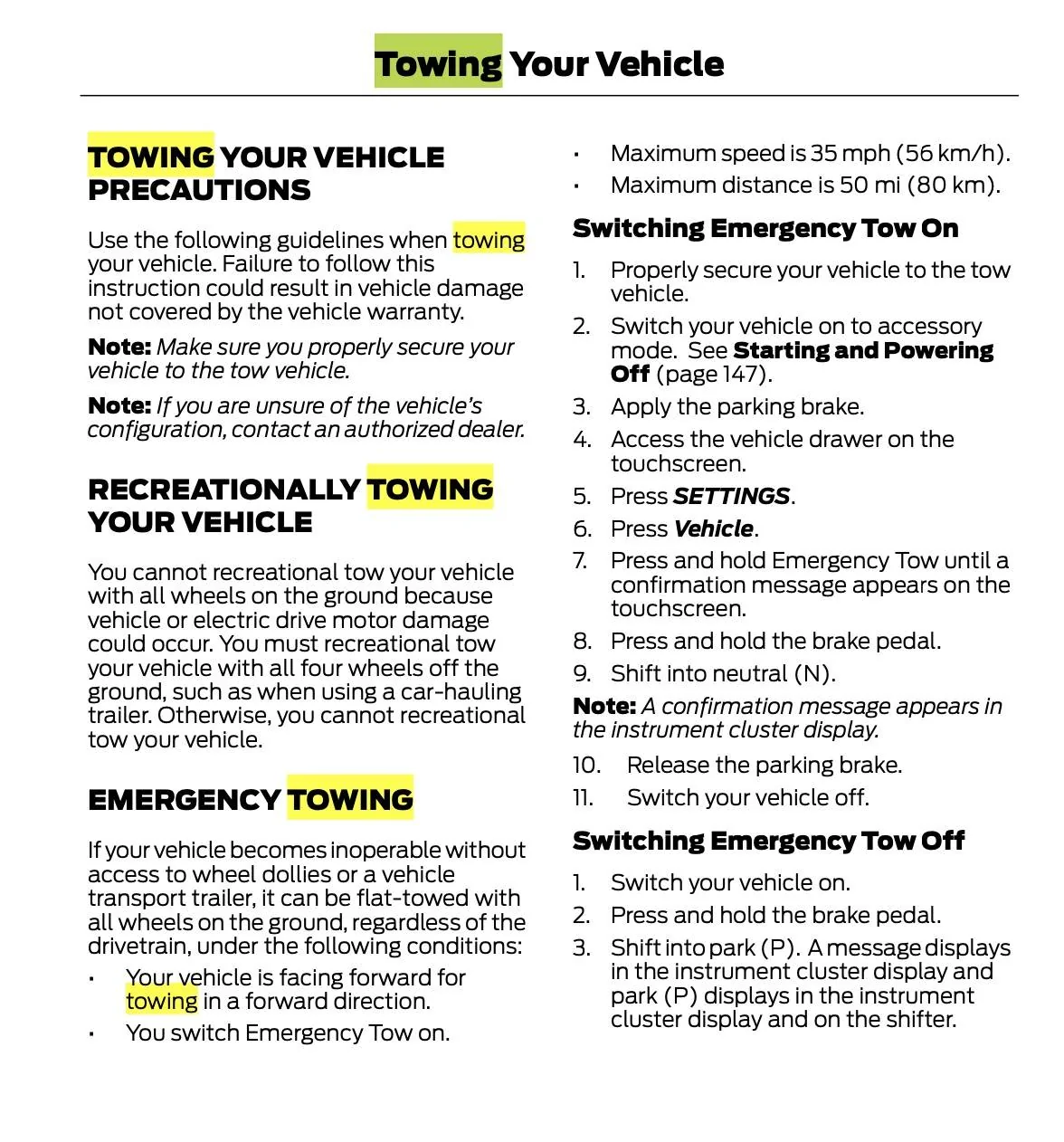

Ah. So, a second question.... If the car's dead or the software reverts to Windows 3.1*, can it be unlocked so the car can be rolled, say, into a service bay at the repair garage? There has to be an override... you'd think.
*NOOO. I didn't mean it. No no no no. Let it die.

If the car is dead, you can hook up a 12V source to the jumper wires behind the cover in the front bumper to open the frunk. That will allow you access to the LVB to charge or power the car. You can then switch on Emergency Tow (directions are in the owners manual). However, if the software messes up, not sure if there is anything you can do at that point. The service manual does not show any type of manual override.
Ford Mustang Mach-E Parking. No more "PARK"? Screen Shot 2021-05-17 at 12.56.08 AM
