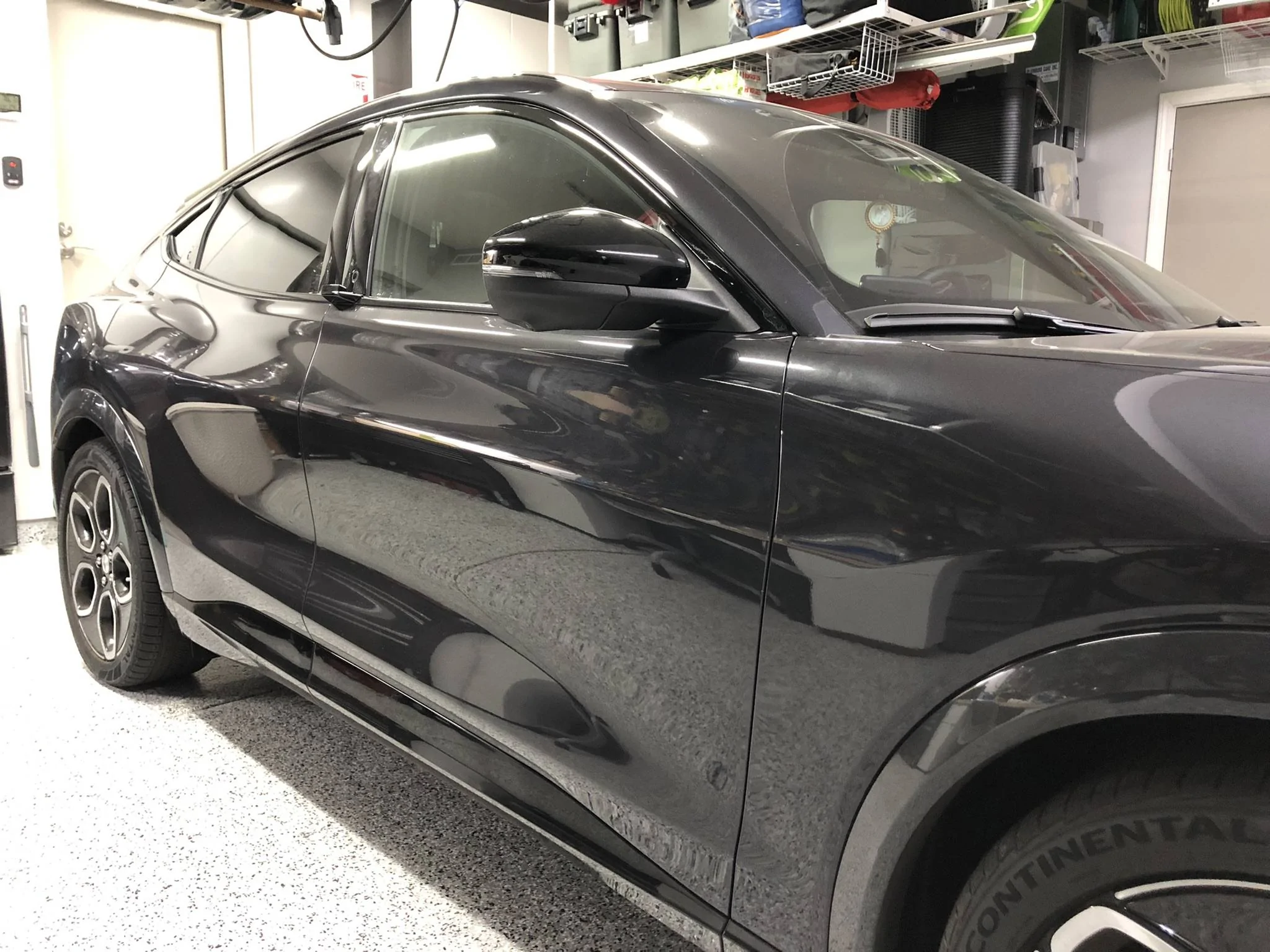

Knocked it out myself. Was super easy and glue practically rolled right off.
Not so easy for me. The floss worked well enough, but my glue was far more tenacious - took a fair amount of Goo-Gone, blow-drying, peeling, and patience.
Next time, try leaving the Goo Gone on for 15 minutes before trying to remove the adhesive...then try rolling it off.

As for the debadging. I found it very easy with a NFC badge (credit card) first to remove the badge. Then I just used my finger to remove most of the tape that was stuck and finished it with a little bit of goo-gone. It took maybe 10 minutes each side.

Took me an hour total using GooGone, floss, hair dryer, thumb (1 blister), and more GooGone on a paper towel.
Good to be rid of the side badges, though - looks neater, they'd probably break eventually, and no remaining trace of the dumb "Mach-e" name.

I tried the floss method first because I saw people on here recommending it. I remembered someone saying they used a credit card which they found easier. It took me about 10 seconds of flossing before I pulled out a NFC key badge and it went lickity-split after that.
