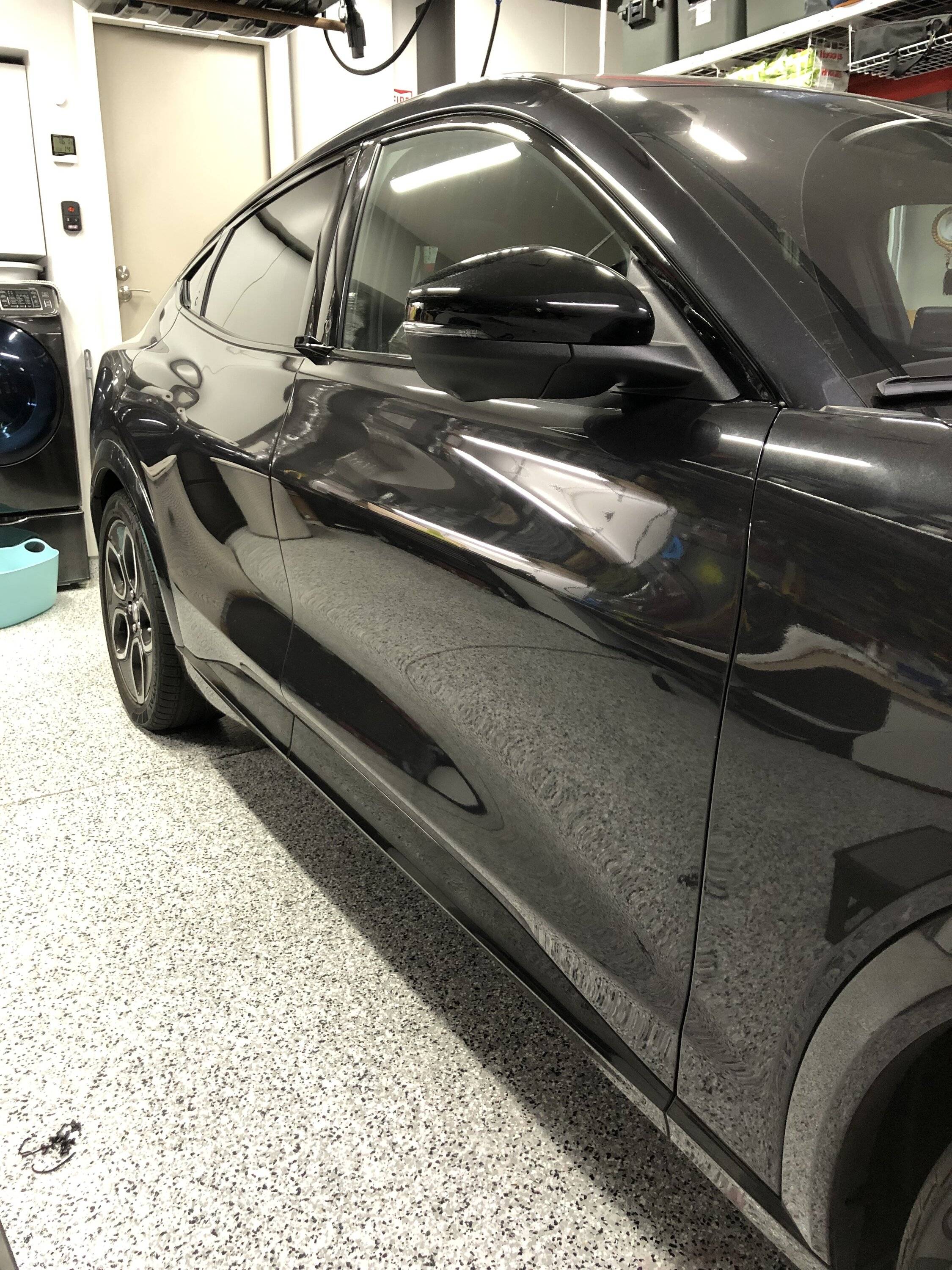

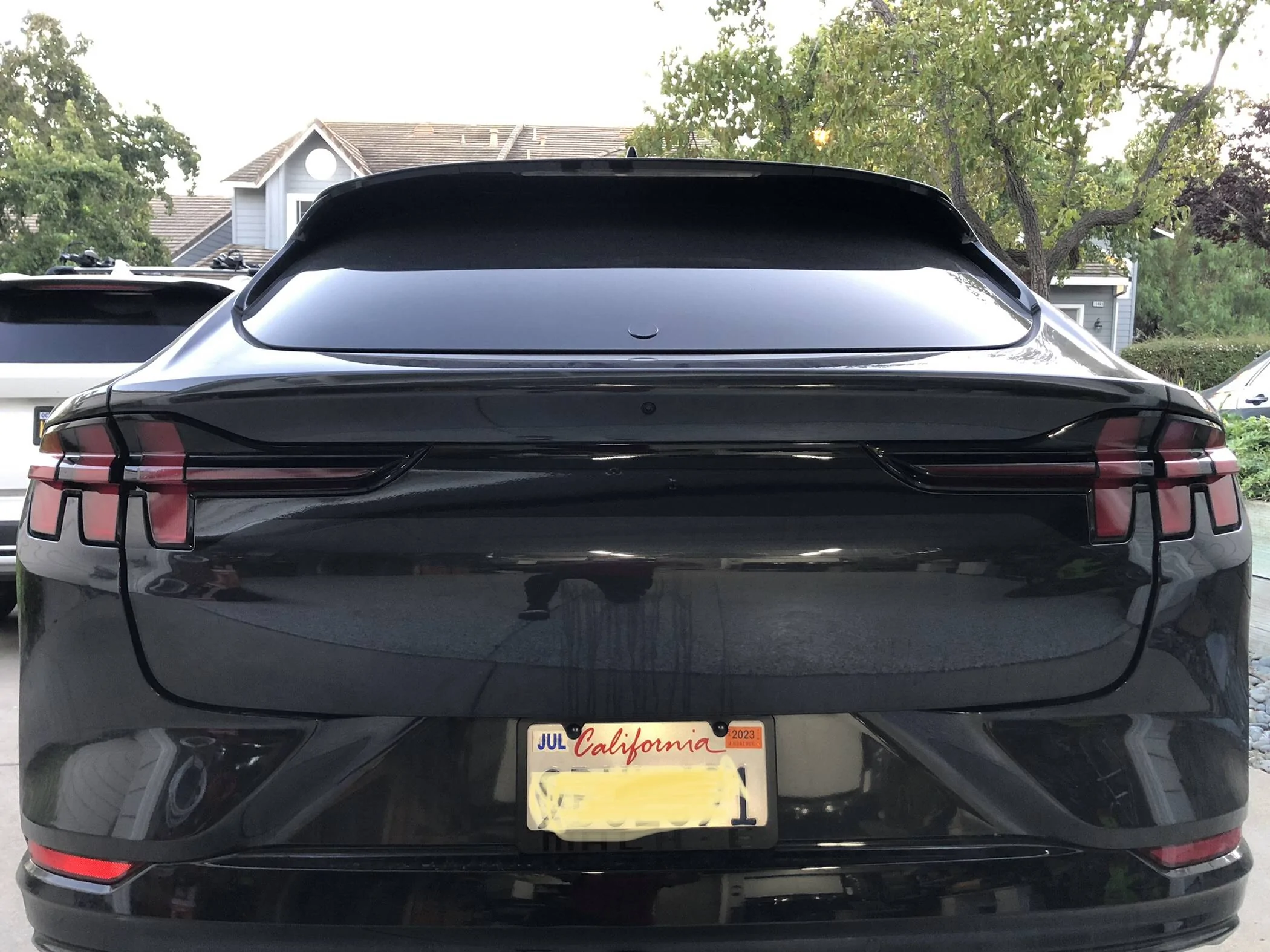

I was hesitant to remove the badges, but the process was very simple. Just used dental floss to remove the badges. The adhesive came off easily by peeling it back on to itself. A coat of wax removed any residual adhesive. Here is the new look (with AOSK mud flaps painted gloss black and Conti DWS06+ 255x45x20 tires):
