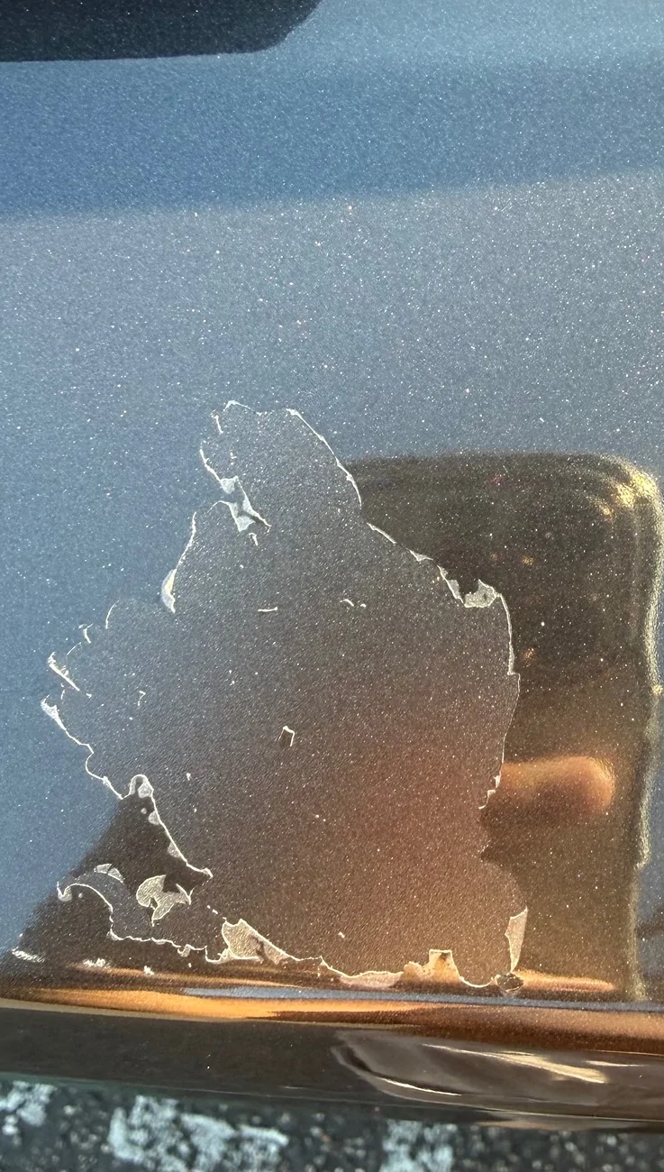

Has anyone had issues with clear coat peeling? Just noticed beneath rear window after hand car wash

Its cause is poor adhesion consequent to poor preparation techniques employed when painting the car before and in particular prior to application of the clear coat.
Its cause seems distinct from that which might cause bubbling.
It’s also unusual but not unheard of to see such a paint defect on manufacturer’s original paint so is likely that at least that panel has been repainted at some time.
Try eye-lining, viewing obliquely across the surface of the panel using light reflection to examine the texture and appearance of surface of paint on that panel, comparing it with that of other panels around the car and in particular panels furthest from the affected panel should provide a clue.
An electronic paint & coating depth might assist because that will enable a comparison between the depth of paint & other coatings (including body filler) but can only tell you the depth of paint, not when the paint was applied so making a test I describe above by a trained eye necessary.
If observant, my visual test above should inform you whether the paint is or is not Manufacturer’s original.

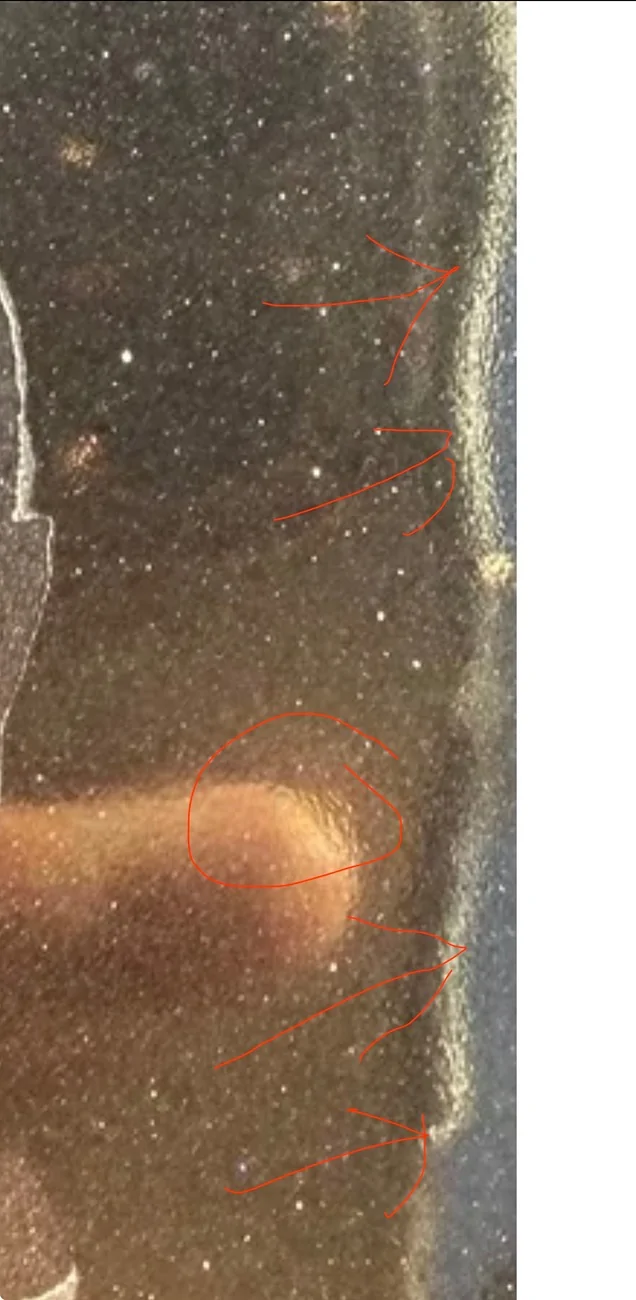

Looking more closely for clues of aftermarket paint, the surface of the paint seen where light is reflected appears terribly affected by orange-peel effect, see attached annotated screenshot of your picture.

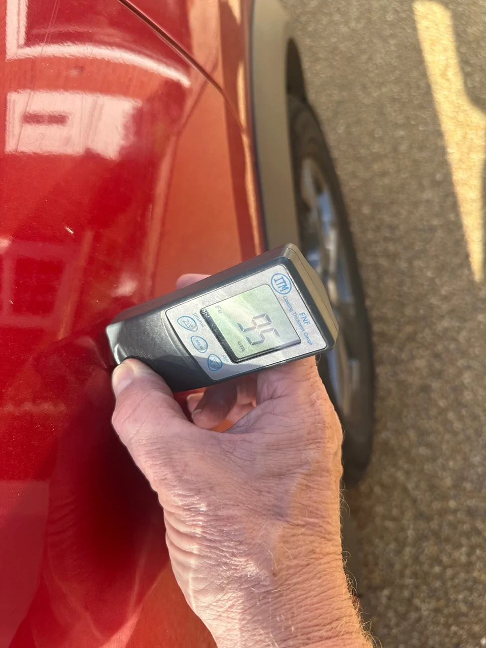

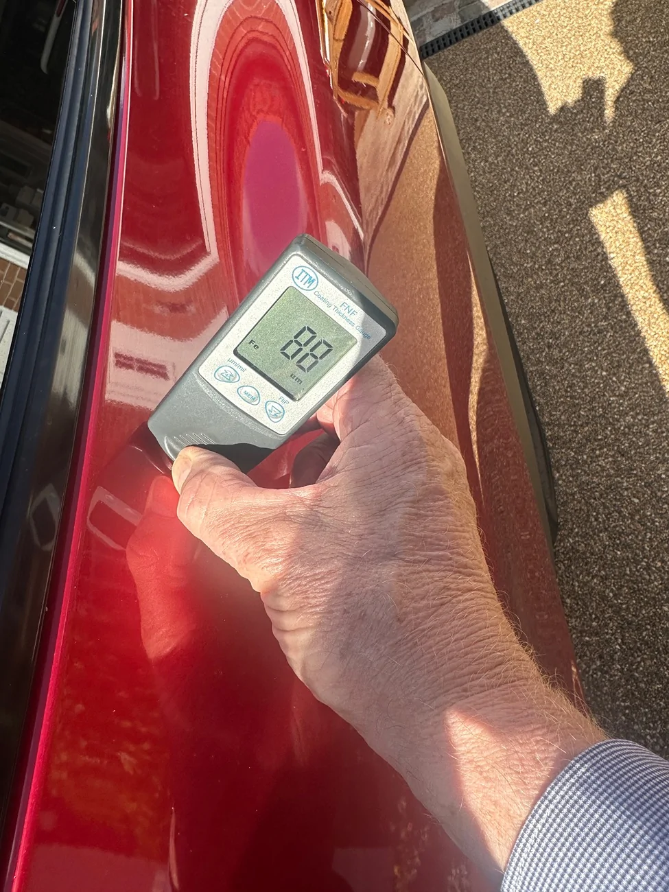

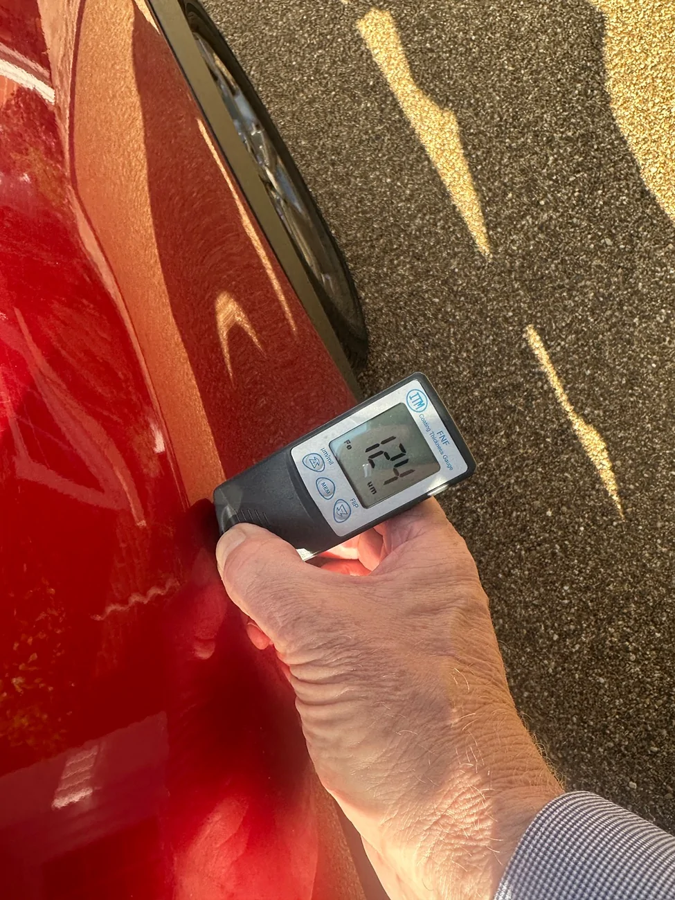

For reference, I just run my depth gauge across the panels on my car that I know for a fact have not yet been repainted and see the manufacturer don’t put much of a depth of paint on the door illustrated, and even less on the roof rails 70mu/metre.
