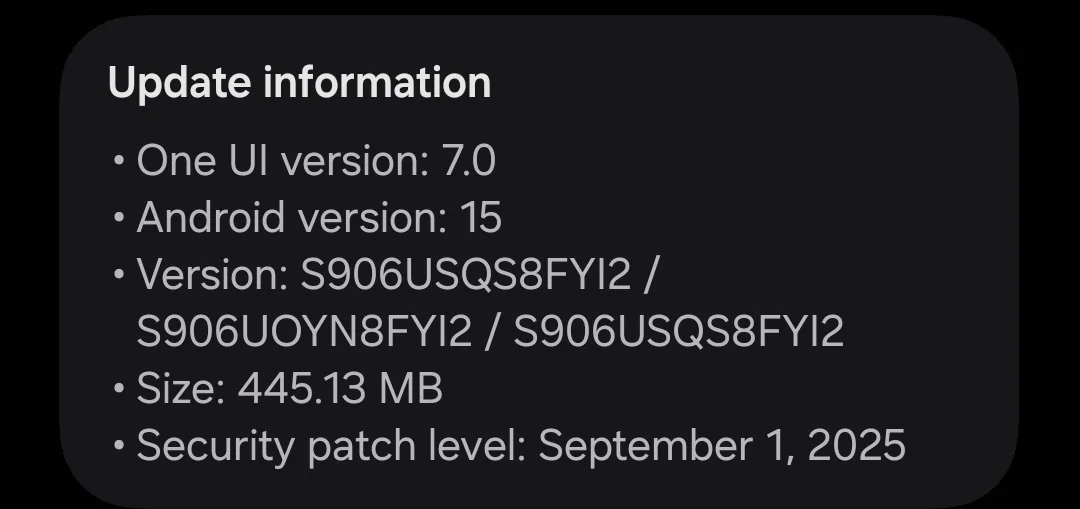

My S22+ PAAK works fine now. I had some issues a week or so ago possibly around the time of an update.

Do you know which kind of update it was? Google play, security, or Android? I just updated to Android 16 a few days ago, but my security is from 9/1 and Google play is from 8/1.
It was a security update installed on on Sept 28th. Looks like Android 16 wasn't pushed yet. Google play is Sept 1.
