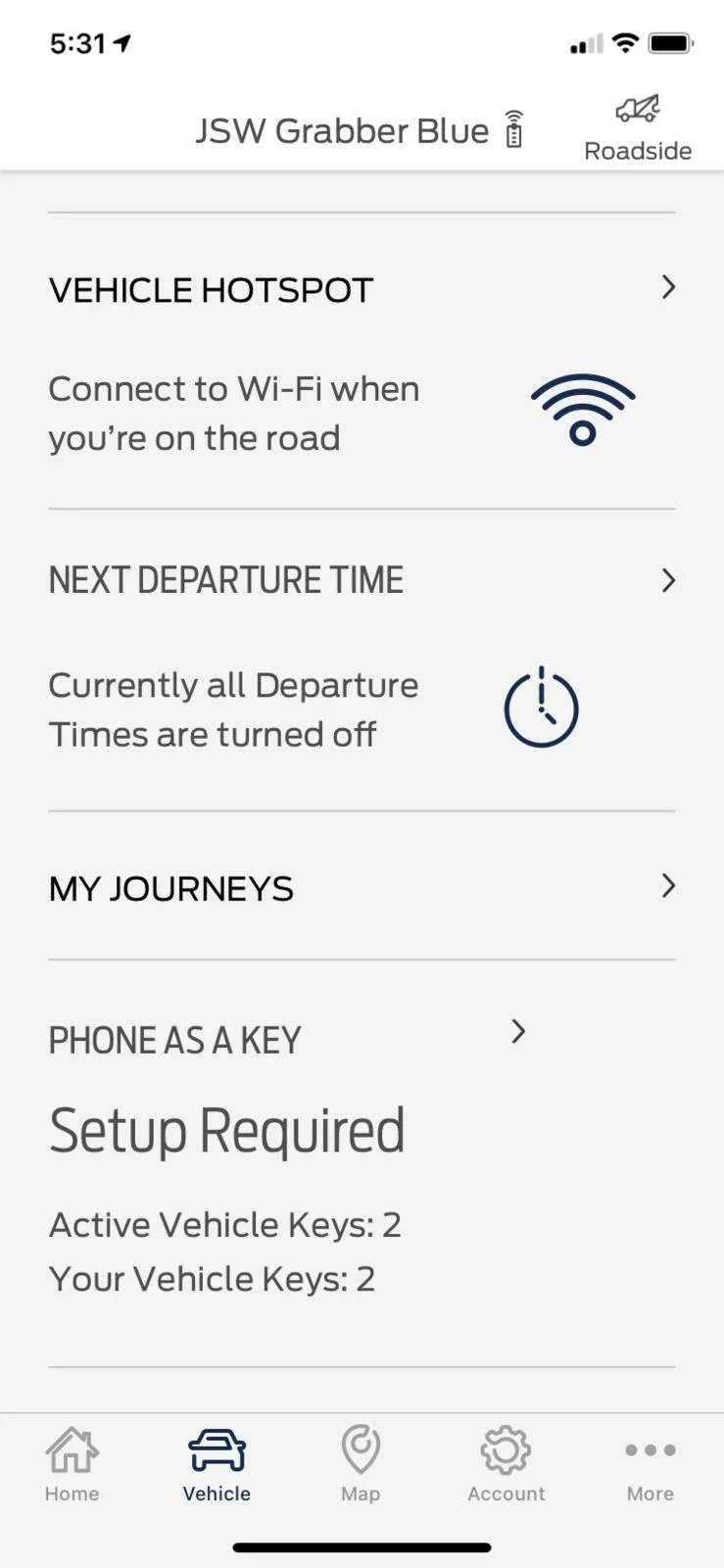

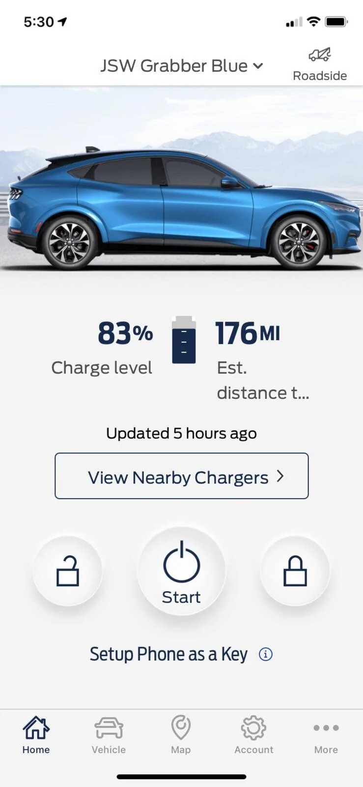

PAAk not only fails to work consistently, it keeps dropping from FordPass altogether. I’ve only used my iPhone 11 To set it up.
Right now, Fordpass won’t recognize my phone or previous PAAKs and is again asking me to set up PAAK. (Pic 1). I’ve already done it twice, and FordPass, on page 2 notes that there are 2 active PAAKs - previously set up with the same phone. (Pic 2). FordPass remembers them as active keys, but won’t actually recognize the phone/PAAK.
I'm not going to bother a third time - it works sporadically for a week and then, out of the blue, it stops working altogether and asks me if I want to set up PAAK (pic 1).

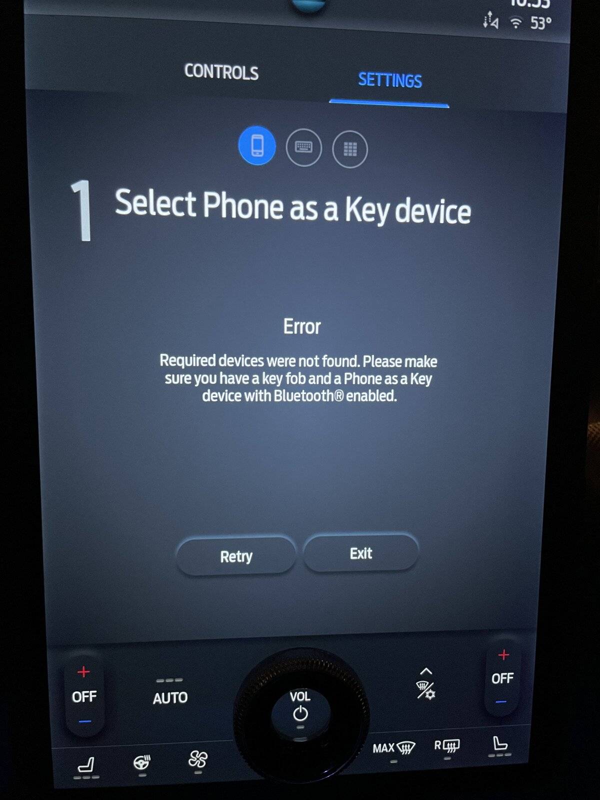

Well, I spent an hour resetting and adding PaaK for me and wife. This was to ensure I was able to set two different backup start passcodes. However, checking the status of the backup start passcode today, it appears that both passcodes are no longer assigned, and/or were somehow not saved. Attempting to add one results in an error (same one I experienced before). After spending an hour resetting PaaK, I’m loathe to do it again.
