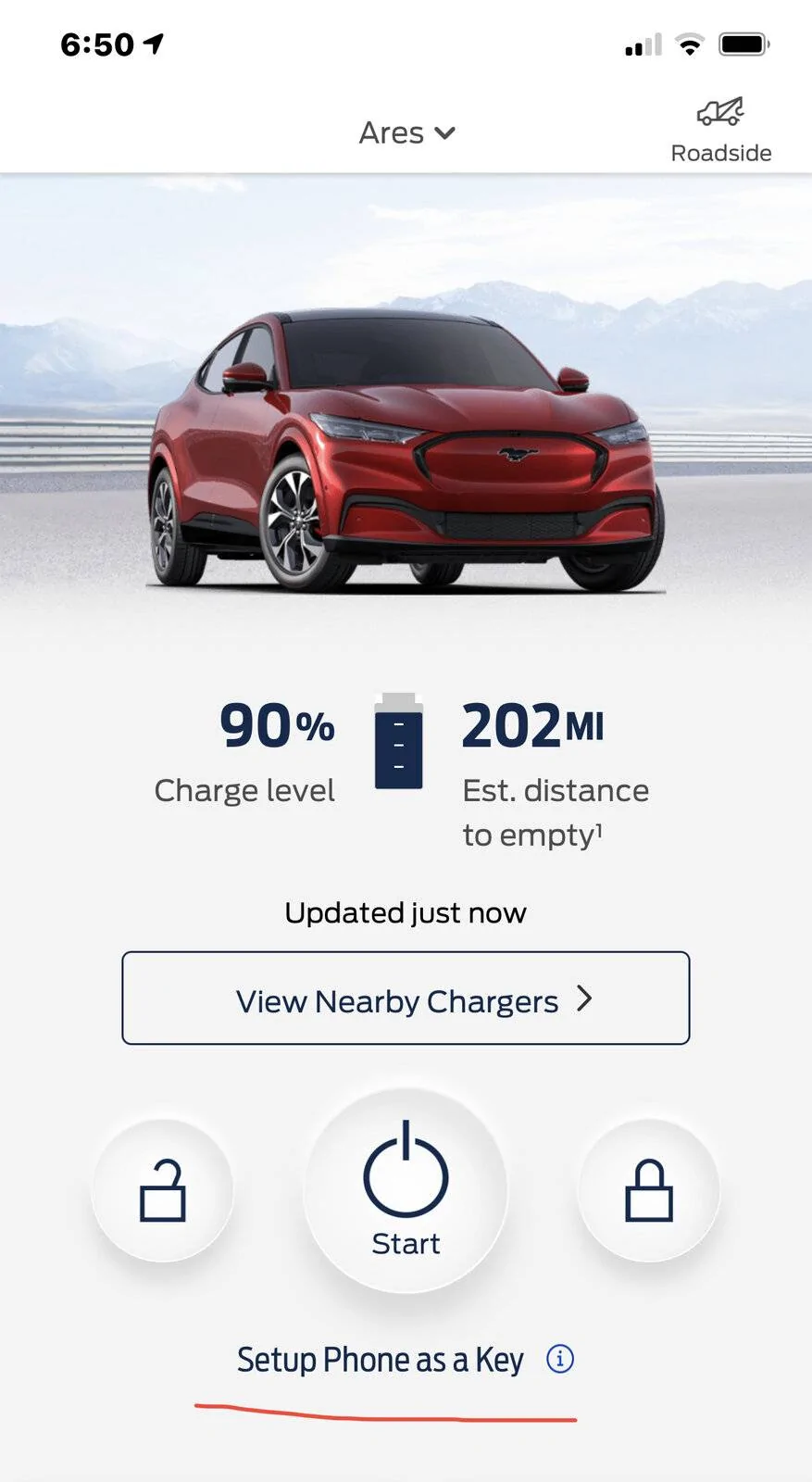

Well, sounds like you could use a little humor at this point.... ?
Ford Mustang Mach-E Can't set up phone as a key PAAK
