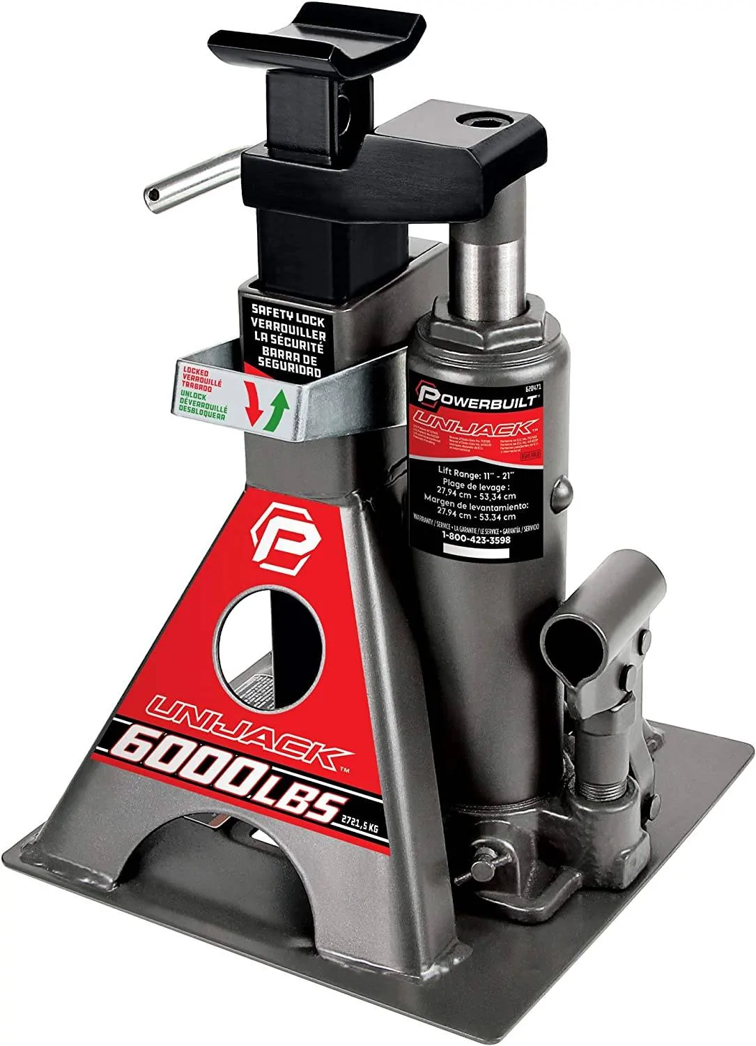

A cheaper alternative for anyone looking is the bottle jacks with built in jack stands. At their pricepoint, you could buy 2 for the price of one RennStand.
I would 100% much rather have this. I've never heard of this brand. Is it a reliable manufacturer?
EDIT: This particular product would not work. The minimum clearance is 11", and I believe the Mach-E would need something closer to 7-8".

The RennStand also requires a min of 11.5"
But for me, I like to drive up ramps first before jacking up heavy vehicles in my driveway. Then the jack only really has to lift a few inches, less chance of shifting while lifting. I did this with my Jeep whenever I needed to do front end work.
Different numbers and designs here.
The bottle jack w/ stand you linked cannot accommodate anything lower than 11".
The Rennstand comes apart, so the minimum height accommodated is the top of the Rennstand, plus your minimum floor jack height. In order for the Rennstand to become assembled after jacking, you need to have it at least 11.5" off the ground.

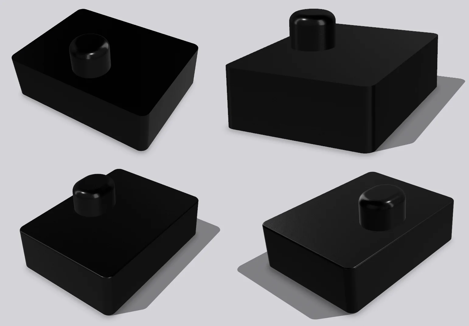

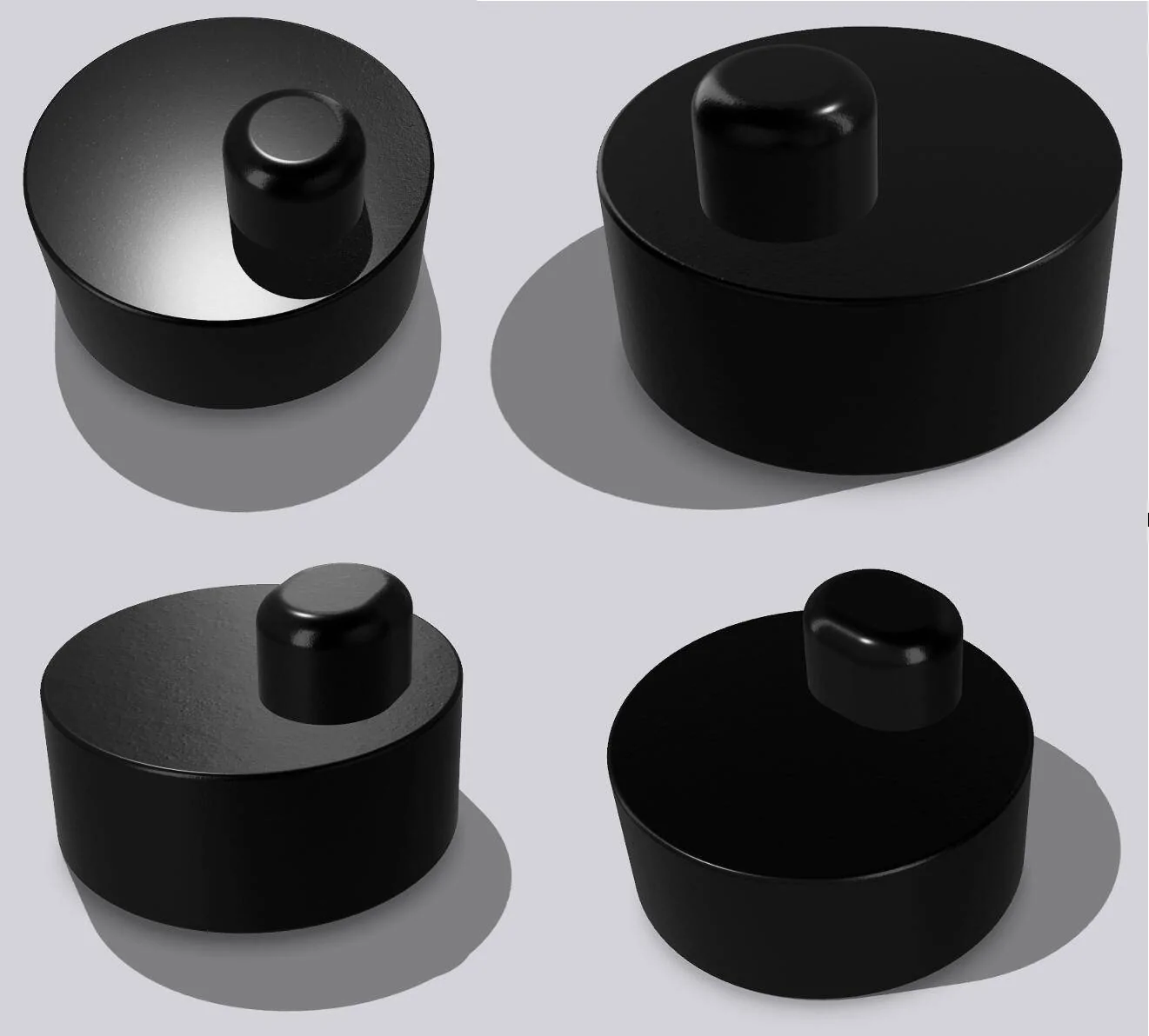

With the few mods I've performed requiring the Mach-E to be lifted off the ground, I tried out a few of the universal or Tesla-specific jacking pads which didn't work out to my liking. I've set out to design and produce something specific for the Mach-E.
Of the two designs below, please submit your preference in the poll.
I also welcome you to provide feedback and changes to the designs.
Option #1 - Round

Option #2 - Rectangular
Are you going to offer these round pucks to forum members like in a group buy? Not looking for a discount though.
