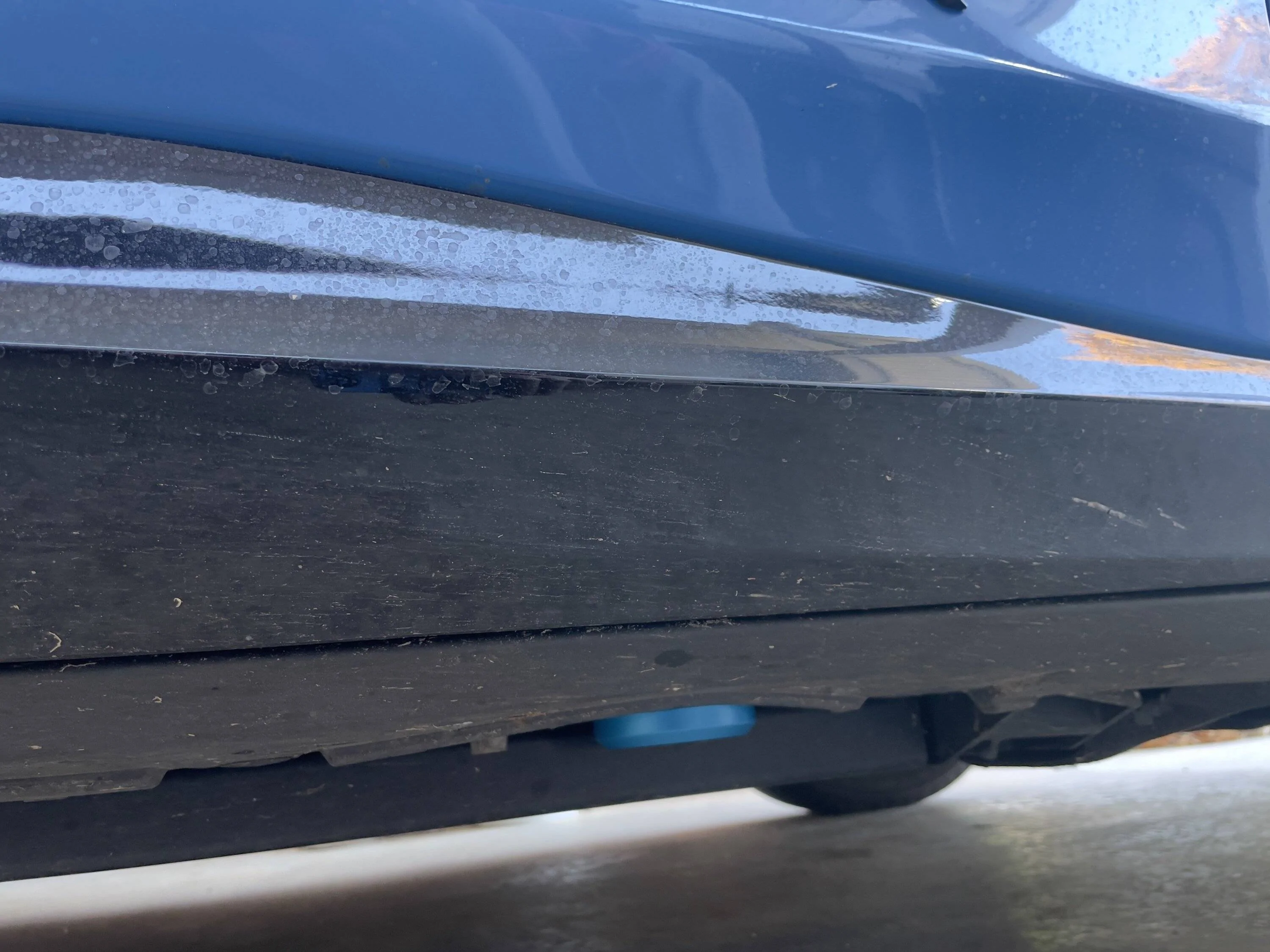

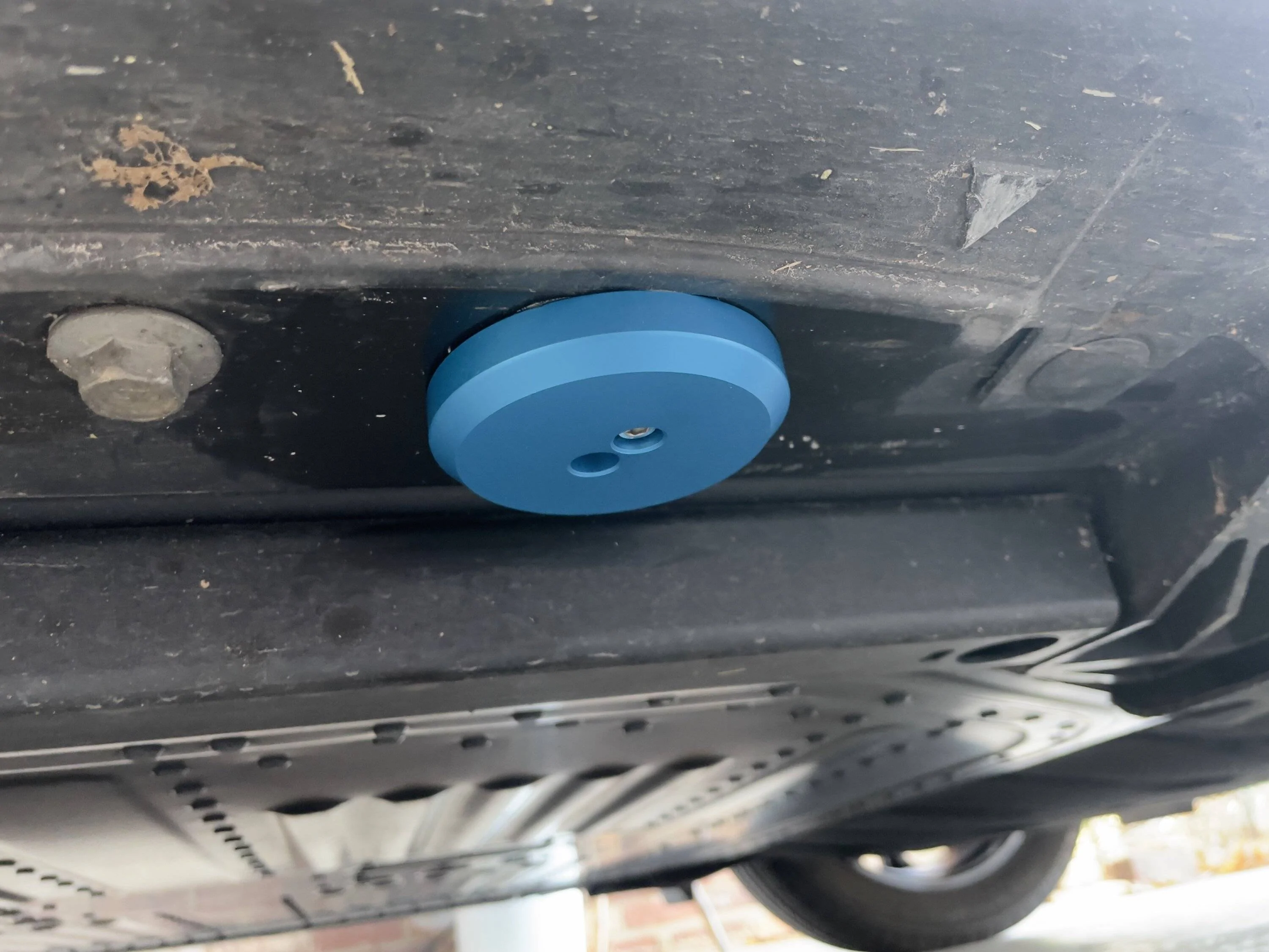

I actually just installed aluminum jack pads meant for a corvette that I saw another member post. The blue matches my MME ?
Wasn't a fan of modifying the rubber Tesla jack pads (cutting it) and leaving them hanging in there with friction alone.
Only used 1 bolt instead of 2, so I could center the puck better. But used 3M automotive trim tape on the puck as well.

I just installed, didn’t take long, I got nervous when I was trying to tighten it and it just kept spinning but was finally able to get it to grip.
hope they never have to come off. The backing will just keep sliding around in the tube and be annoying.
502
14,316
28,672

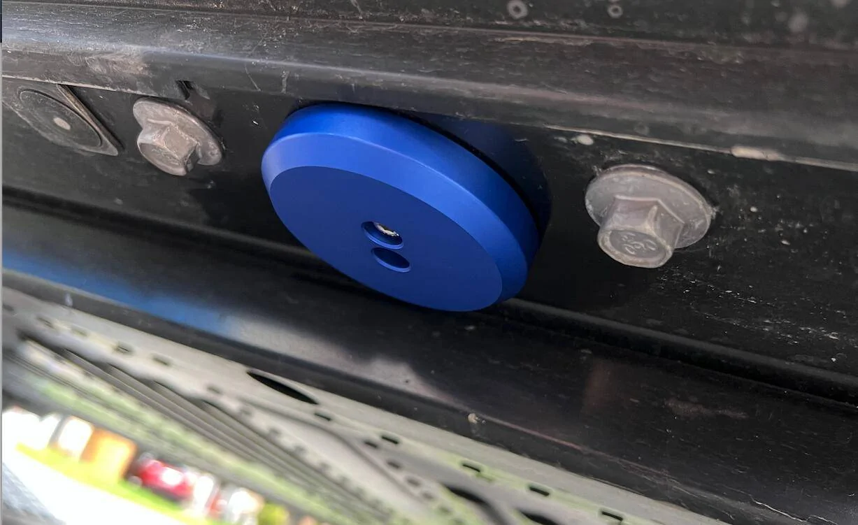

They're not a perfect match with Grabber Blue but they do nicely. I used Gorilla Tape in addition to the single screw and backing plate.
