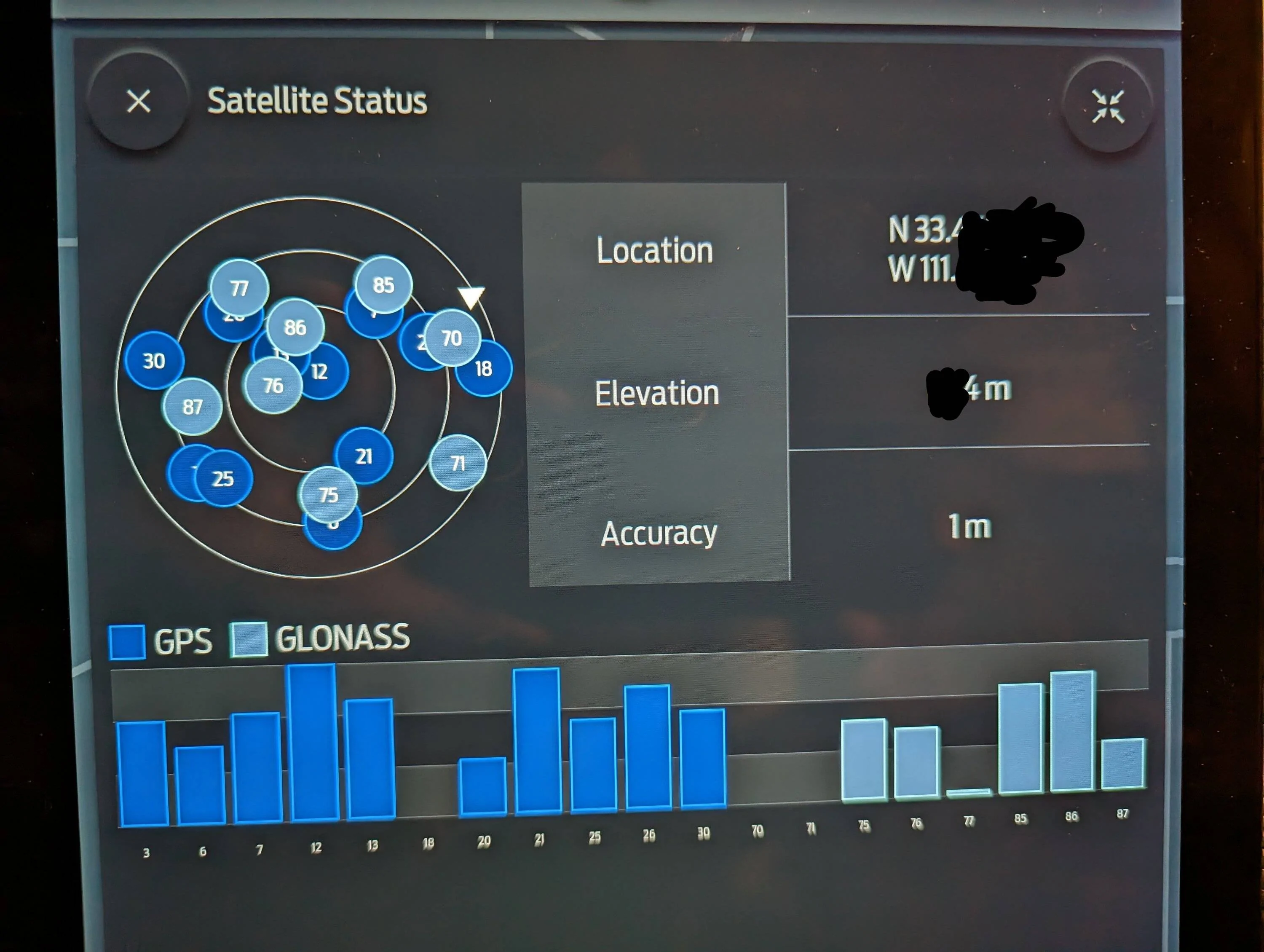

Also I forgot we can see satellite status in the regular nav app. It's very pretty! This is while inside the garage with the garage door closed:

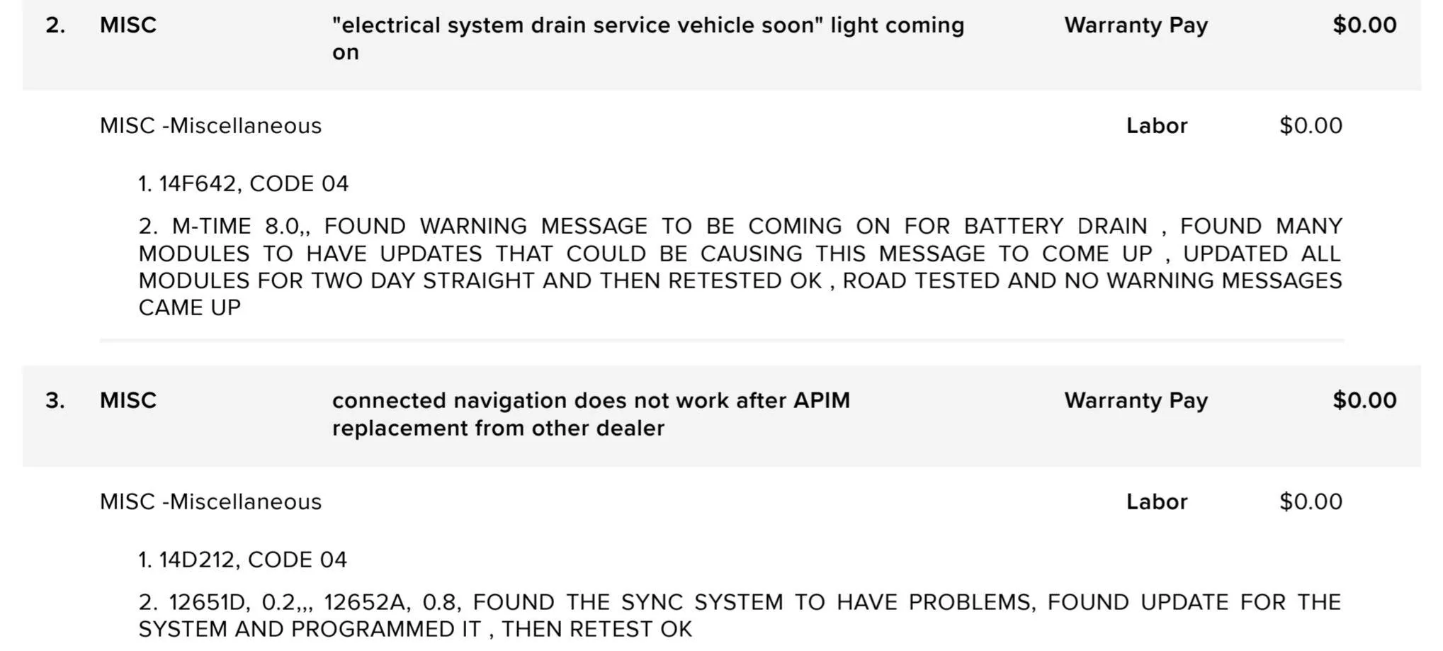

Yes, I got it resolved... On March 17, I brought the car to a different dealer (Chapman) than the one that had replaced the APIM (San Tan).
I'd started doubting San Tan would fix it. I was patiently waiting for Ford itself (EAP, connected services team, etc) to fix it since the whole debacle was their fault. They went silent on me, sadly. I finally stopped waiting, because I started seeing electrical system drain warnings on the instrument cluster.
Here are the repair invoice details:

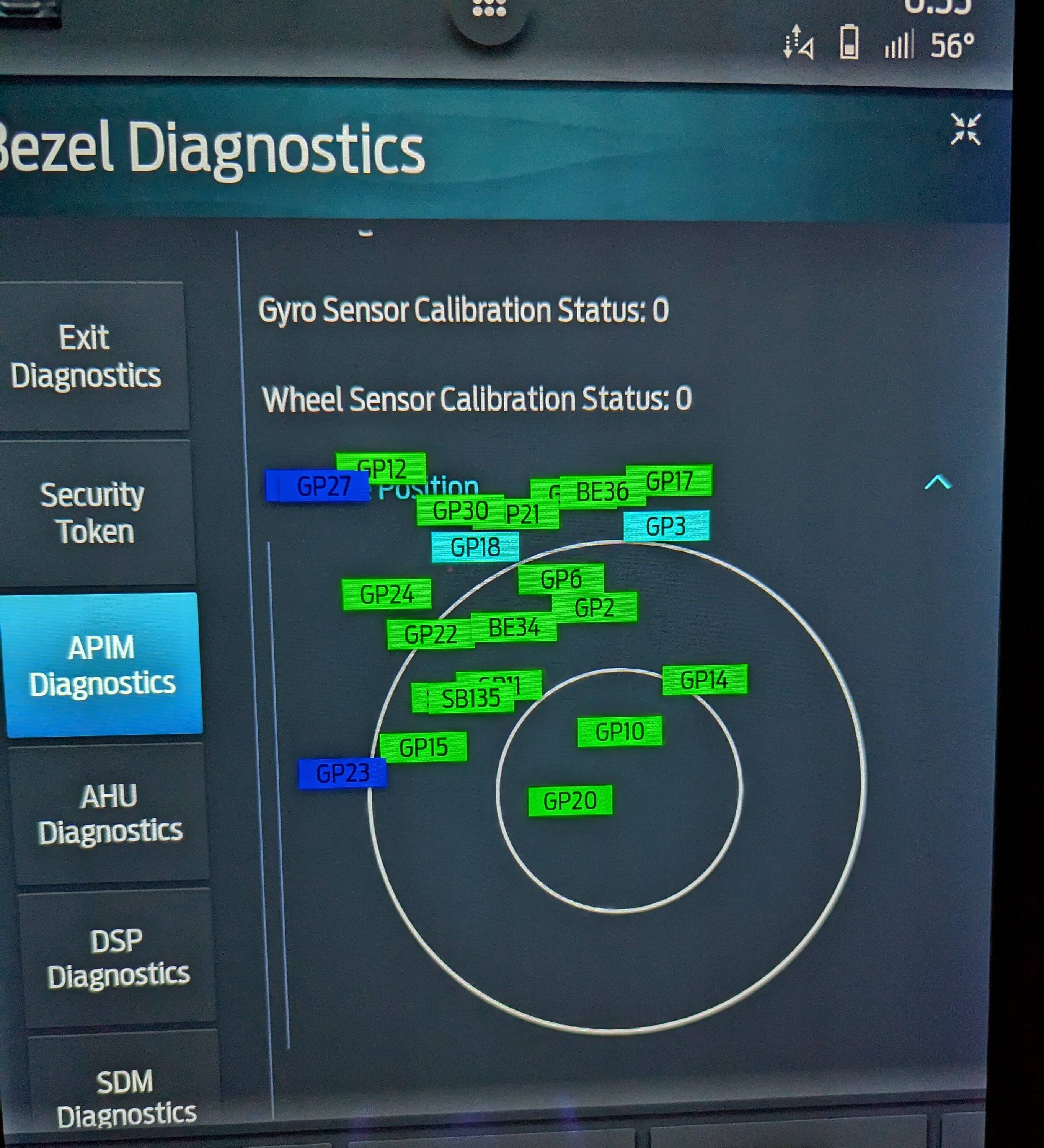

Android Auto hasn't been able to get GPS from the car since I did the master reset... It's relying on dead reckoning and the phone's antenna whose SNR is too weak while the phone is in the center cubby. But if I put it in the dash it will eventually get lock. AA is a weird experience when it doesn't have a good location.
I'm seeing that the car seems to have trouble getting good gps too... But mostly it's great so it's confusing me. And it shows 28 birds locked in on the diagnostics screen, so I dunno what's up there. Seems like more software gremlins. :(

So basically what the first dealer tech should have done was just update everything, and you would have been fine after that?
Not sure. A few months had gone by since that visit. Various modules got new updates in FDRS and PTS. So I can't know for sure.
I will say though that Ford (corporate) assured me that everything was set up properly and that connected nav should be working so they were stumped, yet they have access to the vehicle's diagnostics. They can see what modules have further updates, but they didn't suspect that as a problem.

Darn, so it seems the fix was probably just incidental by dealership doing the SYNC update. I was hoping it would be something more concrete like programming the right region into the APIM or something.
