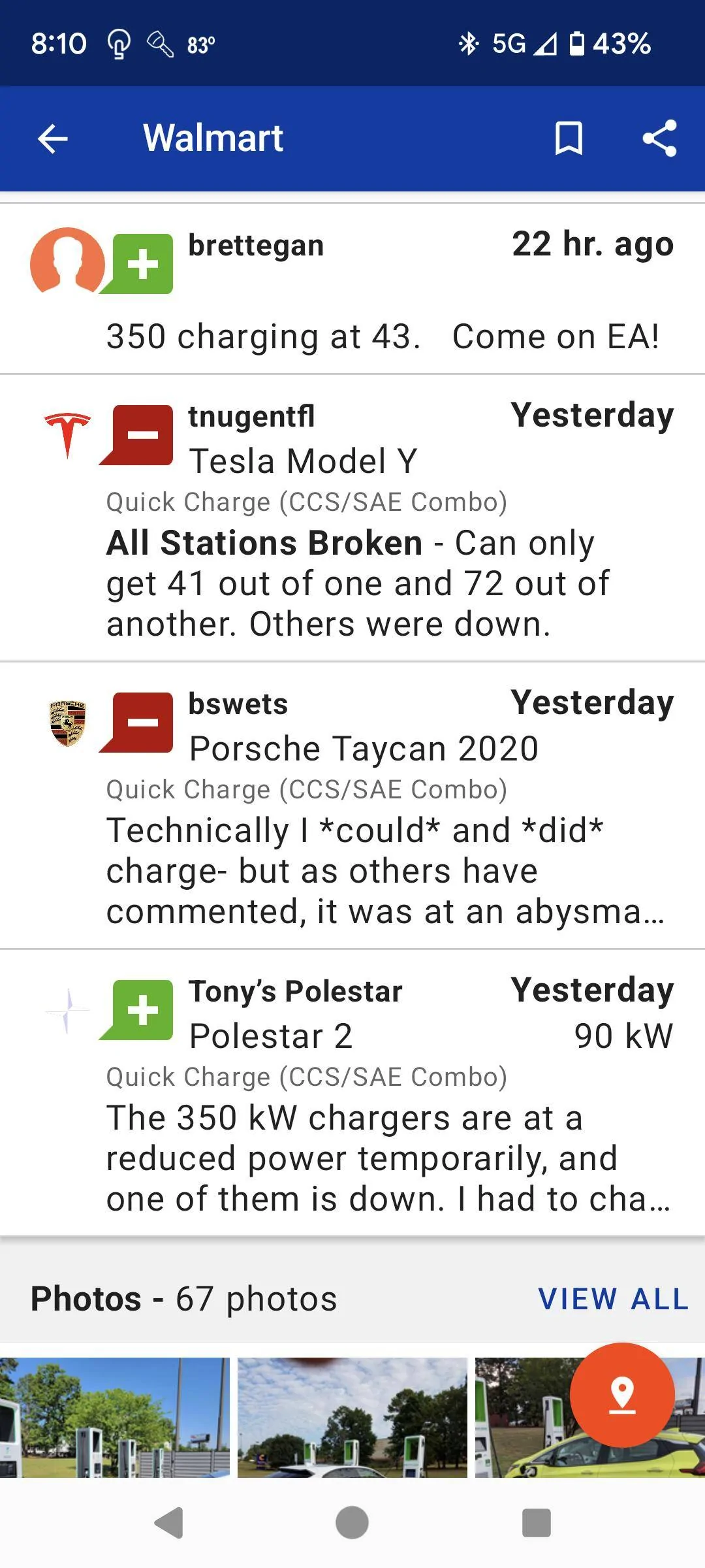

Which location are you at? The Columbia SC location is derated. The notes in PlugShare are full of slow charging comments.
267
17,939
27,948
You should look up every location in PlugShare before heading there. This is almost guaranteed to be a derated or broken charger.
Was using the Columbia sc charger, it's the one I almost exclusively use because it's halfway between my house and the beach. I'll try to pay more attention the next time I charge at another EA location.
Try moving to another charger. Do you have plug and charge set up in your App? It’s either a bad charger or not clean communication with your car. In my experience with EA. It’s not uncommon to have to swap to another charger
I have plug and charge set up. Does that negatively impact the charging speed?
What does derated mean exactly? Sorry I'm too lazy to look it up. I really have no choice but to use this location because it's the only fast charger in the Ford network that is in range of my home and final destination.

You might want to actually look up the chargers on PlugShare before wasting your time there, and then here... https://www.plugshare.com/location/172102
No, Plug and Charge has no impact on speed.
Ford Mustang Mach-E Possibly a dumb question regarding charging at EA Screenshot_20230630-201000
