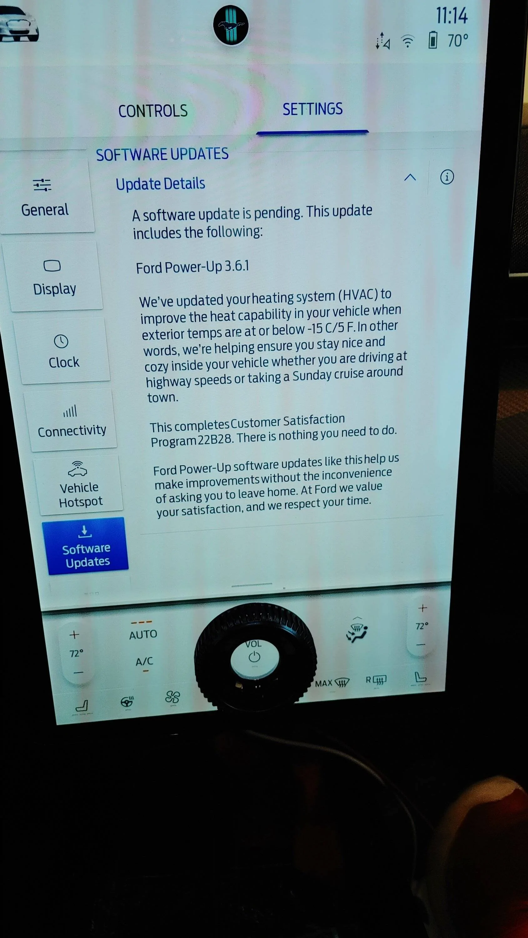

I'm hoping someone can help or point me the right direction. I've had this software update pending for months. The instructions tell how to schedule the update, but they don't match what I see on my screen. There is no option to schedule updates or allow automatic updates, like I swear I've seen before and the instructions advise me to use. Any advice or help would be greatly appreciated.

That probably means you didn’t receive the 3.5.3 APIM update last fall that added update scheduling. There was some glitch that caused some cars not to get all the 3.5 updates pushed. Your dealer will have to manually apply an APIM update that adds scheduling functionality.

Ask on here too to get your VIN checked. Your PCM most likely needs updating. Otherwise nothing much you can do yourself. A visit to the dealer is needed.

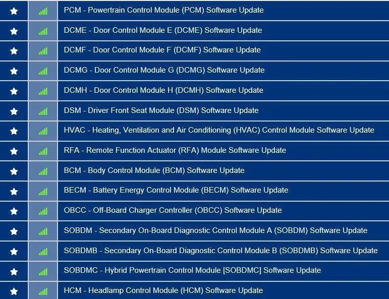

Here is what is available for your car.
I m in a similar situation to BrandonK. My 2021 lost Lane Keep Assist months ago. My dealer insists the software is up to date, yet the car fails to indicate it’s current software version. I suspect if failed to install an update. My VIN is
3FMTK3SU5MMA27394. I’d really appreciate someone checking it. Thanks!

What is the website that you used to get that data. That way we can get our own.
11,383
25,075
It's not free or public. Best to post on the "Look up" topic above or PM one of us with a subscription.
