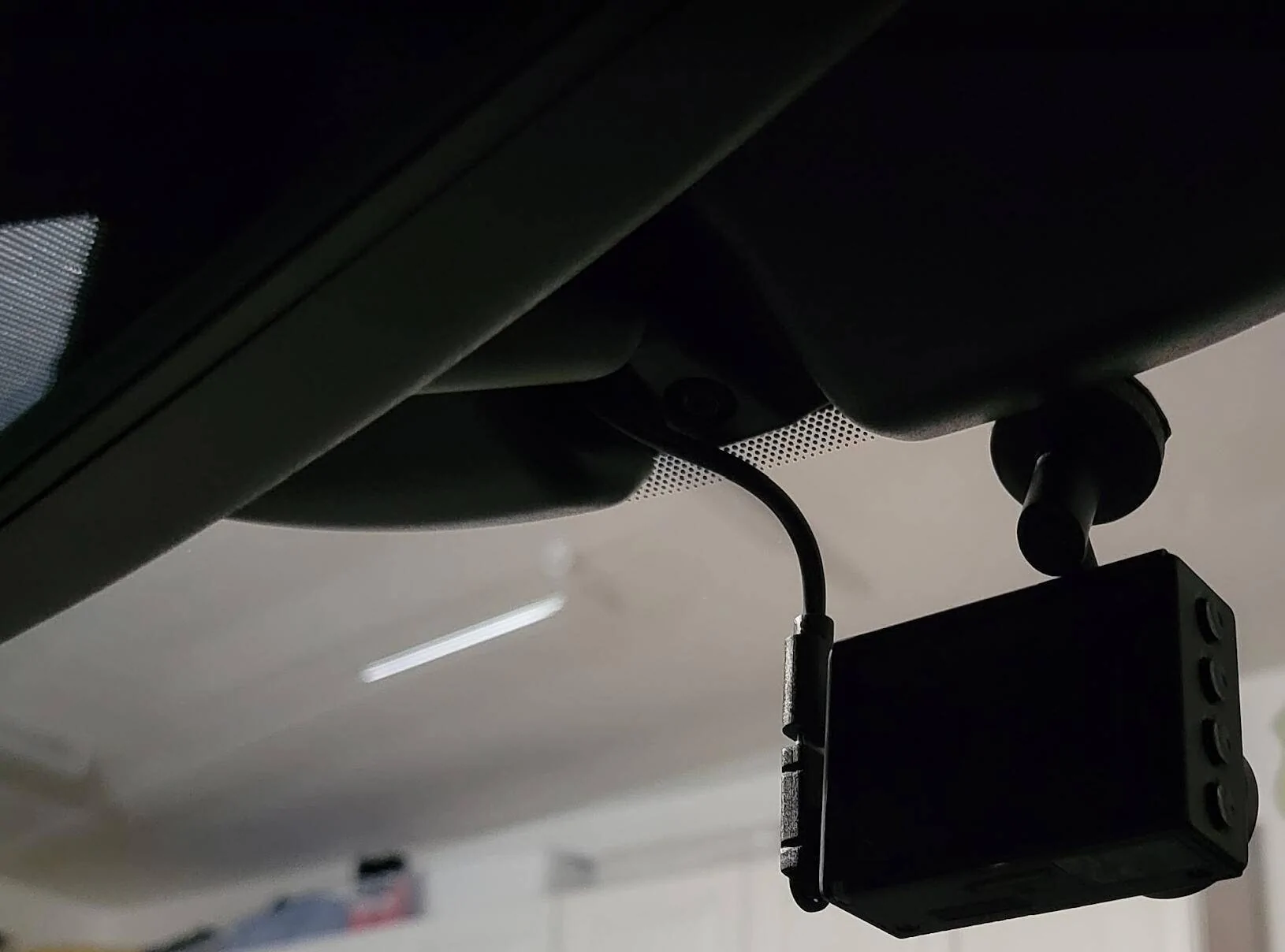

One more thing. I wanted a GPS capable camera. Fitcamx doesn’t have that. I’m using a 70mai right now.
Looking at the 70mai right now, seems to be a good bang for the buck option.

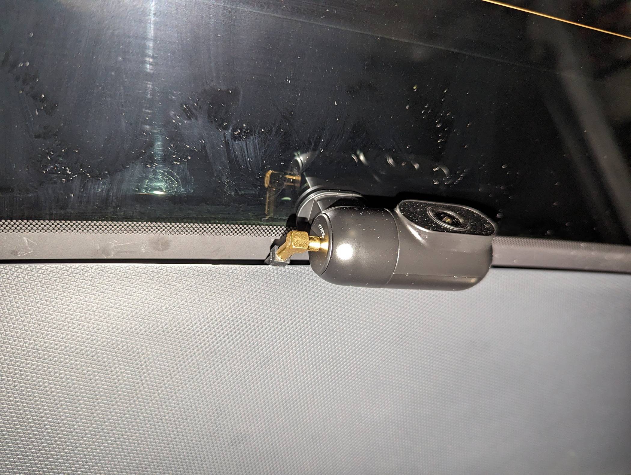

I have had great success with VIOFO A229 PRO Dual.
The rear camera just uses a single cable which I ran completely inside the ceiling liner (unlike most how-to's in these forums that run it lower with B pillar hell). I added the 90 degree adapter to make the wire a touch neater:

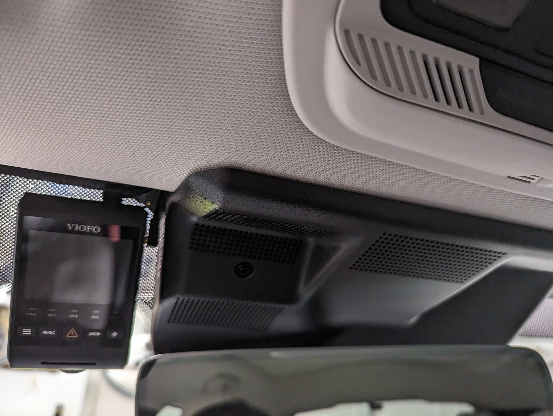

The front is pretty tidy too as there is minimal visible wiring:
Ford Mustang Mach-E Powering a Rear Dash Cam (cleanly)? 144e012f-1935-44a0-94aa-9f797f8714c5-1_all_16218
Neato, you can also see the rear camera in the rearview mirror at the top of the rear window in this photo as well.
I have it powered from the fuse panel behind the glove box with VIOFO's little device to cut power if the 12VDC bus drops below 12.4V. It has never ever caused my battery to excessively drain.

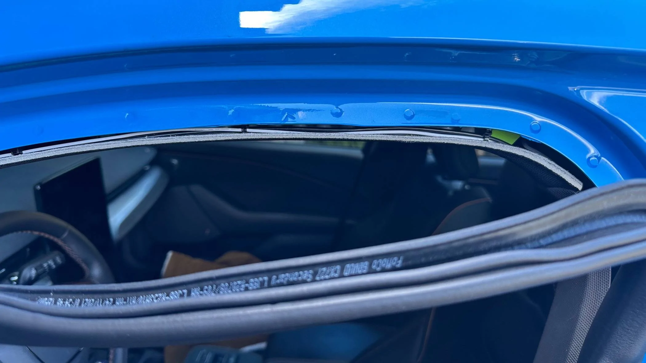

Not sure why everyone goes behind the A pillar while behind the weather stripping is the easiest and safest way. No interference with airbag? And no need to remove hard plastic that can get scratched and break clips.
Because the weatherstripping is a part that sees movement it subjects any wiring that is run behind it to chafing as the doors are opened or closed or when the body flexes. I chose to run my wiring along factory wiring routes, securing my wiring to the factory cleats or wire ways to prevent that. ?‍♂?
