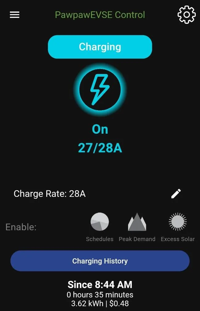

It's NOT cold here, compared to you Fargo frigid folks, but we are experiencing 30's the previous few nights. So I finally had the opportunity to witness the affects of a cold battery on an EV, and it was interesting.
Anyways, for the last 3 mornings I have used the Departure Time feature and the car consistently pulls 27 Amps on the Emporium. And the battery is right at 60F (Highest temp pid) at departure.
Range/efficiency at that temp is still a little bit less than normal, but negligible for my daily commute.
I really enjoy the car's welcoming interior though, the most. :)
Note: the Mach-E started drawing power from the EVSE at 8:44 for a 9:30 departure time. I'm curious what parameters determine that?
It decides when to start based on how cold the battery is. The colder the battery, the sooner it will start.
Why do you have it set to only 28 amps? That's odd.
