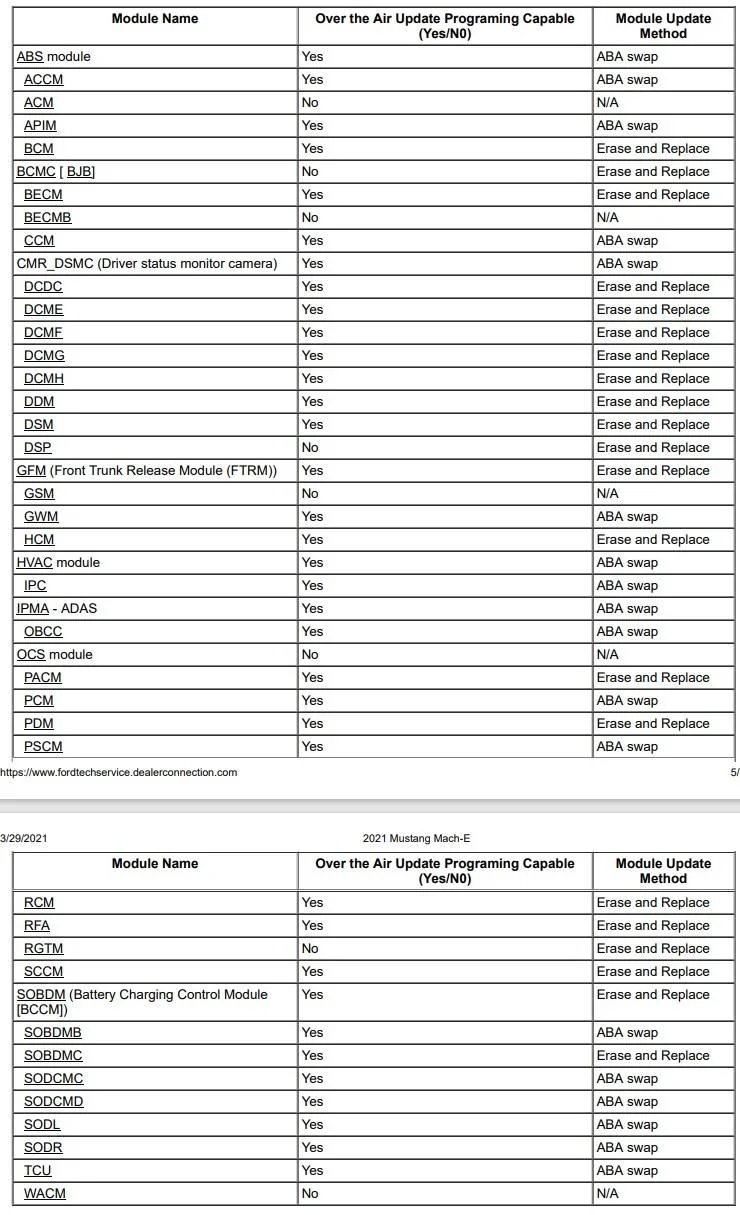

Apparently, it is.
Good to know. I usually refer to this post to see what can be OTA updated and how.
Out of the 44 possible modules in the vehicle (depends on trim/options) 37 are able to be updated over the air. Here is the list:
Ford Mustang Mach-E Priority Update 23-PU0110-RAD-PS just dropped mme-module-list-ota-jpg
The modules that cannot be updated are the ACM (Audio Control Module)

Good to know. I usually refers to this post to see what can be OTA updated and how.
What is interesting is this chart (directly from Ford) says no but obviously it is because it updated on my car last night. I'm going to see if they have revised this list...
