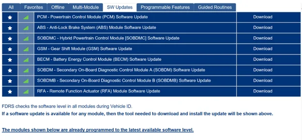

I have been testing this week and this problem is resolved for me. I took my car to the dealer and they did all the software module updates. Since then, the profile has not defaulted to Guest a single time, when it did it almost every time previously. So this appears to be a software issue that has been fixed if you can get your dealer to update your car.
Update: you will see in subsequent posts, my profile issue has not been resolved. I thought it had, but I did not wait long enough before making that determination. Maybe it is a little less frequent, but really I think it is the same. So wishful thinking was not enough. Sorry.
Do you know what modules are available for a GT? Any details listed on your service receipt?

This is the list Todd gave me and what I left with the dealer as reference. Todd confirmed they made all the updates.
They did not give me a receipt. I asked for one but they were having computer problems and said they would email it to me. Still waiting...
