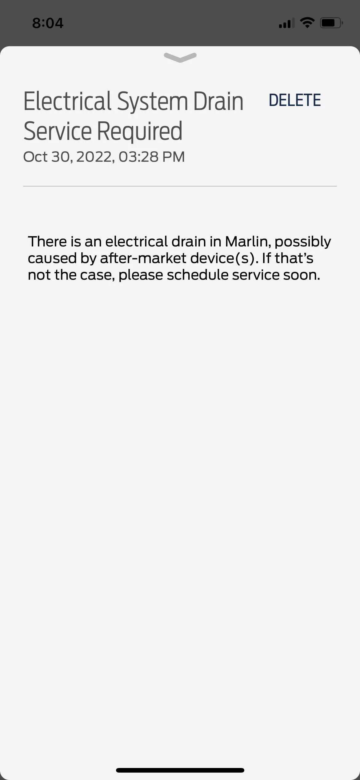

One other insight: these uncontrolled accesses of the vehicle's information can cause battery drain. Some here have reported dead LVBs that are probably driven by this. I have been receiving these warnings for the last few weeks (since a few weeks after signing up with Recurrent):
Ford Mustang Mach-E PSA: Unauthorized API use can disable your FordPass account IMG_6106
Hopefully that power drain issue will go away now as well.

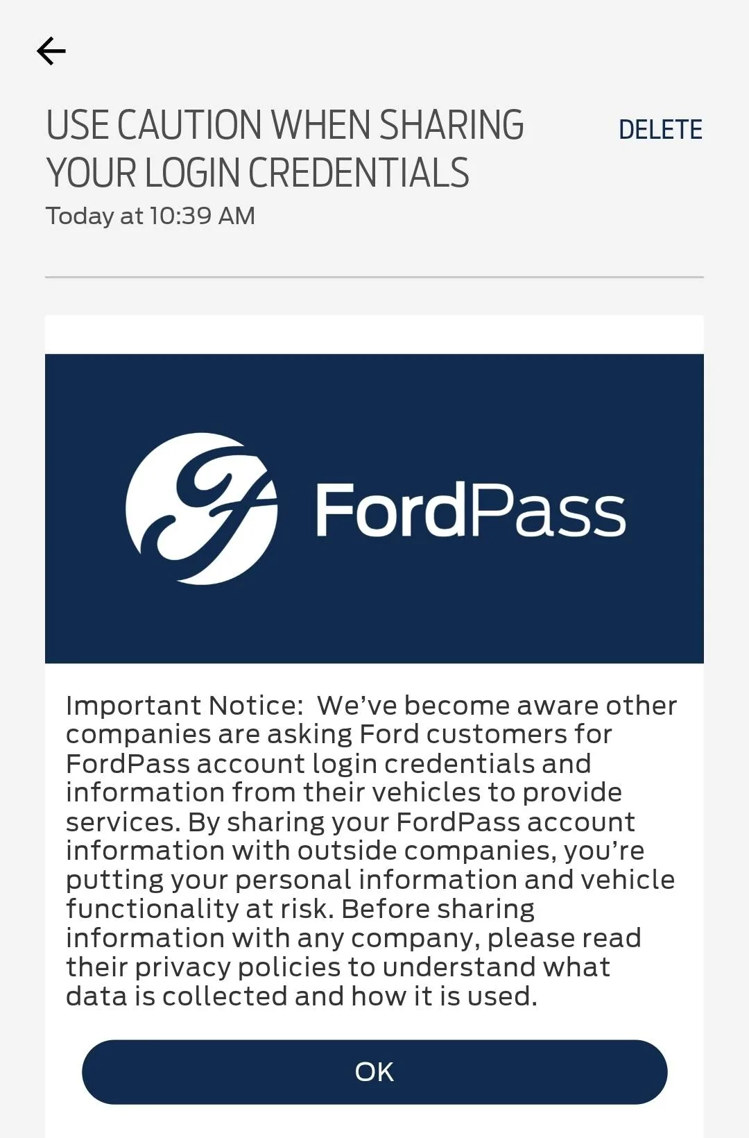

This was posted in another thread in August and deserves repeating:
Use Caution When Sharing Your Login Credentials
Important Notice: We’ve become aware other companies are asking Ford customers for FordPass account login credentials and information from their vehicles to provide services. By sharing your FordPass account information with outside companies, you’re putting your personal information and vehicle functionality at risk. Before sharing information with any company, please read their privacy policies to understand what data is collected and how it is used.
Ford Mustang Mach-E PSA: Unauthorized API use can disable your FordPass account Sharing of Ford Credentials
