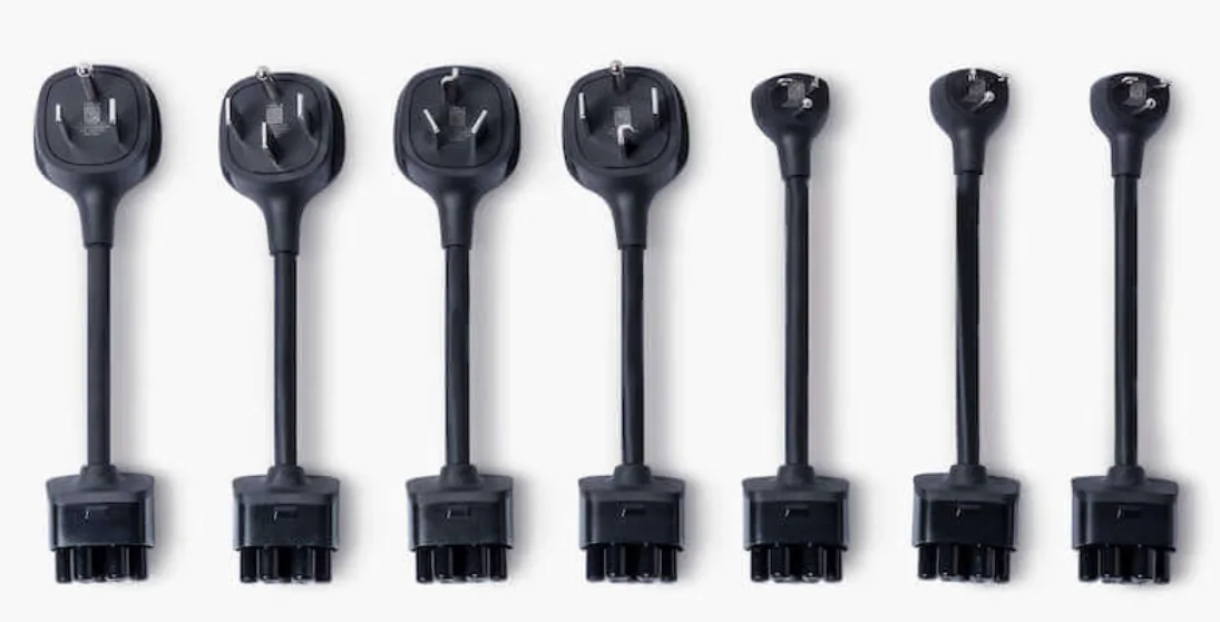

That will work as long as the wall charger isn't expecting to use the Neutral for anything while its 14-50 pigtail is connected.
Which it probably won't. But we don't know for sure.
Agreed, cheapest option to try first. I would first check to see if the box even has a white wire in it and maybe it's just not used. Just shut the breaker and take a look at the inside of the outlet box. Also I assume the outlet is for a current dryer and still need to operate. However with that said the adapter should work for the Ford 240V charger and many others.
