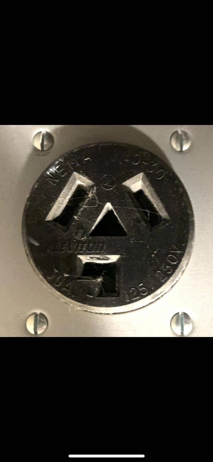

I currently have this 240V outlet for my dryer. As you can see the prongs are angled differently then the standard 3 prongs. What can i do in this case ? is it as easy as replacing the dryer receptacle? sorry for being a rookie, my first ev and not an electrician
If you don't want to do any electrical work, you can buy a juice Box charger, and an adapter they sell for 10-30 outlet.

I recommend hiring an electrician to install a 50 amp circuit with a "NEMA 14-50R" receptacle. This is what is required for Ford's mobile charger EVSE.
Your current receptacle appears to be a "NEMA 10-30R," which is 30A instead of 50 (the mobile charger requires either a 40 or 50 amp circuit).
Your current circuit may be lacking a ground connection (10-30 doesn't have a ground pin). A ground connection is required and the good chargers will try to verify that it is present.

30A outlets can only safely charge at a continuous current of 24A. Unfortunately, the Mach-E mobile charger runs at 32A, so you will be tripping your breaker and/or risking a fire trying to charge without a <=24A EVSE. If you don't have access to another outlet on a 40 or 50A breaker with an appropriately beefy wire gauge, your best bet is to stick with L1 charging on 120V, or to buy a L2 charger which runs, or can be configured to run, at 24A or lower.
Check with your utility. You may be able to get a smart charger (CP Homeflex, Juicebox, etc) for more or less free. These are more expensive than their 'dumb' counterparts, but come with some nice features and generally allow for configuring specific charge speeds so you can upgrade to a 50-60A circuit some time in the future without buying a new charger. On the other hand, a 'dumb' 24A charger is portable, and may open some doors for you on road trips at destinations with 30A outlets (clothes dryers, many RV hookups), but not a 50A outlet (electric ranges, welders, fancier RV hookups).
Go with what makes sense for you. Ultimately, L2 is going to be "overnight speed" whether you're charging at 24A/5.76kW or 48A/11.52kW (~15h vs ~7.5h 0-100%). And true 0-100% on a L2 charger is probably a very rare use case at that, since you'll likely roll into your destination with at least a few kWh of charge left in the battery.

Yes, as other pointed out, that outlet is rated for only 30 A. The issue is then that the included Ford Mobile Charger will pull 32 A and is not configurable, so you cannot use an adapter like that to plug it in as it would (should) trip the circuit breaker. You can certainly use that outlet if you have no other choice and 120 V charging isn't enough for you (which it very well may be), but you'll have to buy an EVSE (charger) that lets you set the max charge current to 24 A or less. The Grizzl-e is one of those options as @Murse-In-Airy pointed out. That's also what I have. And in the future if you ever upgrade to a 50 A outlet (which requires wiring rated for 50 A, not just a new outlet) you can reconfigure the Grizzl-e.
