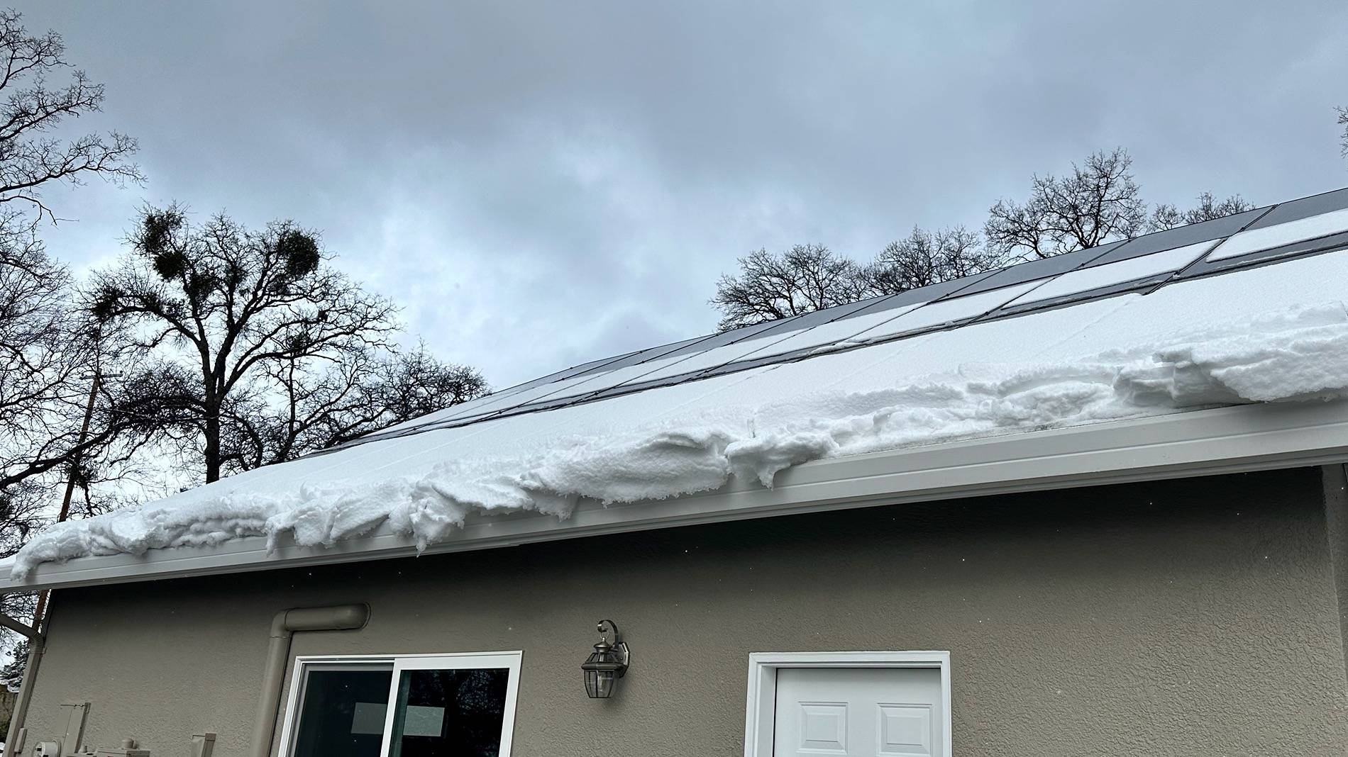

I don't know much about solar but wondered how you get the snow off the panels if they are on your roof. My roof has accumulated snow on it for weeks during some winters. It is a darker colored metal roof so probably similar to solar panels.

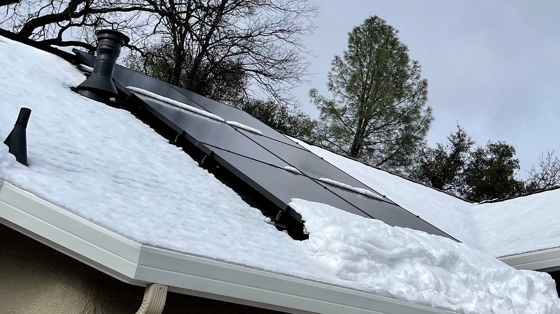

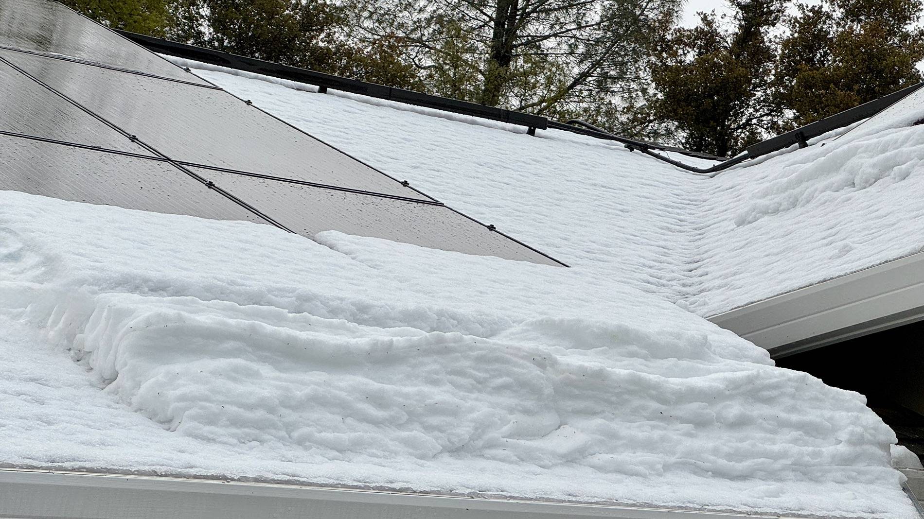

Solar panels create a little heat when they are working. Even on a cloudy day, they will produce enough to melt a light covering of snow, at least for me. We don't get much more than 6"-9" during a snowfall and as soon as it gets light (even when cloudy) they warm up enough to melt the snow which slides off of them. I'm thinking with a heavy snow fall, they might not clean themselves off but I wouldn't know.
natural melt, typically within two days the vast majority of the panels are exposed as the snow slides off
I agree with @markboris. Used to live in central Illinois so similar climate, snow and temps as Indiana. I suppose you could pull off snow with a tool like a squeeze if the sun does not melt it off. During warm weather, you could rig some type of tarp system to cover the solar panels ahead of a KNOWN snow event, then pull the tarp and snow off after the event. That is my redneck wrench-head solution. ;)
