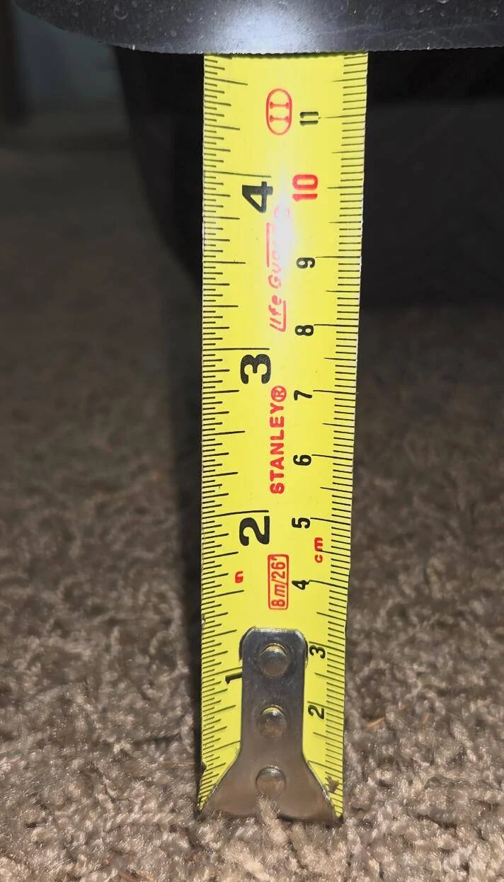

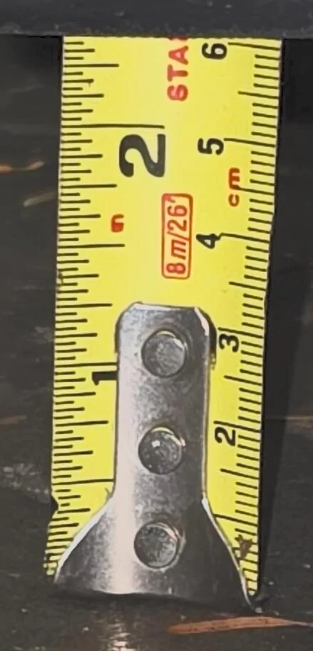

The ground clearance was good on the rear, and the width gives plenty of coverage.
The ground clearance on the front is minimal however.

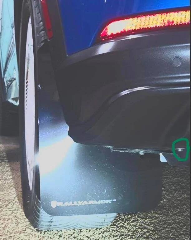

One of the mounting bolts goes in behind and underneath.
Ford Mustang Mach-E Rallyarmor mud flaps for MME Rally 1749593391825-hz
Since I did not take off the wheel, I had to use a right angle screwdiver.
The instructions say to use an icepick type tool in the inserts, I used a roofing nail instead.

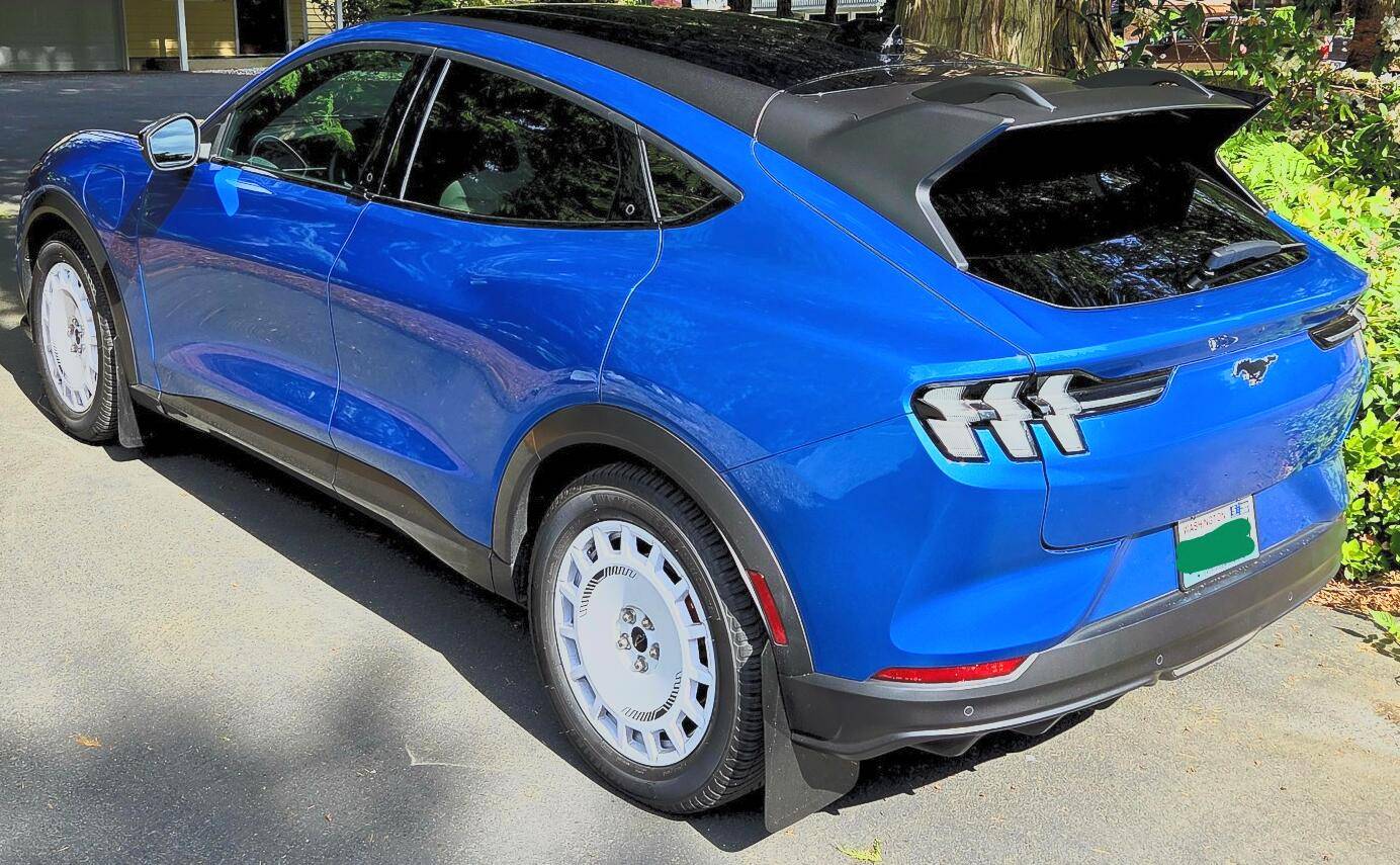

The flaps are flexible, so hopefully will stand up to impacts and snow pack.
The rear hatch seems to stay cleaner with these deflecting the spray.
Overall, I am quite happy with the looks and functionality, but I'm tempted to trim the front flats an inch shorter.
Here is another view of the flaps:
Ford Mustang Mach-E Rallyarmor mud flaps for MME Rally 1749591701872-r8

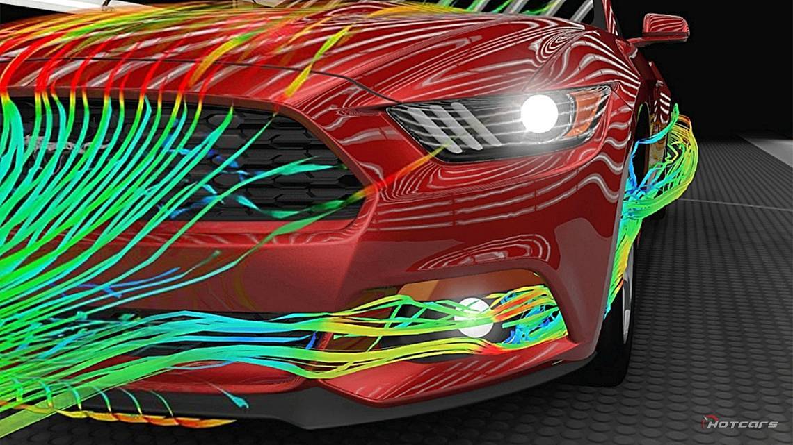

Anything that sticks out more than a 1/4" past the factory fenders will have a pronounced effect on the airflow leaving the wheel wells at higher speeds. This area is carefully shaped to control wheel wake turbulence. Even the AOSK mud flaps will cause a drag penalty. Range loss with regular splash guards will be relatively small, perhaps only 1%, but will be proportional to how much the flaps stick out to the side and under the car. Rally-style mud flaps might be as much as 5% range loss at 75 MPH. Which is probably why they're not included in the Rally package.

Since the mud flaps are already in the aerodynamic shadow of the tire, they won't cause much more range loss than the AOSK flaps. Because the gap near the lower tip of the mud flap is greater than the gap at the upper end of the mud flap, there will be extra drag but it's not as pronounced as it would be with a narrower wheel and tire setup. Your wheels (like mine) will have a much more pronounced affect on drag than the mud flaps. ??
