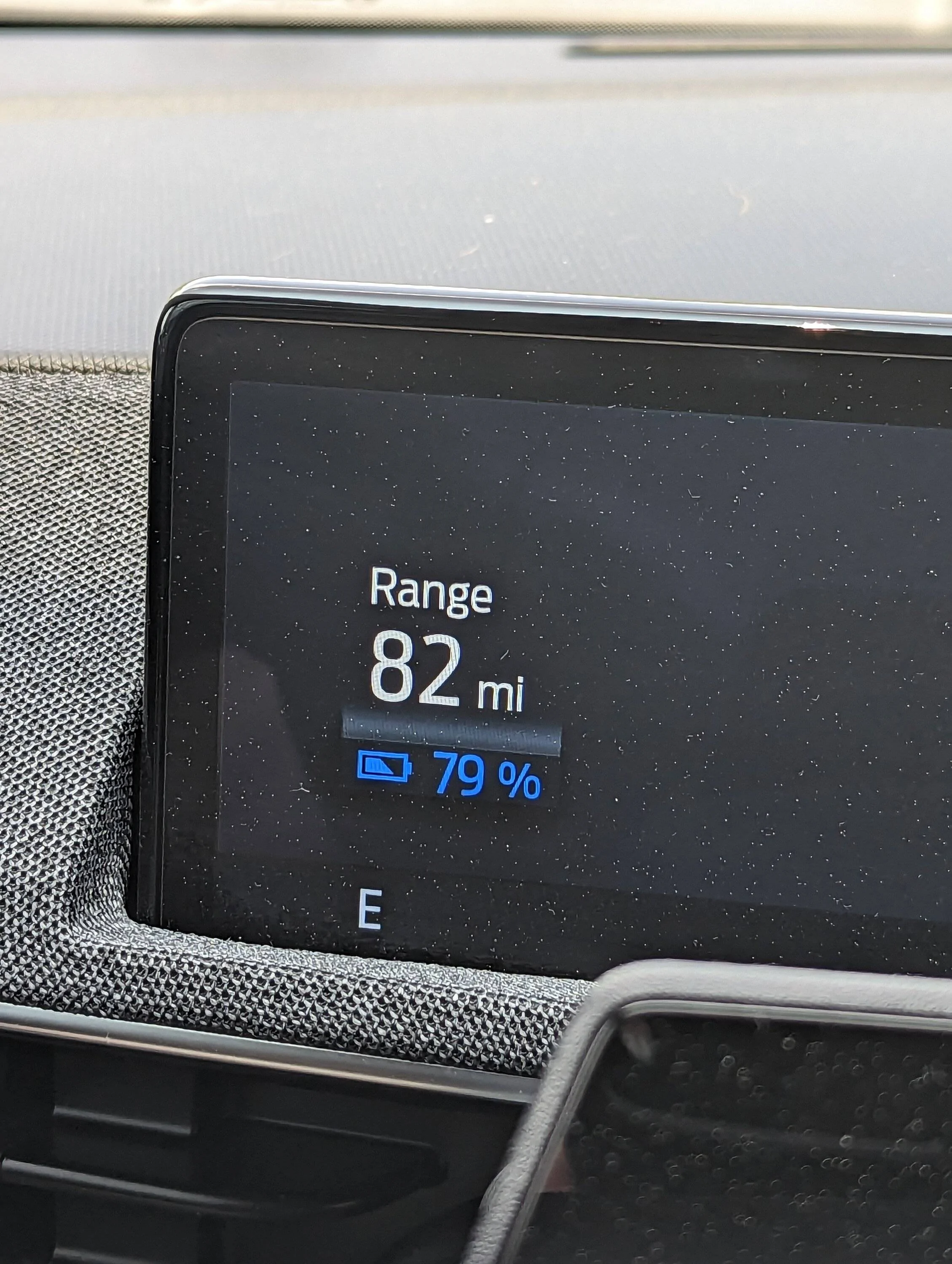

2021 SR AWD, bought at 2800 mi, now 6200 mi. I'm on my first real road trip in this car, no issues until my last DC fast charge on reaching my final destination 700 mi from home. I left home at 100% with 223 mi predicted range. Now I'm at 49% with 50 mi, and have been consistently at around 1 mi / % SoC. I left the last charge with 79%, 82 mi, pictured.
Is this a known issue where DC fast charging will throw off the range estimates or the SoC? Or is my battery pack actually damaged somehow? Do I really only have half the battery capacity that I should? Has anyone else encountered this?

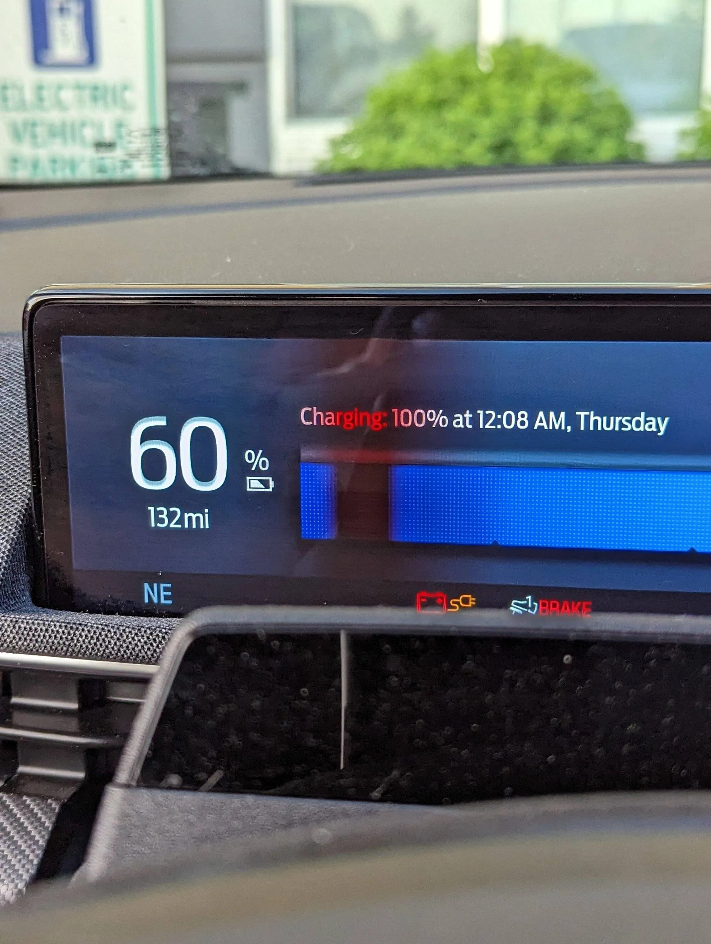

Gave that a try, results pictured. Assuming the "GOM" is calculating that range estimate based on an actual detected battery voltage level, as opposed to some sort of default, I'm guessing the issue that started yesterday was indeed a range calculation issue, and not a hardware issue.
I have about 160 mi of driving planned tomorrow - hence the 100% SoC target for tonight - I'll post an update on whether the ~225mi total range I should be getting is what I actually get.
