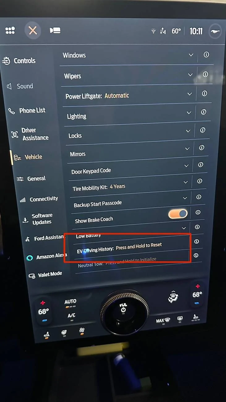

I posted a similar question in a Facebook group but I was overwhelmed with responses educating me about range (how I drive, temperatures, it's just an estimate, etc). My question is NOT about range specifically - it's about the impact of a reset on the range estimate.
So let me narrow this down to a very specific question.
If I have an Extended Range AWD Mach-E and I reset my trip history (i.e. there is no driving history) and I have an 80% charge what would you expect the range estimate to be?
To reiterate, this is not a question about how to increase range, how the number presented is just a guess or any of that. I am asking about how the car would determine the figure to display IMMEDIATELY after a reset ( therefore with no history) and with the car not having yet been driven a mile, since the reset.

Correct - I am not that "type" at all :) I am not a "range chaser" in any way, although it's been difficult to explain what I am asking here. In fact, I just had another such poster say the same thing - " Stop worrying about estimates and drive it. You're going to worry yourself to death." Sigh....:)
So, let me have another go at explaining why (and what) i am asking.
I have two new EVs. I greatly enjoy them. I understand and accept that true range (the ACTUAL distance the car might be capable of driving) is subject to many, many variables and there's no "target". These include driving habits, temperatures, terrain and no doubt many more things.
I also understand that the range DISPLAYED is merely a guess. And that guess may be "less-than-accurate".
I get all this, understand it and - for these reasons - have never worried about range too much, aside from a curiosity and a driving style that tends to get good range.
With my other car everything is as I would expect. With my pragmatic perspective, sometimes I get good range and other times it is not soo good. But it doesn't bother me, it all all makes sense and I just love driving that car and don't worry about range.
But....
With my Mach-E the range (both actual and estimate) is considerably below what I might expect. Obviously it's a different car so the NUMBERS are different (lower for the Mach-E) so i am not expecting the same. However, many of the conditions (terrain, temperatures and - to a large extent - driving patterns) are the same. But with my other car I can almost choose to get well beyond EPA figures, just by driving better. With my Mach-E it's ALWAYS far below the EPA figure*.
So, what do I do? I can shout from the rooftops about how my car sucks. But I am not that type (seriously). That's a meaningless and pointless debate.
But what I CAN do is investigate and remove as many of the variables as I can. And my thinking was that when I reset I would at least remove the driving history from the equation. My plan was to reset and then very carefully log and track numbers thereafter, to see if I actually have a problem.
But the reset number was immediately much lower than I expected (290 * 80% = 232, seeing 193 instead). So, I thought I'd ask about that.
So, before I move on to logging, scanning, etc I wanted to verify how the reset worked - how did it arrive at that figure? Some people have misinterpreted that as me stressing about range, which is not the case at all. I am merely trying to understand what resetting does.
You have made the point that ambient temperature will have a very significant impact on that INITIAL estimate. While I remain surprised that a mild temperate (near 60) can have THAT much impact, it may well be the explanation. I will look some more at this and hope that it explains this.
I hope that clarifies.

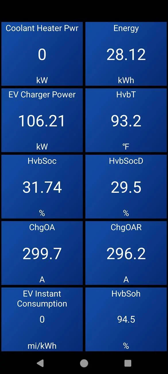

Had a Mach-E for 3.5 years, a Lightning for 1.5. Mach-E I get 2.9 at best on the highway, driving 73 to 75. BUT, in our travels, across a total of 25 states and 1 province, have I seen markedly different numbers? Yes. I use 2.7 to plan my trips in the summer, and 2.3 in the winter. Hit a headwind (20mph) and saw 2.1 in the fall a year back.
Learn your normal miles per kilowatt hour on your highway driving, take off a bit, and that's what I plan with (hence the 2.7).
I also find invaluable having CarScanner open on a long trip so I can see the ENERGY, i.e. actual available kWh. Then I can look at my current efficiency and multiply in my head and that's my range. I also have an instant m/kWh in my CarScanner window and if I'm cruising, that's of interest (but it goes up and down a lot).
On a trip on New Year's Eve, awful weather, blowing snow, we started losing efficiency and couldn't make it home. Pulled into a nearly new Pilot / Flying J station just as their nationwide network went down... Nearest charger was an exit away. Car was at 5% (found the thread, tweaked numbers) and showing like 8 miles and I needed 12. But I knew my exact available kWh left (7.7). Did the math and said "if I drive 40 or less with my hazards on, I can make it". And, I did. I arrived with 1% showing, 3.XkWh left.
