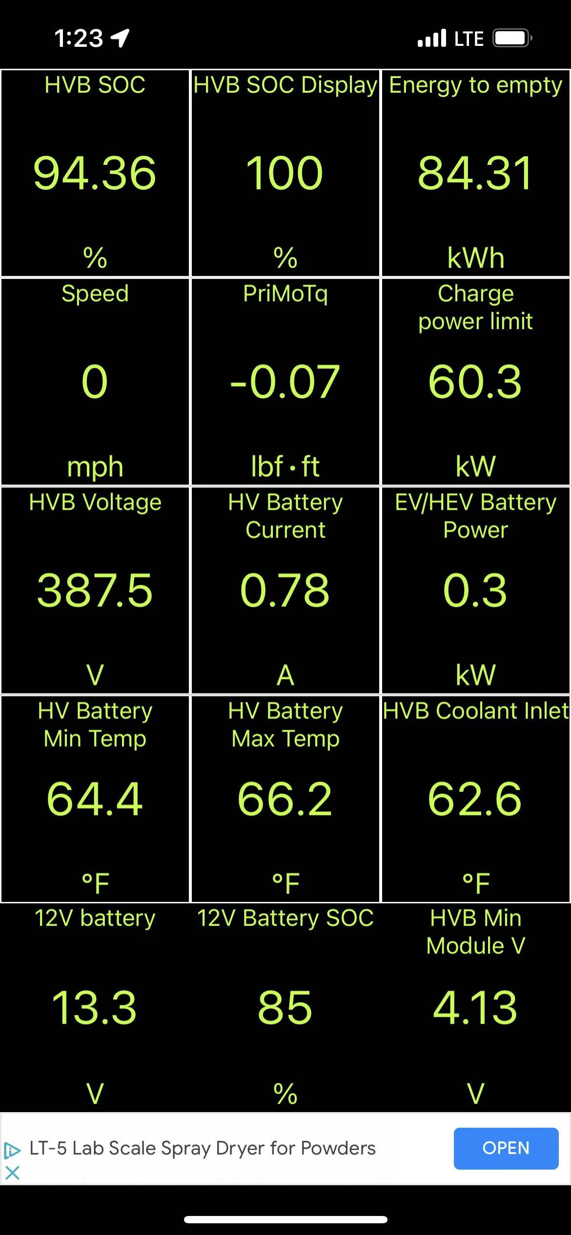

Update: today I charged my car to 100% and used an OBDII scanner to check my energy level, and it says my full capacity is only 84.3 kWh. That seems significantly too far below the 91 kWh of usable capacity advertised, right?

I found another thread where someone reported that their Extended Range Mach-E has 88.5 kWh of capacity. That's arguably pretty close to 91 kWh, but since mine is 7 kWh less than it's supposed to be I do think I should take it to the dealership to somehow get it fixed. Maybe one of the battery cells isn't working? :/
I also notice from the Car Scanner app that my battery's state of charge is 94% even though its state of charge display is 100%. But even dividing that out would still only be 89.3 kWh total, and since the car refuses to charge beyond its displayed 100% this supposed additional charge capacity is unusable anyway. Just felt like mentioning that though.
Too early to be concerned. Drive your car for a while. The kWh to empty starts low and then gradually increases as you repeat charge cycles. At least that is how it worked on my car.
I've only had the car for a bit over a week, so I'm hoping that, yeah, I just need to give it some more time and miles for the range estimate to get more accurate. :) I could definitely see that increasing the GOM's estimated range, but I wouldn't expect that to increase the kWh total capacity. @SnBGC, are you saying that you did some measurement like I did and found that the kWh total energy actually increased over time? I thought batteries only decreased their capacity over time. But I haven't run down the charge below 50% yet, and for some reason I do feel like doing a couple "full" cycles might somehow help something for some reason.
It is more related to average HVB temp. Your battery is still a bit cold from those readings. Wait until later in the summer and then you can expect to see higher kWh to empty calculations.
Temperature matters. Your battery is at about 20C, so 90%, roughly.
