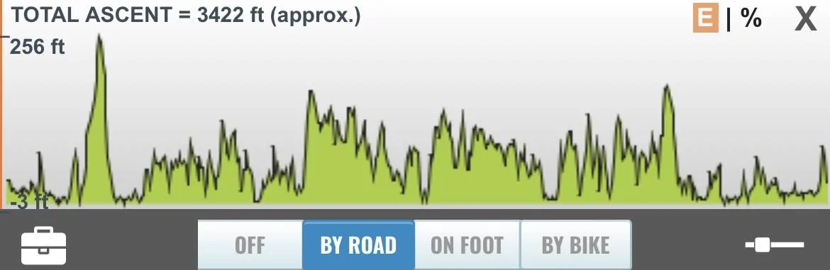

This range is due to driving 53-58. I have NEVER averaged 3.9m/kWh. If I average 3.0 I consider that a fluke.
That’s the benefit of commuting 90 miles a day on winding two lane rural roads. I see 4.1 occasionally. In 23,453 miles I’ve averaged 3.5 mi/KWh.

If I go collect the mail (1 mile away), it’s 1.2 miles per kWh. 600 foot climb. Numbers like those are for flatlanders. ;)
Haven't looked in a while on my 2021, but around 9,300 miles I was at 2.9 lifetime.

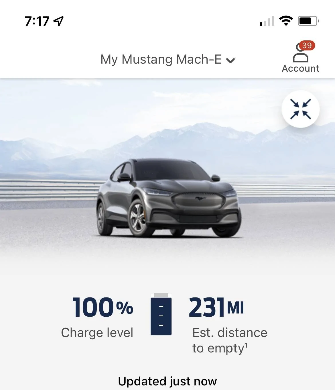

I feel like my new extended range Mach-E must have mistakenly been built with a standard range battery, and I'm hoping someone has any ideas before I go to my dealer to take a look. I don't *think* this is just another thread lamenting how weather steals range, so hear me out. :)
My extended range AWD Premium has consistently been estimating its full range in the ballpark of 220 miles. For example, it's currently at 70% charge and estimates 151 miles remaining, which works out to 216 miles of total range. I haven't been using much heat or air conditioning, and the car agrees that at most about 20% of my driving energy usage is on climate controls etc. Moreover, almost all of my energy efficiency ratings in the "My EV driving" section of the Ford app say my efficiency is between 3 and 4 mi/kWh. Multiplying out even 3 mi/kWh by a 91 kWh usable extended battery nets 273 miles, which is what I'd expect. However, the car's range estimate is always around 200-225 miles and has never been above 250 miles, whereas I've seen photos here of much higher range estimates. Can someone help me make sense of this?
It seems like the car's energy efficiency estimates are inconsistent with its total range projection. The estimates would be accurate if my car had the 70 kWh battery but don't line up with the 91 kWh battery I sure hope it has. I know new owners often complain about having too little range because they're spending their energy on heating, but I really don't think that's the case for me in this mild weather. I really want to check my battery's usable capacity, but I haven't seen any way of doing that. I hope the dealer can check that and tell me, but if I'm somehow making a silly mistake I'd like to get corrected now instead of there if possible. Any ideas how to reconcile these numbers? Thanks!
Do a test range. Drive in a loop with a 100% charged battery and make your conclusions. Forget the GOM.

It takes time. It took over 2000 miles of averaging 3.7m/kw before my range estimate reached 300 miles. It would go up 5-10miles each charge. It started at 220 new and is now consistently 300-318.
