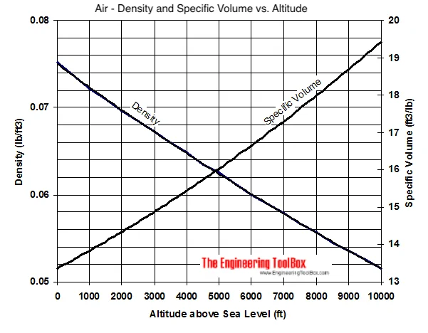

Does anyone have any idea of the percentage difference of range (extension) one might get at sea level vs 3500 ft in the Mountain states?
3500' isn't much of an "elevation". However, we drive our Mach-E over the Eisenhower tunnel in Colorado (11,158'), and whatever you lose going up, you gain going down that mountain.
In fact, electric vehicles are somewhat more efficient at higher elevations as there is less aerodynamic drag. i.e. at 10,000ft, the air density is around 68% of sea level. ICE cars lose power with altitude, electric vehicles do not, because they don't require oxygen to make power. Your average 250hp ICE car will only make 170hp at 10,000ft.
