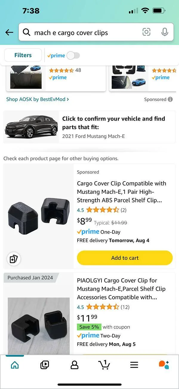

Updated… found these little gems on Amazon and they were the answer to my prayers ? 9 bucks and problem solved!!
I can confirm that these clips from Amazon work well
