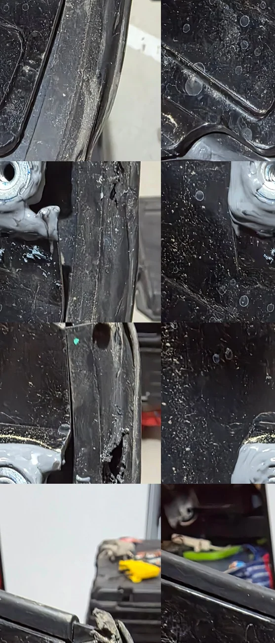

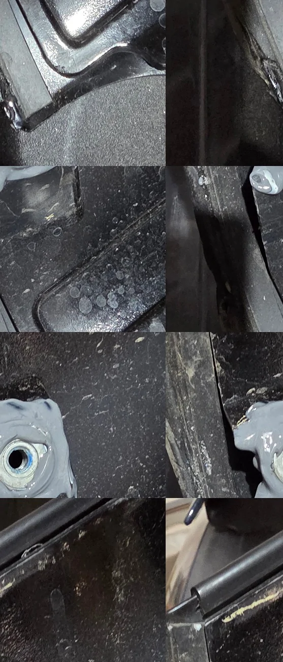

I got it off !
Thanks guys with out that tid bit of drilling a hole to hold the square nut I don't know how I would of gotten it off.
I went ahead and bought some JB weld and hit up both sides like you said.. I'm going to let it sit over night

I got it off !
Make sure you do not use Loctite when you put the bolts back in and screw them in slowly, manually.
Your photos are jumbled up because you are probably using an Android device and chrome uploading the photos.
