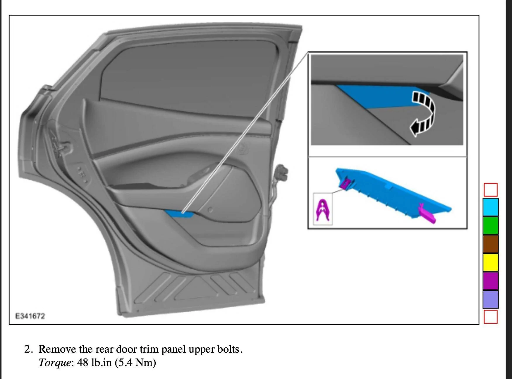

Friday (July 5th) my dealership replaced the rear drivers side window in my Mach-E. (They scratched the glass when removing the window sticker - so were replacing it.) Today (July 8th) I had someone in that back seat for the first time (since the glass was replaced) and we discovered that the door no longer opens from the inside. I can still open it from the outside. (The other rear door still works fine from the inside.)
While this is obviously the dealer's responsibility to fix, it's likely a silly thing that they just forgot to plug back in. (The rear door handles are purely electronic.)

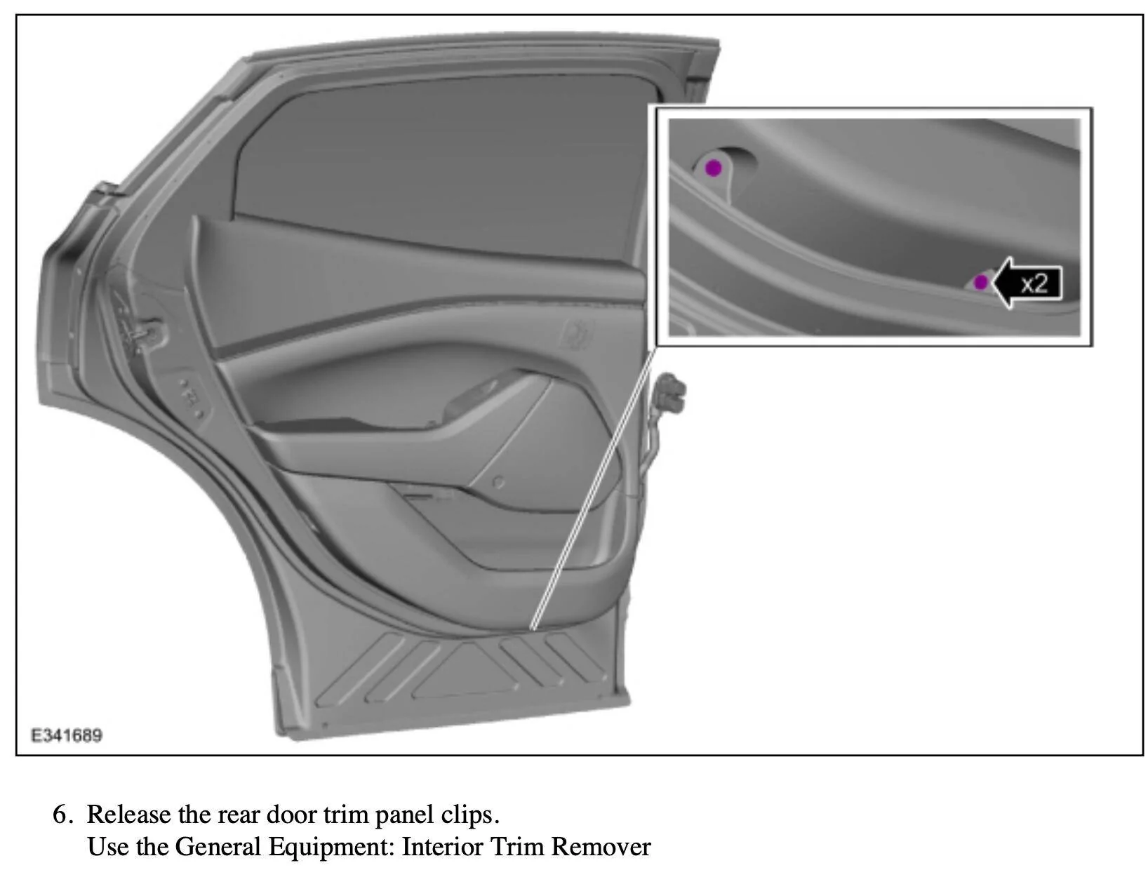

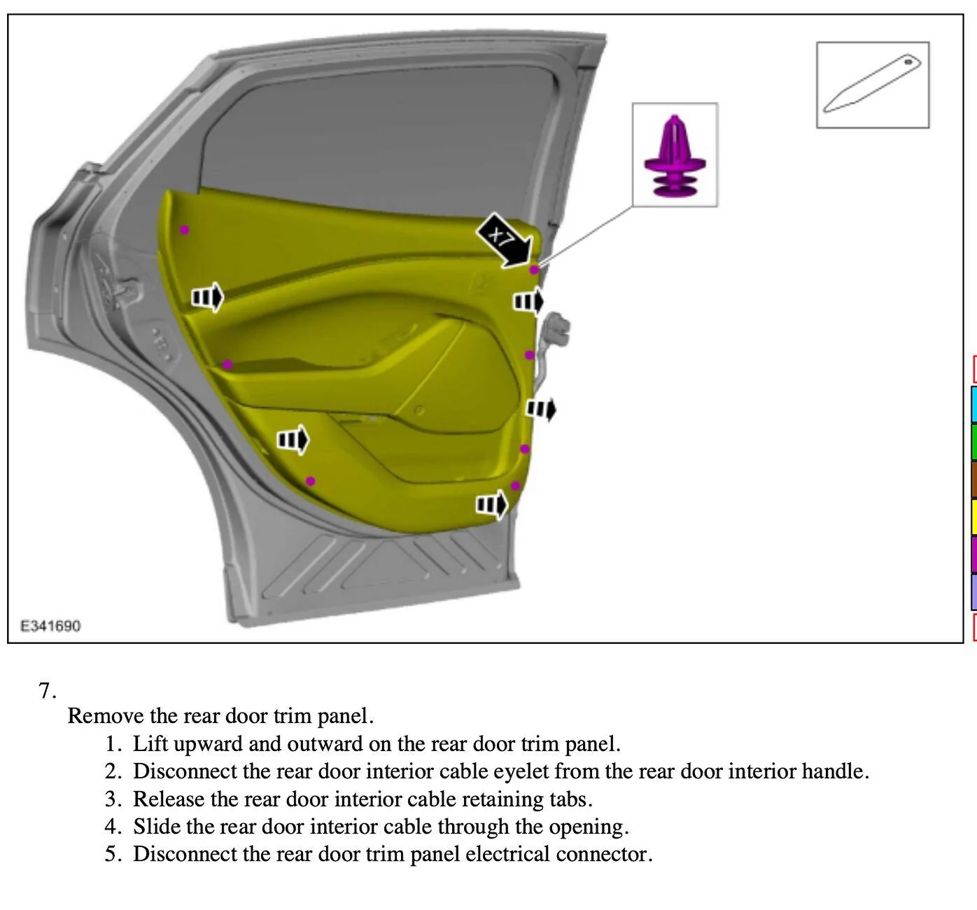

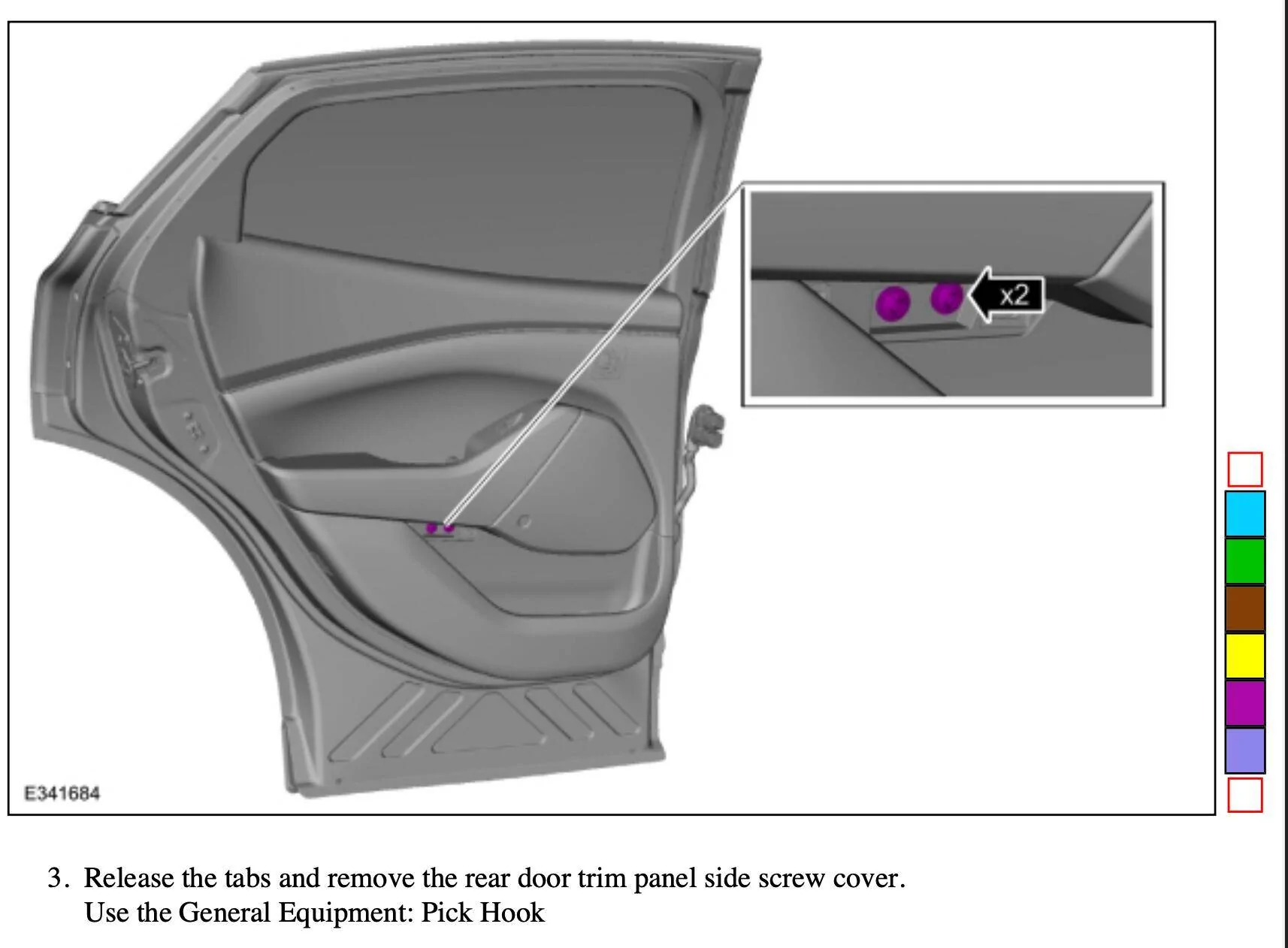

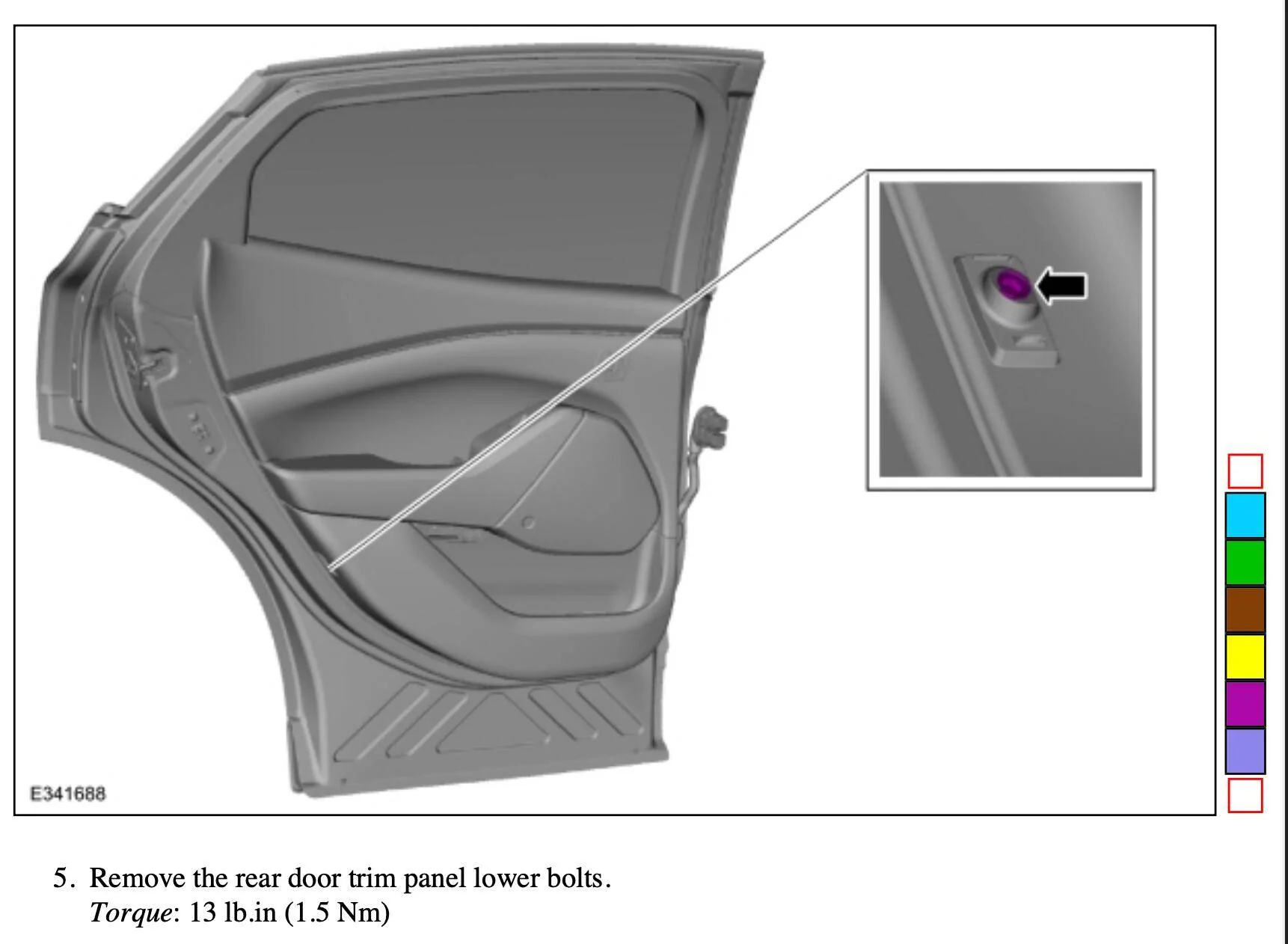

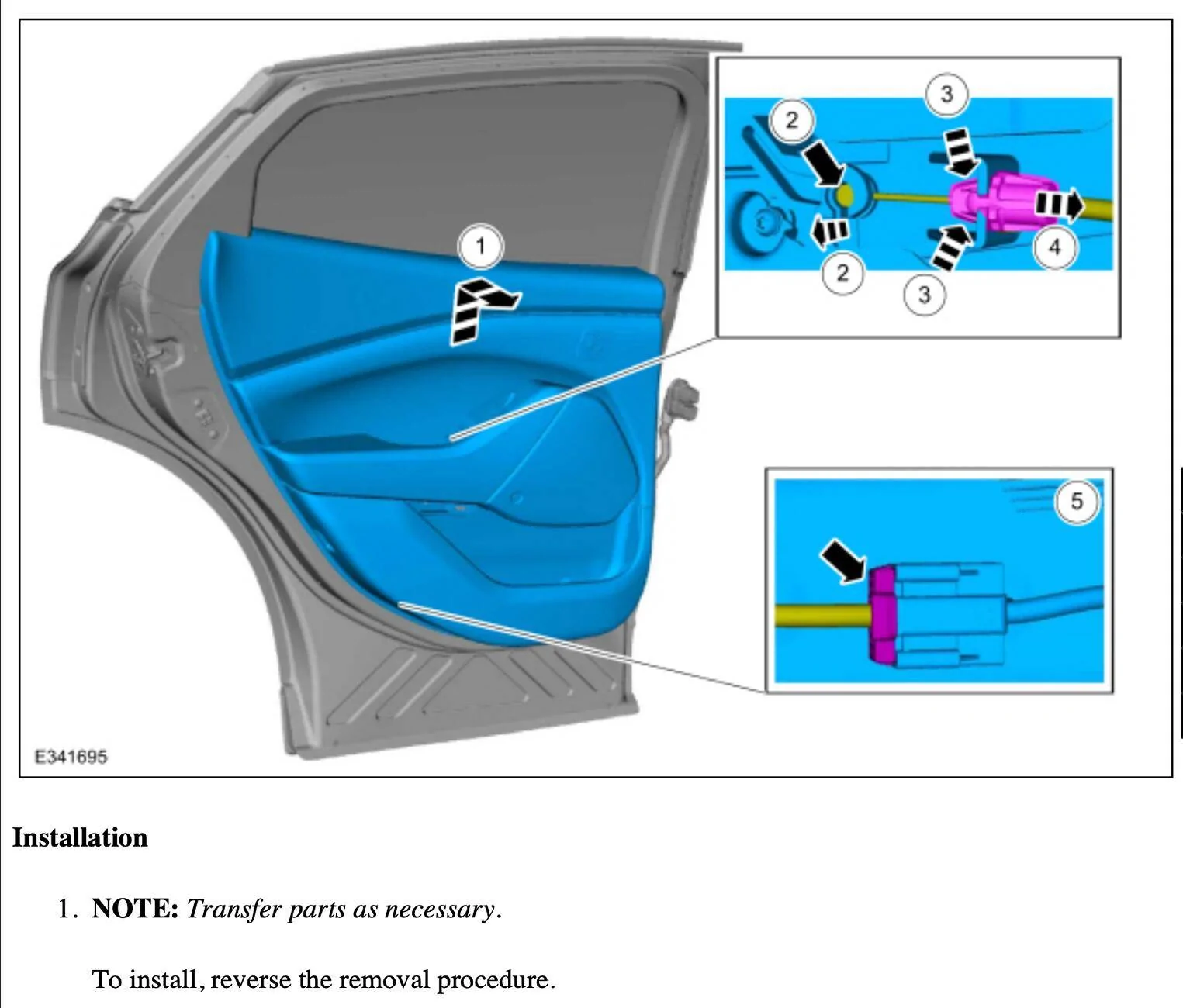

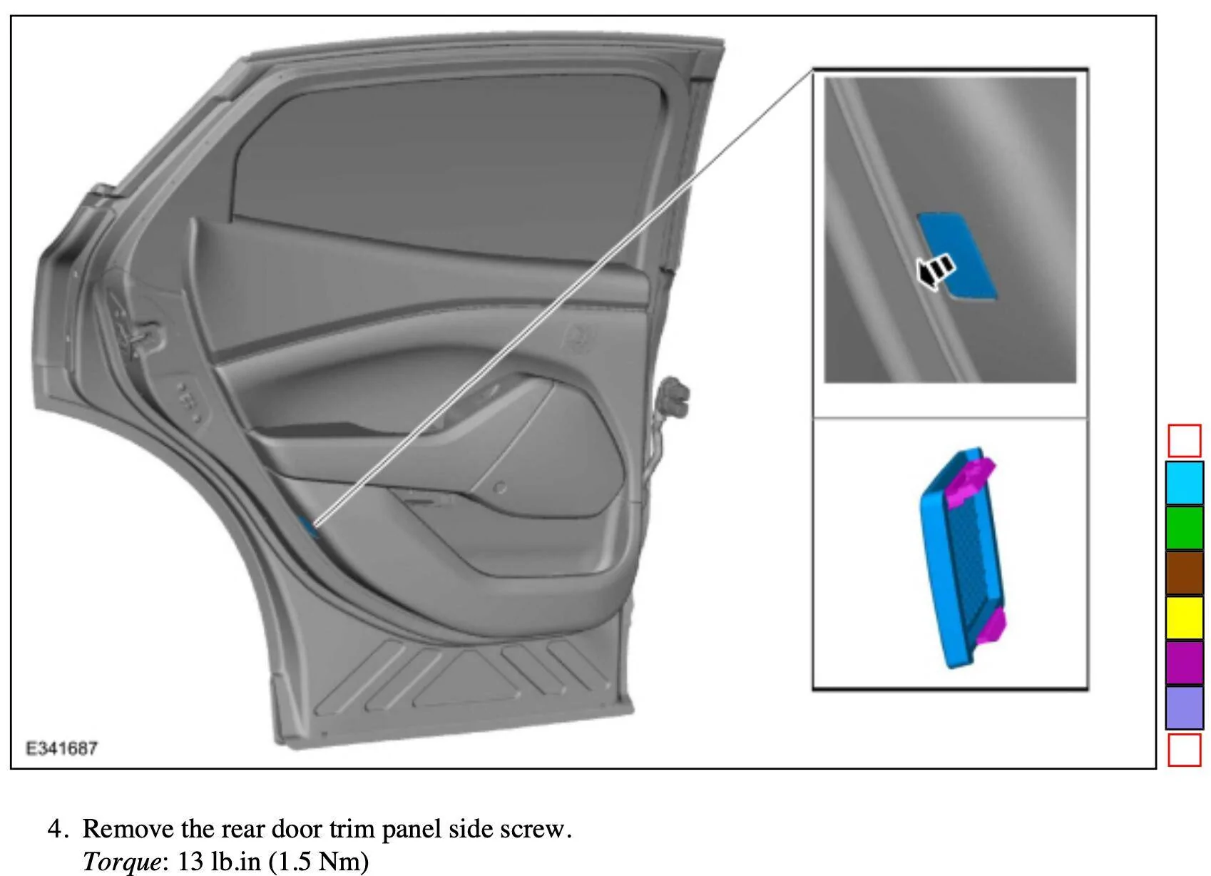

Does anyone have the service/workshop manual for taking the trim off this door and for connecting/disconnecting the inside door handle?

You should still be able to pull the door handle on the inside fully back and open it. If it doesn't open it's 1. not clipped in (last picture #4) and not plugged in last pic #5. If it opens it's just not plugged in, or child lock.
The above dosen't mention the window switch cable plugs directly into the windows switch panel, the 1 plug is for the electric door release.

I forgot to update this... I brought it back to the dealership and they popped off the door panel and found that it wasn't clipped in. See #4 in the last picture of post 2 in this thread.
