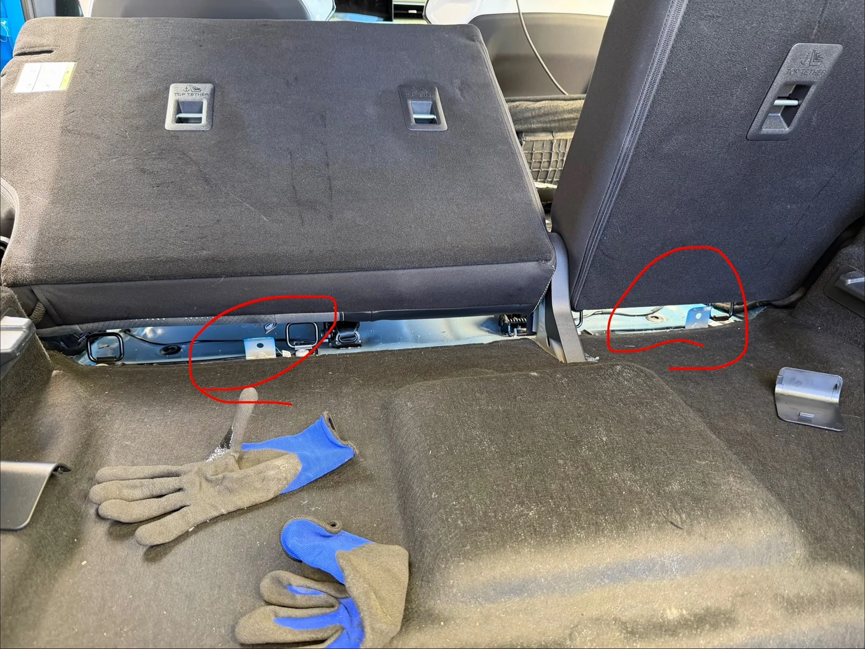

The rear seats are attached at the rear but the front can be popped loose and the seat lifted up to get underneath. The front is just held in place by pressure fittings.
Ford Mustang Mach-E Rear seat removal question? IMG_9546
Complete removal or removing the foam requires unstringing the attachment of the upholstery. These are easy to undo but may require a professional to reinstall. Hopefully lifting the seat will be enough for you to clean out the oil.

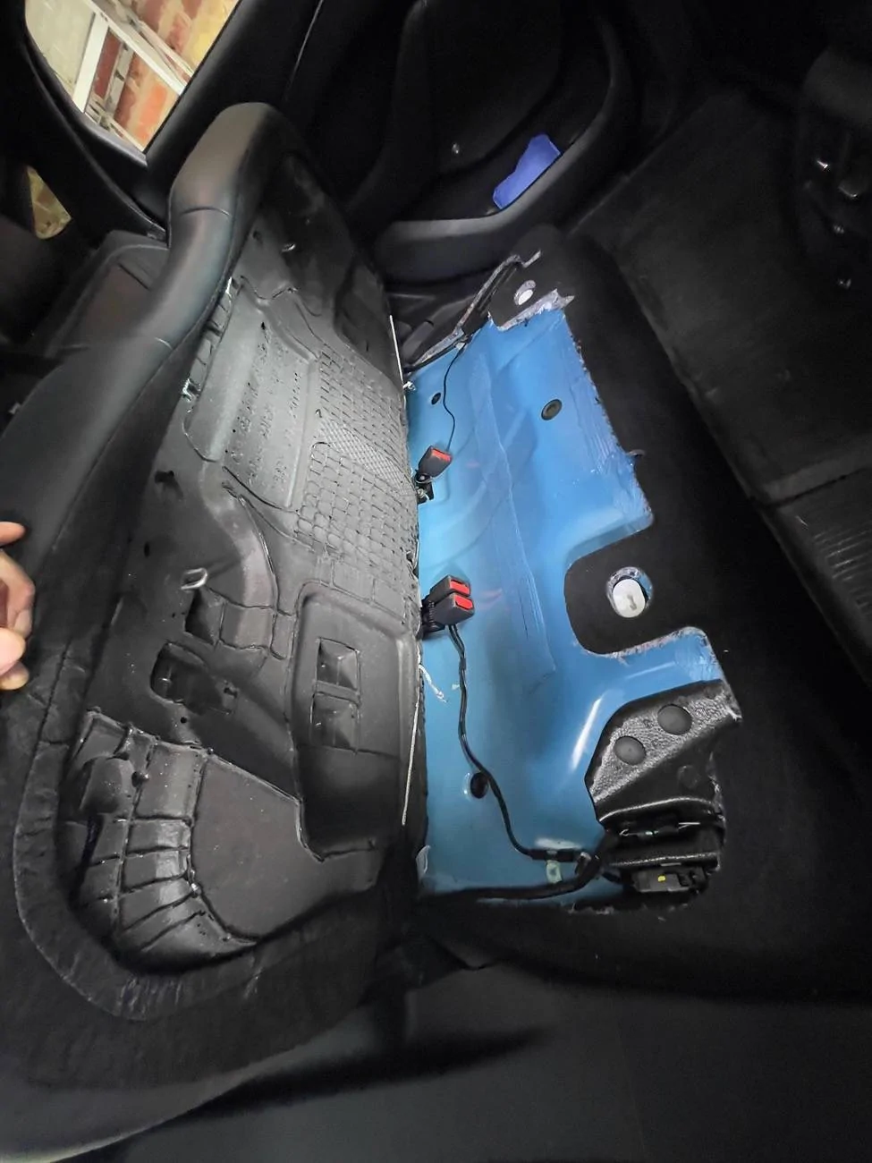

In case you need to get the back off too to get underneath that area, there is a plastic piece between the seat and the C-pillar piece. Remove that, then pull up on the seat. You can then slide the seat around. There is a wire for the weight sensor - unsure how to unplug but should be easy to trace back if you needed to get them out.

Nope. Tug away. You can see in Mark's photo a few posts above about where the metal U-shaped hooks are that snap into the white plastic recepticals that are in the body. That is the area you want to pull up. They are just snapped in.
