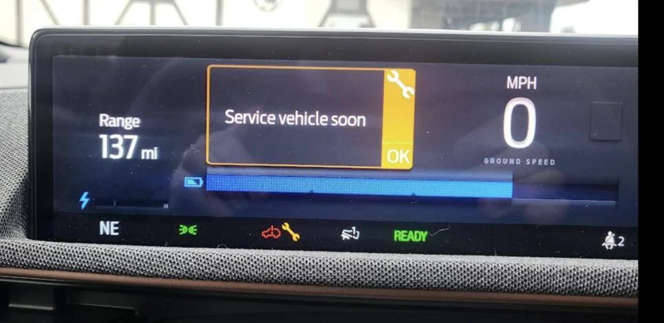

Ford Mustang Mach-E Recent computer gremlins 1673557306695
Oh dear. Experienced no loss of power, so it's not entirely acting like a heebiejeeby. It also cleared after I got home (and backed into the garage) and turned if off and back on again. Still, have an appointment to drop it off first thing tomorrow am. I'm hoping it's another gremlin attack, but it's a faint hope...
IF your HVBJB is failing, the 12v battery voltage can drop to the point the computer freaks out.
Did you happen to check your 'sleeping' voltage of the 12v system?
Do you have your own ODB2 reader to check error codes?
I'm thinking this is the issue - no warnings on start up or issues on the 1/2 mile drive to the dealer. Both warnings cleared from FordPass this morning as well.
I am working to focus the tech's efforts on the heebyjeeby, since it's kind of the worst root cause but a relatively easy one to test for and repair.
