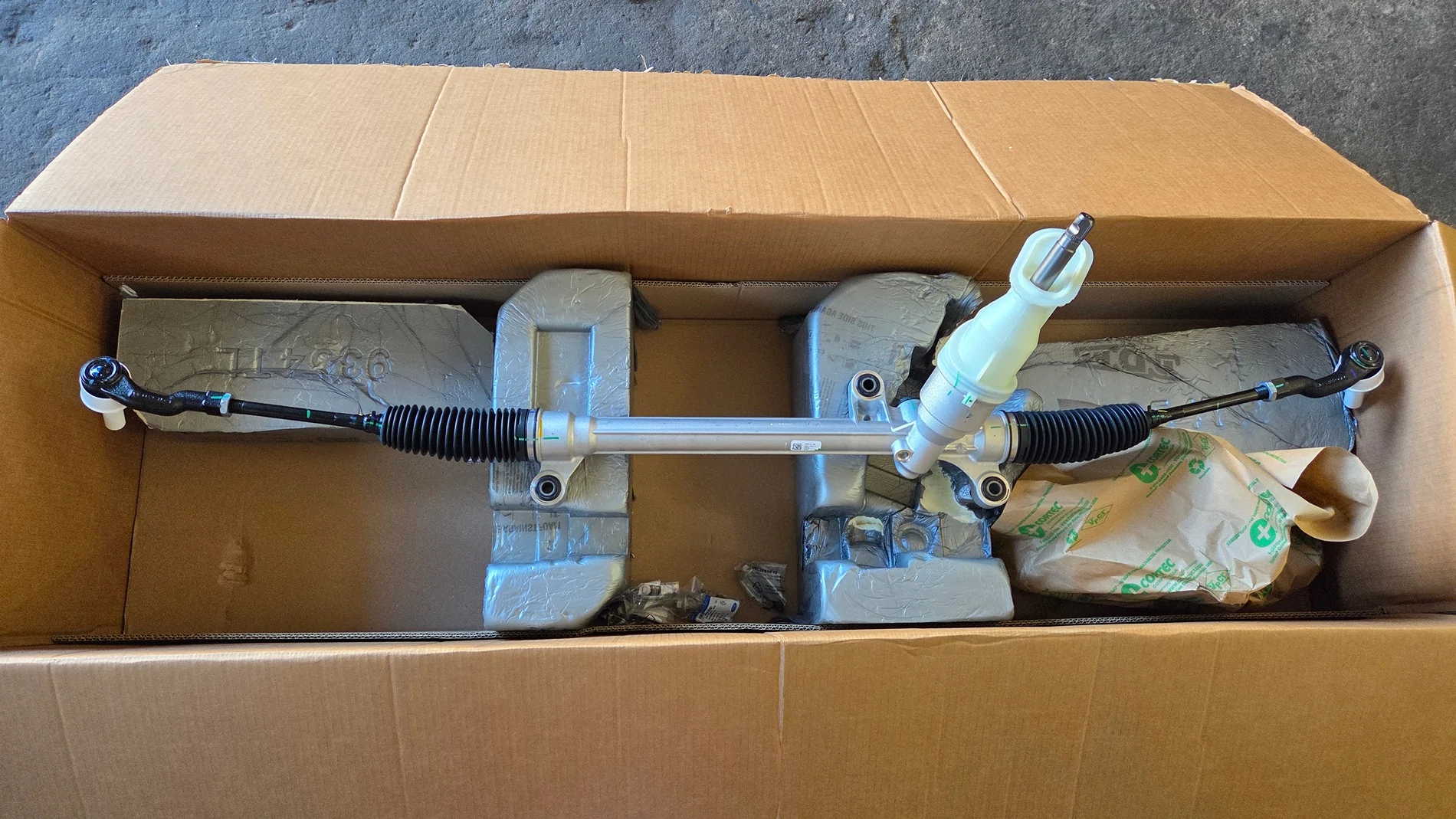

Hi guys,
I'm preparing to replace the steering gear. Does anyone have a manual or guide showing the process step by step? I'd like to know what I'll need to do and watch out for during the replacement.
Thanks!

It's a my old Mach-E GT 2023. Unfortunately, the steering gear has too much play, and it's become noticeable while driving. After inspection, it was determined that the steering rack needs to be replaced, so I'm preparing for the job.

Niestety, gwarancja już się skończyła. Kupiłem nowy z zestawem montażowym. Teraz chcę przygotować się do naprawy, poznać kroki i kolejność czynności.

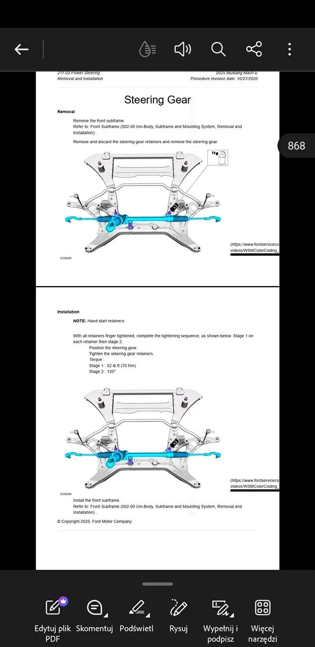

This is exactly how I want to do it. These steps seem obvious and simple to me. The only problem might be whether the gear will exit sideways from the wheel.

Surely if you’ve removed the subframe, the rack should lift off and track rod ends pivot making it unnecessary to slide sideways?

Thank you, I have it but it doesn't have chapter "502-00 Uni-Body, Subframe and Mounting System, Removal and
Installation"

Won’t the rack come out without dropping the sub frame?
I’d be looking to leave subframe in situ if at all possible.
With frunk inserts out the way should give an idea if this is possible.
The only possible reason I can see that the subframe might need lowering at all is to drop the rack off bottom of the steering column which remains in situ.
Normally there’s some movement of the rack once unfastened, and column to facilitate this.
Removal of subframe’s a job I’d try to avoid though I might be proved incorrect.
