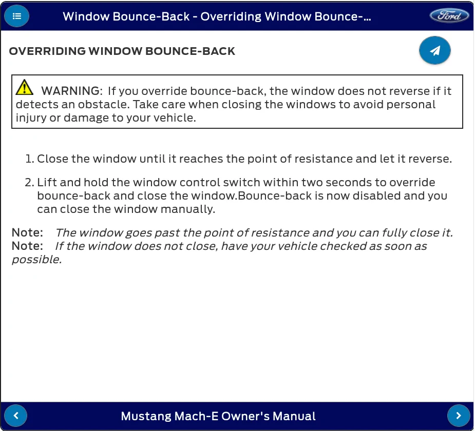

You may be getting automatic bounce-back because the window (rightly or wrongly) is sensing an obstruction. Here's how you turn it off:
Ford Mustang Mach-E Right window opens during parked and back opens on its own also Screenshot 2026-04-05 14.13.39
