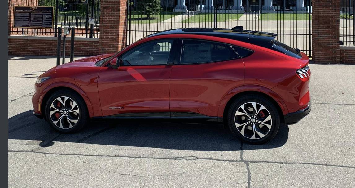

I dunno about the brake rotors just 10". Seems like an odd thing for Ford to be very specific about yet wrong on across the entire lineup, no?
I mean, the rotors look bigger than 10" across to me in this photo.

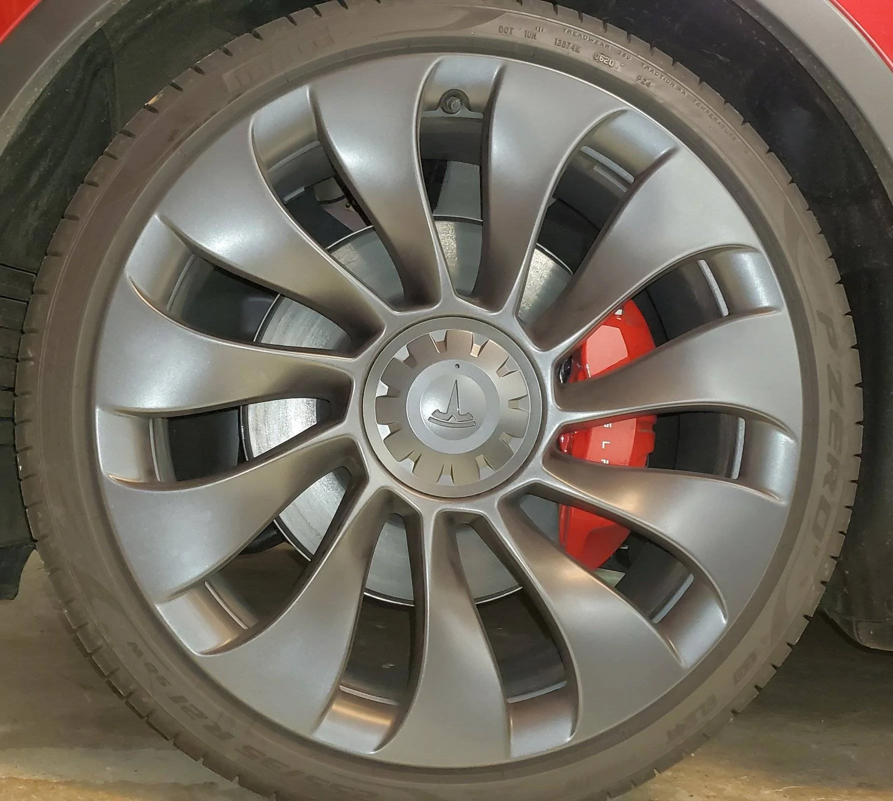

I imported this photo into my CAD program, set the rim diameter to 19" and measured the rotor diameter at 10". The picture was included in the original thread on TMC, and initially I did not notice that the OP chose not to include that photo here.
The numbers on that Mach-e spec sheet are clearly wrong. First, it is not physically possible to have an 18" rotor with an 18" or even a 19" rim. There must be room for the caliper. Second, the largest brakes EVER on a production vehicle are on the Lamborghini Urus and measure 440 mm--17.3". Even the mighty Mustang GT500 is equipped with massive 420 mm brake rotors--16.5". And that requires 20" wheels. Interestingly, Ford seems to have an issue with getting their specs right on the GT500 as well. Look at this page, they correctly list the 420 mm rotors, but list them as 15.5" in diameter. 420 mm is 16.5". GT500 specs.
It would be absolutely incredible if Ford offered the 16.5" rotors on the Mach-e GT, but I seriously, seriously doubt it will happen. 13" would be stunning for a production car, 12" would be excellent as long as you didn't want to track the car for more than a few laps. 10" rotors on a car like the Mach-e are insufficient and fans should make sure that Ford knows that fans care that the Mach-e lives up to it's potential. It's simple physics; 10" rotors are neither sufficient nor safe for a 5000 pound car with the performance capability of the Mach-e. Did you ever see an early six cylinder Mustang with a V-8 engine swap where they neglected to upgrade the brakes? I drove one and it was an accident waiting to happen. Same thing here.
EDITED TO ADD: I added a photo of a Model Y 21" wheel with 12" rotors for a visual reference for those without a CAD program. Remember to bear in mind that the E rims are 19" and the Y rims are 21". These pictures also highlight another disturbing point about the E brakes. Look at the relative size of the calipers. The E calipers simply are too small for a car that weighs 600 pounds more than the Y. Granted, the Y pictured below is the performance version, but the only differences in brakes between that and the base model are slightly thinner pads and rotors on the base.
