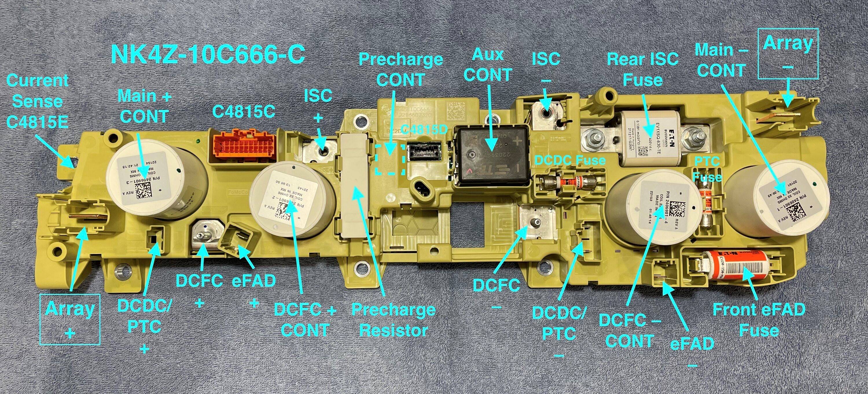

Welcome to the club. Mine is currently in for the second replacement, but the good news is Ford does have an updated part which is supposed to handle the high voltage better so it doesn't fail in the future.
This is what the part looks like:
Ford Mustang Mach-E Safety Update done HVBJB WITH LABELS
edit: Too funny... I used Mach-Lee's picture and in the time I was posting he already posted the link above ?
