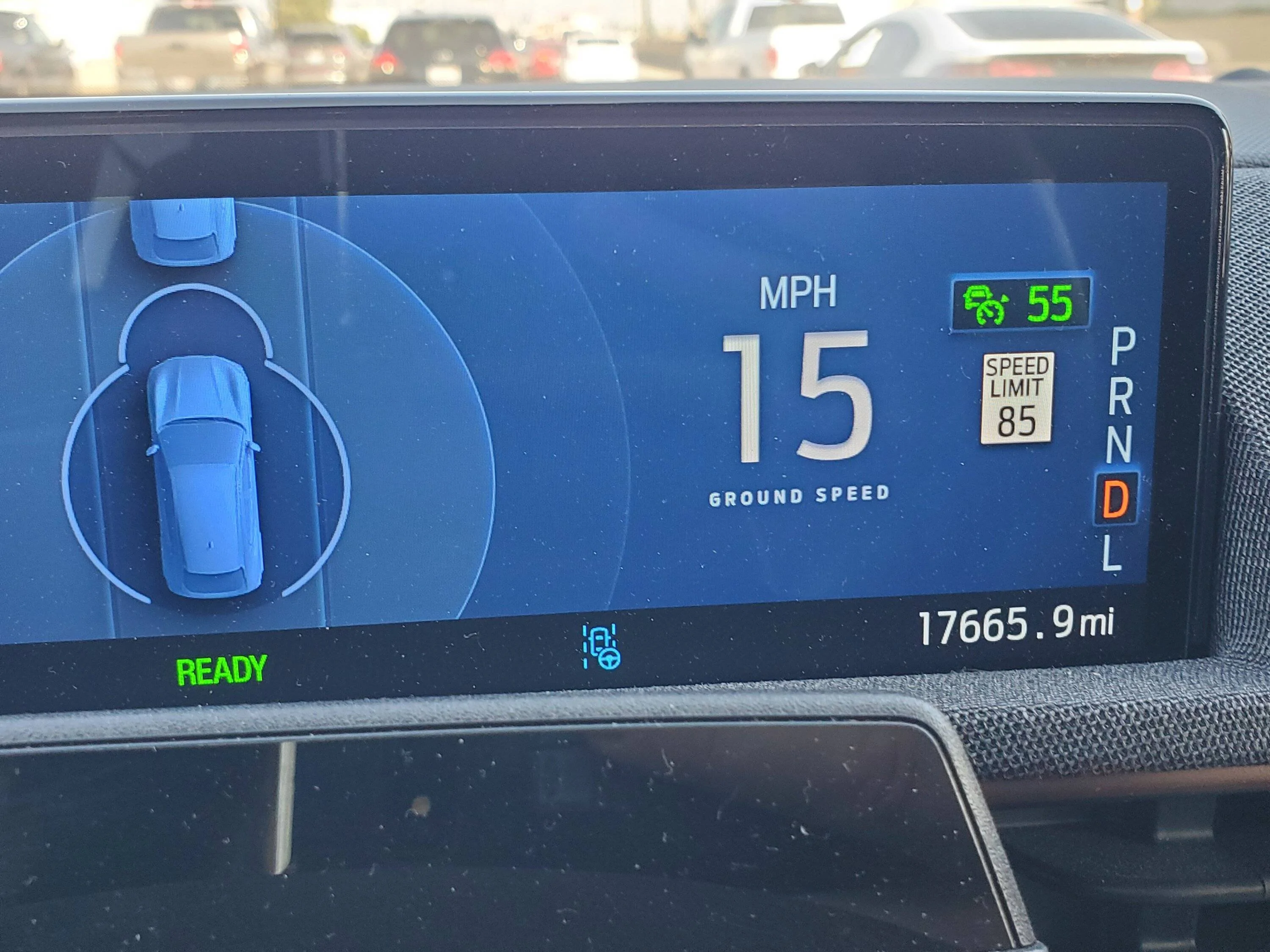

The thing that gets me is that it should be easy enough to write into the code that in a state like California the maximum speed limit *anywhere* is 75 mph, yet I have had the system believe that I was in zones with speed limits as high as 85-90mph.

I got a great laugh one day when I saw my '21 GT's "speed limit sign" change near downtown LA! If only I could... and grow a couple wings too! [One of the signs I passed had been tagged all over with graffiti, ha!]
