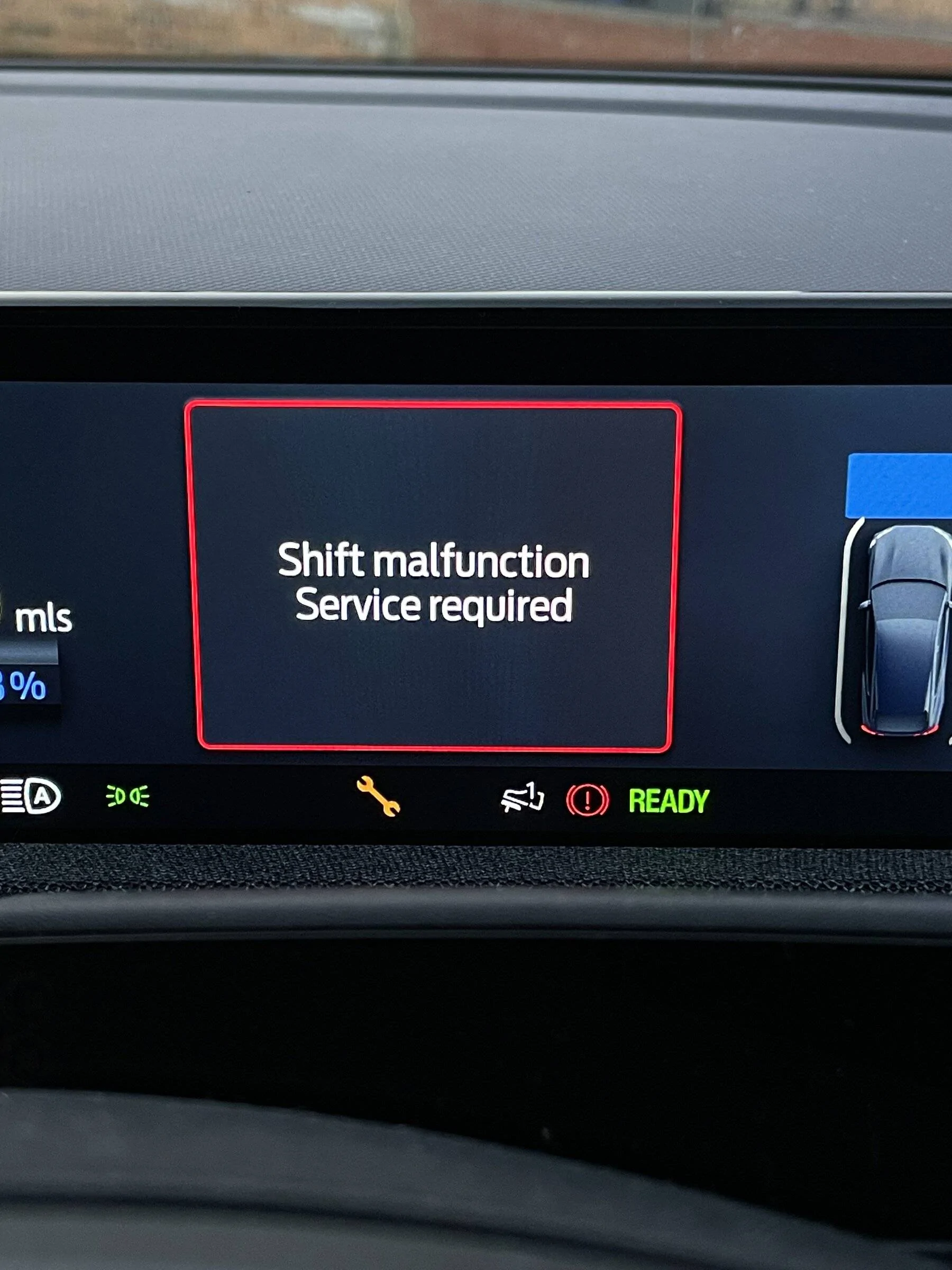

Got in my car this evening at home, started it up and shifted to reverse and got this same rather disconcerting error. Car drives okay and is shifting to reverse and drive successfully. Seems like going into and out of Park triggers the alert/warning. I've owned the car for about 6 weeks, took delivery in mid January.

Called the local dealer yesterday, dropped it off on the way to work this morning, was ready by noon. Below is the info from the service department. Not really sure how to decipher it.

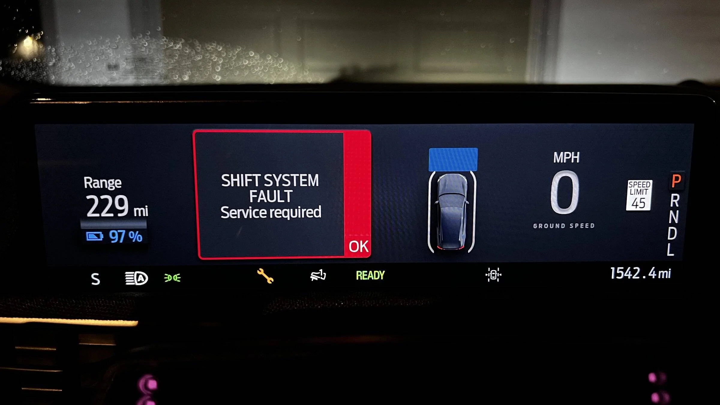

The car drives fine, but whenever I turn it on, it chimes frantically and flashes up the same notice everyone else has been getting. The car was built in Feb 2021. It had less than 6000 miles on the clock and I’ve already had to have both front drive shafts replaced, the windshield recall, the roof adhesive and now this… all in under a year… wtaf?

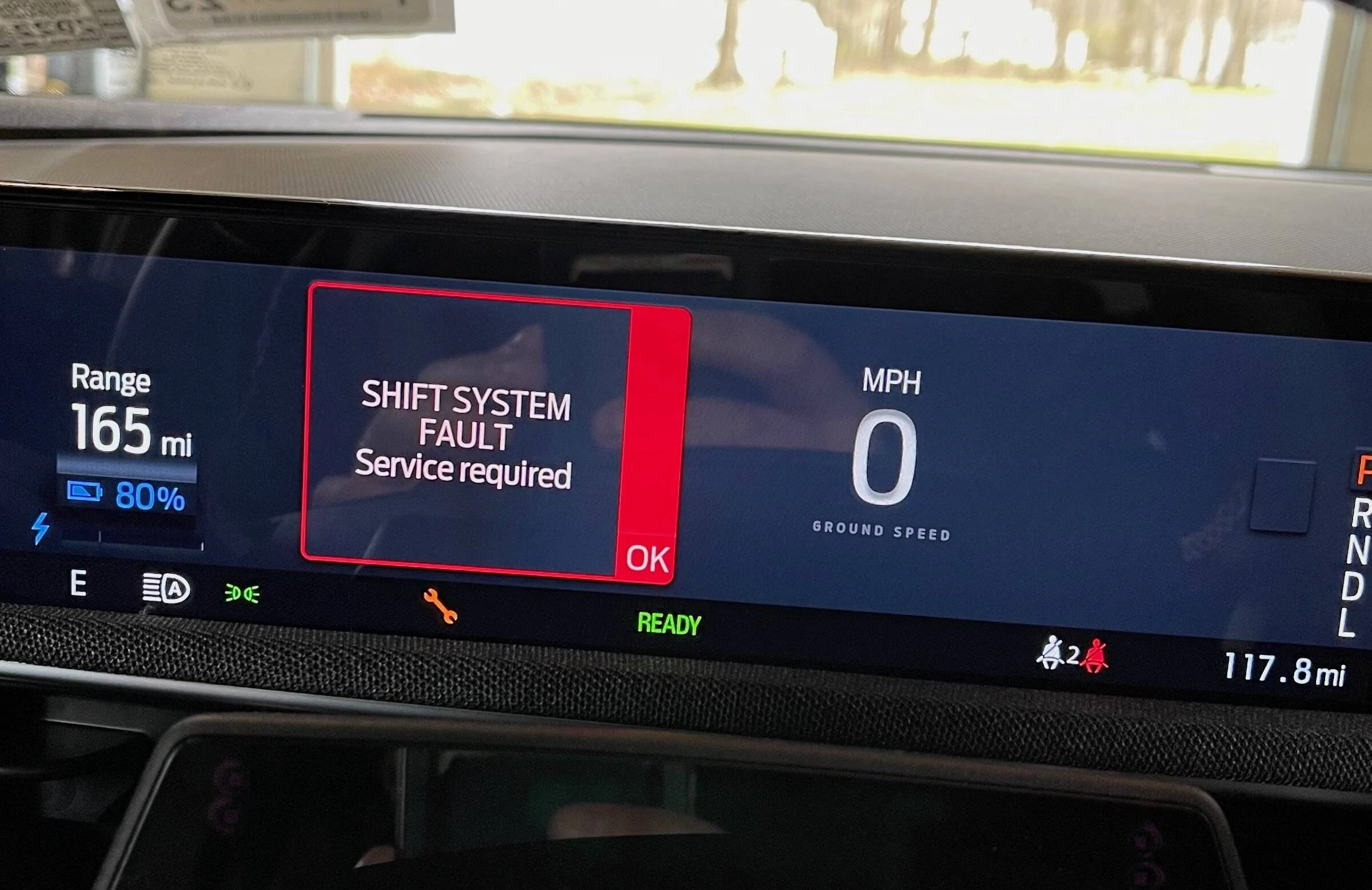

My MME GTPE was built August 2021. Delivered October 2021. I drove it a couple times after but the weather here in NY was getting cold so with summer tires I garaged it at 70 miles and moved it in and out of the garage a couple times during the winter when it was warmer but no long trips. The weather is getting warmer here now finally so I decided that I would use some tax return to put some Continental ExtremeContact DWS06 Plus on so that I can drive year round. I am tired of being jealous of my wife driving around in her MME FE while I am tooling around in our Pacifica Hybrid (love it for driving our kids and dogs around and on errands however so it's not the end of the world). I went to drive the GTPE out of the garage to go to the tire appointment and the error appeared. I drove it to get the new tires and back home, round trip 50 miles and the message never cleared. It seemed to drive fine, similar feeling to our MME FE anyway, and it shifted in and out of F/R no issue. Once I got home I called the dealer I bought it from and they can take it in this coming Tuesday, so back in the garage until Tuesday with 117.8 miles on it, which wasn't the plan. I was really looking forward to testing out the new "shoes". Really bummed out and a bit concerned about not only our MME FE now but the Lightning I have ordered which is scheduled to be built the second week in May. Ahhhh, the joys of beta testing...
