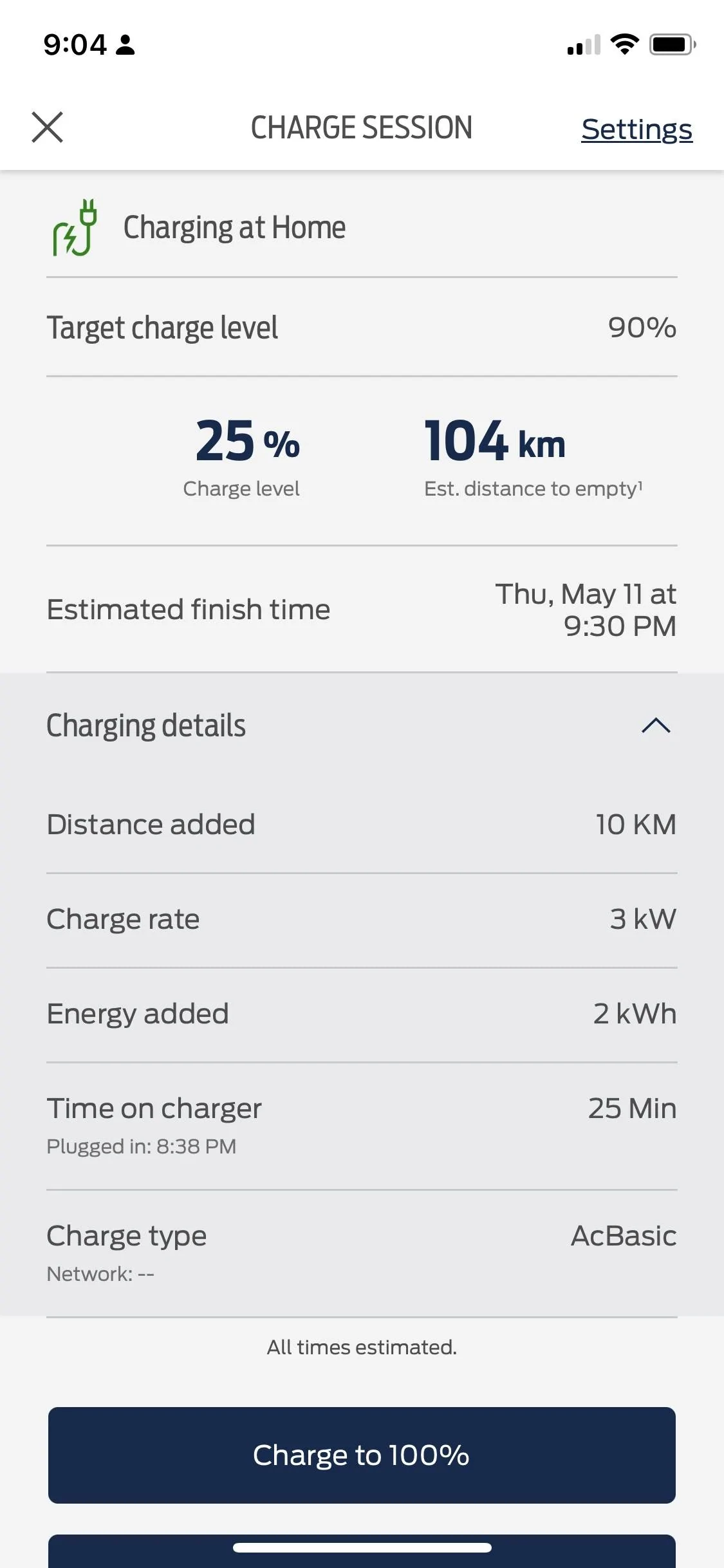

Has anyone noticed exceptionally slow charging with the supplied charger on a 240 outlet? Lately I have noticed that charging takes forever at home and now with the app update I can see it’s only pulling a charge rate of 3kw?
Thoughts?

The Ford Mobile Charger (FMC) is known to have thermal issues, especially at 220-240V. Every time it gets used and it brings itself to a temperature that it can't really handle, it damages itself a little, resulting in slower and slower charging until it eventually just errors out. You would be doing yourself a favor by getting an L2 charger from a reputable manufacturer. ??

Thank you! Was hoping to avoid that but may be out of luck. I’ve had it for a year now with no issues.

Yup, junk charger only putting out 3 kW instead of 8 kW...

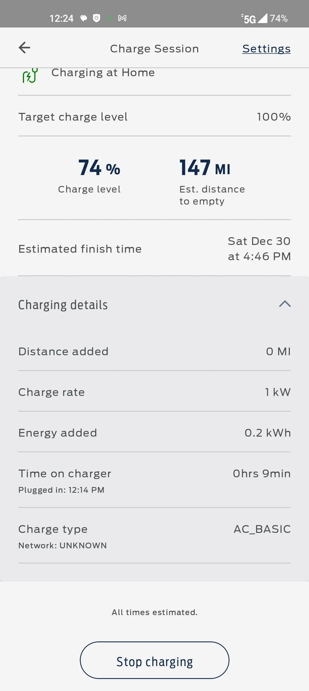

I'm having an issue today where I plug it in to a 50amp outlet and it's only charging at 1kw... I tried unplugging and plugging it back into the car, the outlet, and the 50amp cord end and still will only charge at 1kw.
Anyone else had this issue of just 1kw? Based on prior comments it appears my charger may be defective.
I usually use it on 120v but was trying to charge it at a the neighbor's house with a 50 amp outlet in preparation for a long drive this evening.
