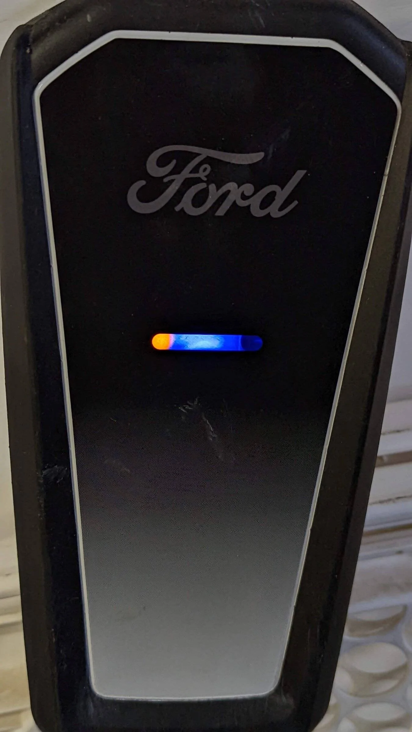

What does the Orange LED mean? I notice it charges much slower when the orange led is on. I have been this charger as my "main" charger since Feb 2021 (27K miles). It is plugged into a 240v outlet.

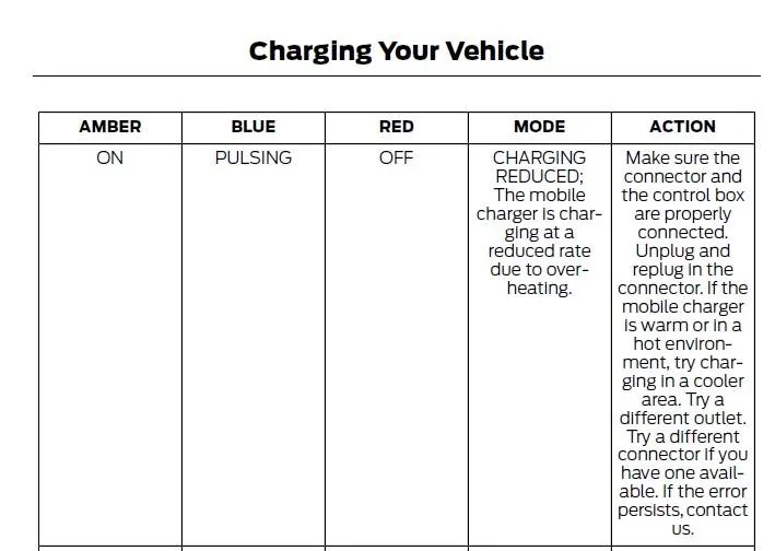

Per manual, there are some other cases so can check Page 165 in 2022 manual.
That orange is actually amber. Your symptom is the classic “overheat detection” failure mode being reported by quite a few people. Your dealer *should* replace it under warranty.
