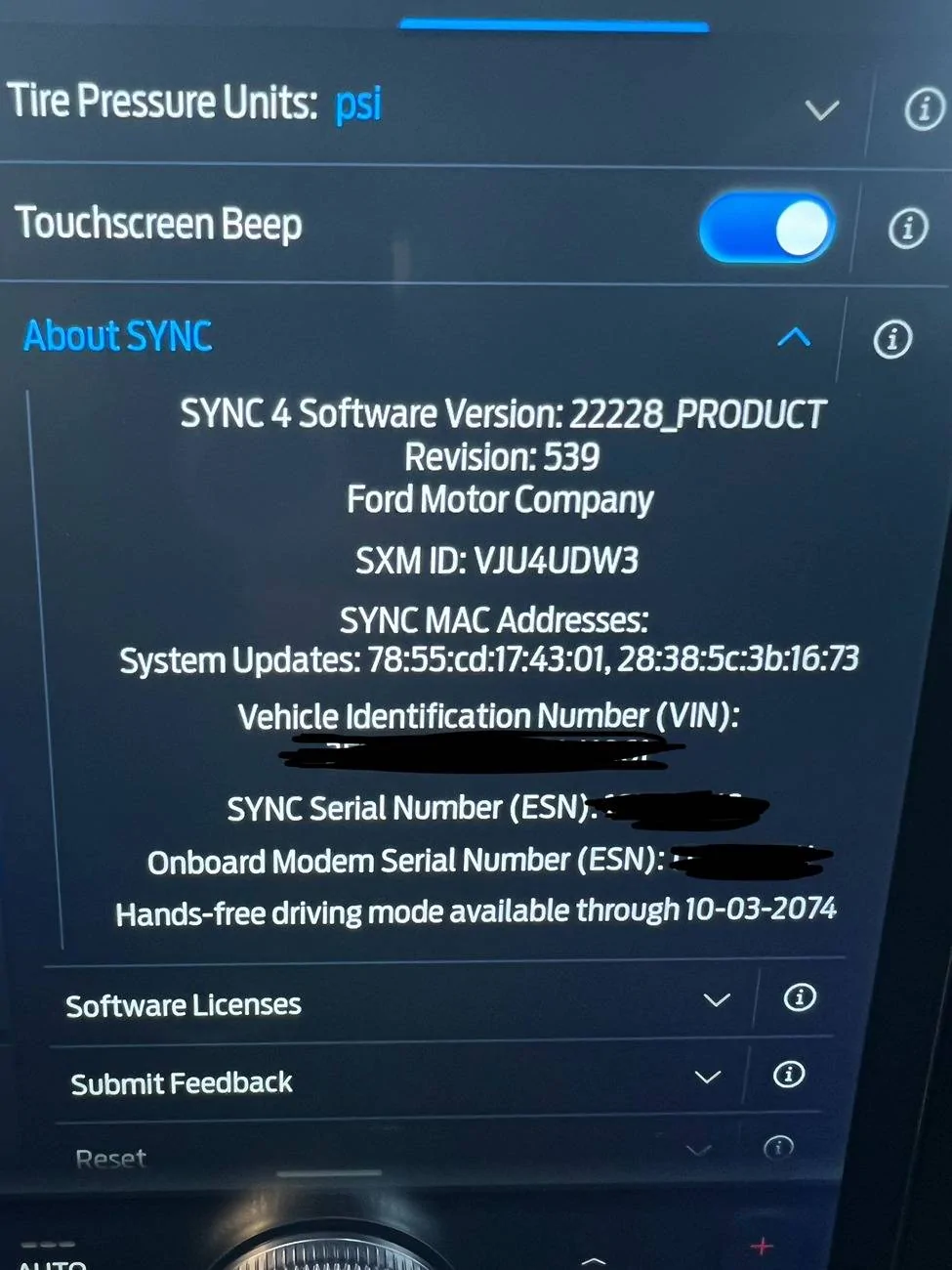

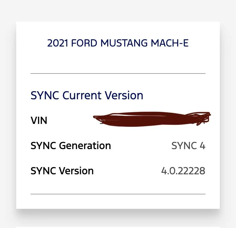

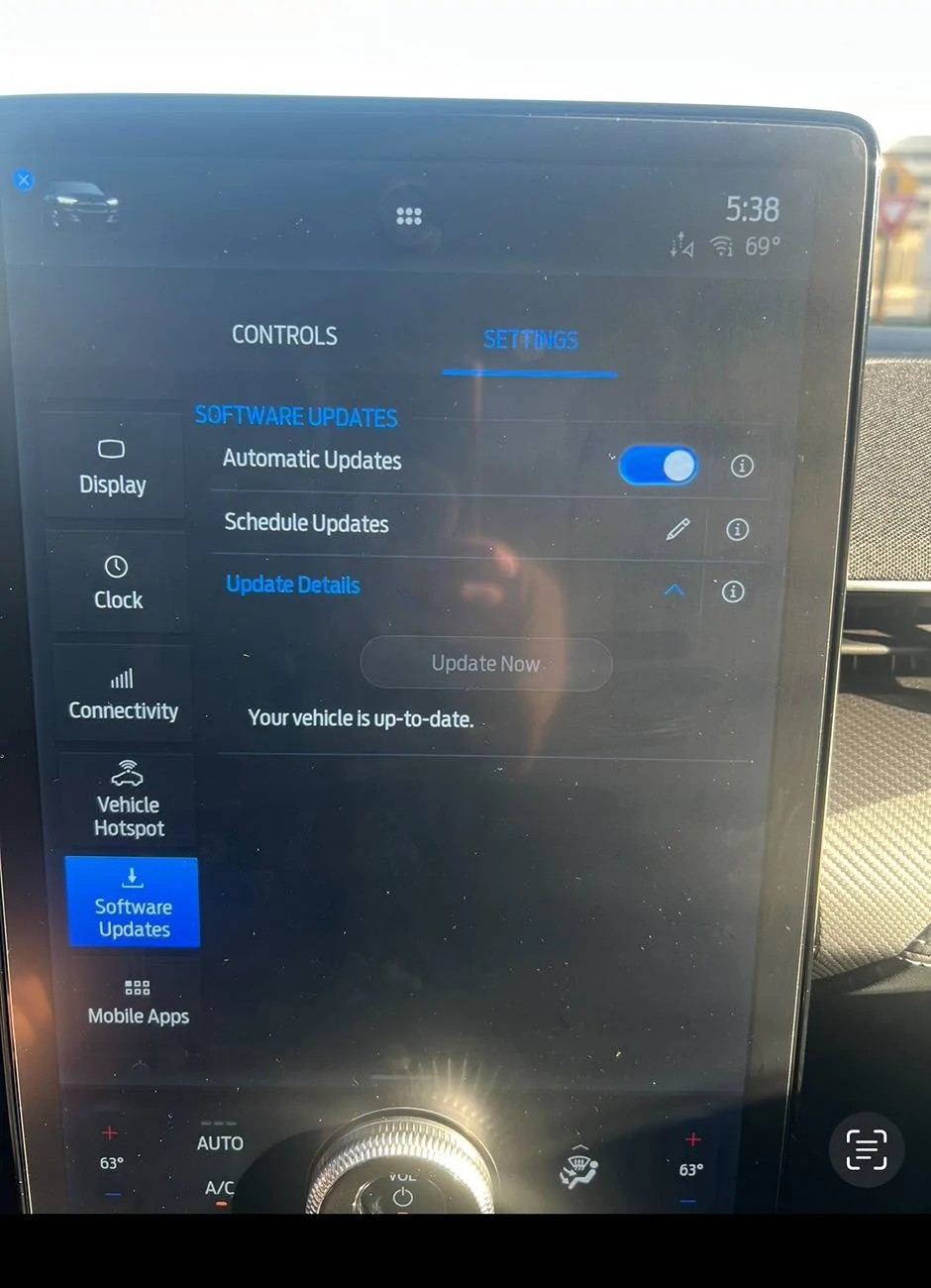

OP - can you take a picture of where you’re getting your current version from? I am almost positive that you are looking at your current “Sync4” version - which is just the UI. But people are getting confused and telling you about software versions for your entire car.
Either way, the major system updates are what update the sync version and it sounds like you may be a version behind in the UI. I don’t think you’re as far behind on system updates as some of the earlier responders were thinking you were though.
okay got it, good to know. Yes, I will post the pictures of the areas i'm looking that show the car information. I guess I don't mind paying for an update for the car it's just confusing trying to figure out if there are updates available and what exactly needs to be updated.
I attached pictures of all the places I can find information about the status of the software
