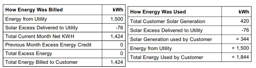

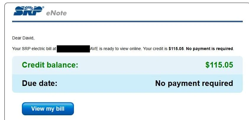

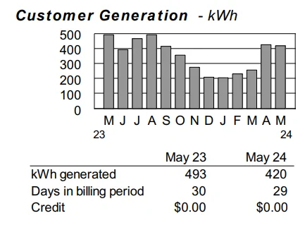

I've had 14.5 Kw of PV panels on my roof since 2015. Yes, I bought them and had them installed using a local independent contractor, I charge the MME at home 90% of the time, my house is all electric, and the A/C runs most of the time here in the desert. Here is my current statement from my electric utility:
Ford Mustang Mach-E Solar Power-Zero Emissions Screenshot 2024-06-01 202421
