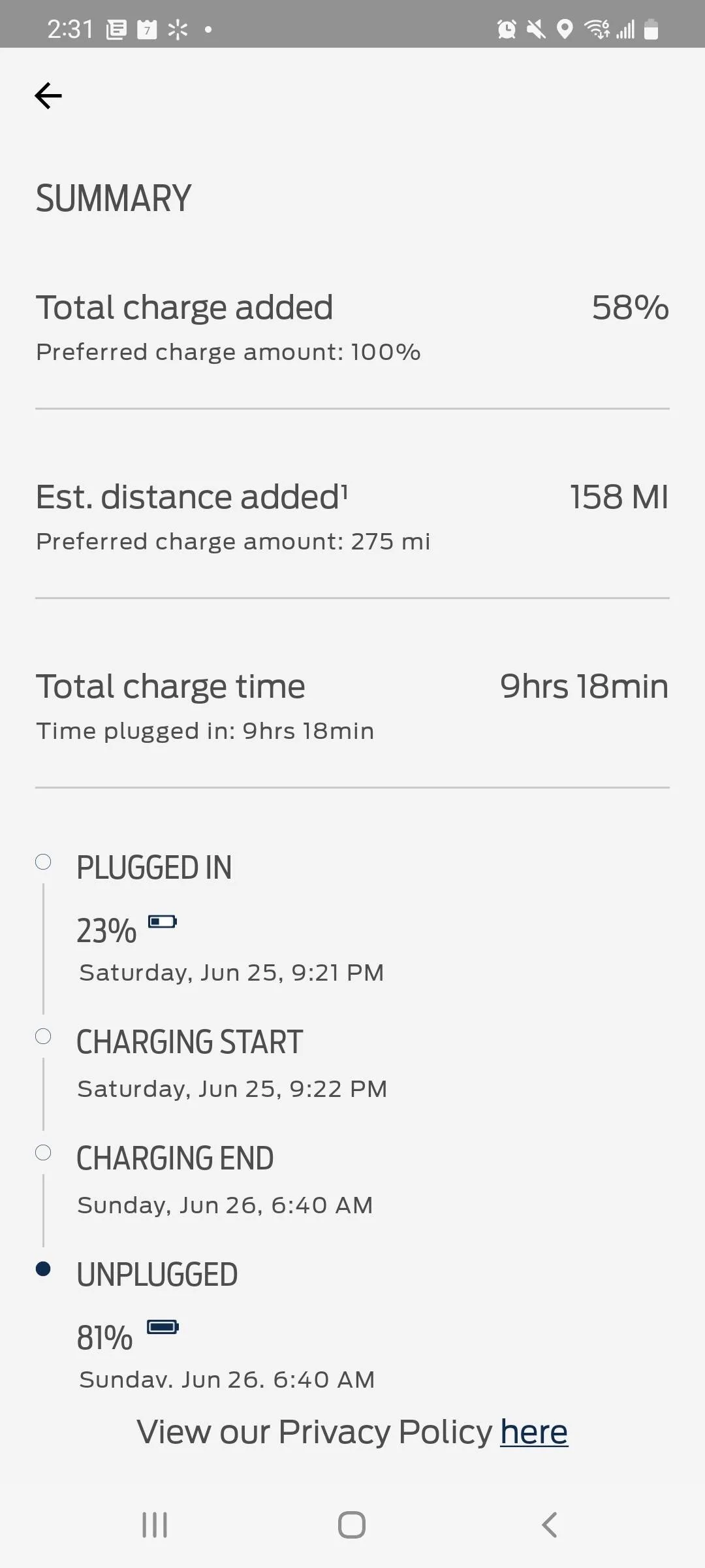

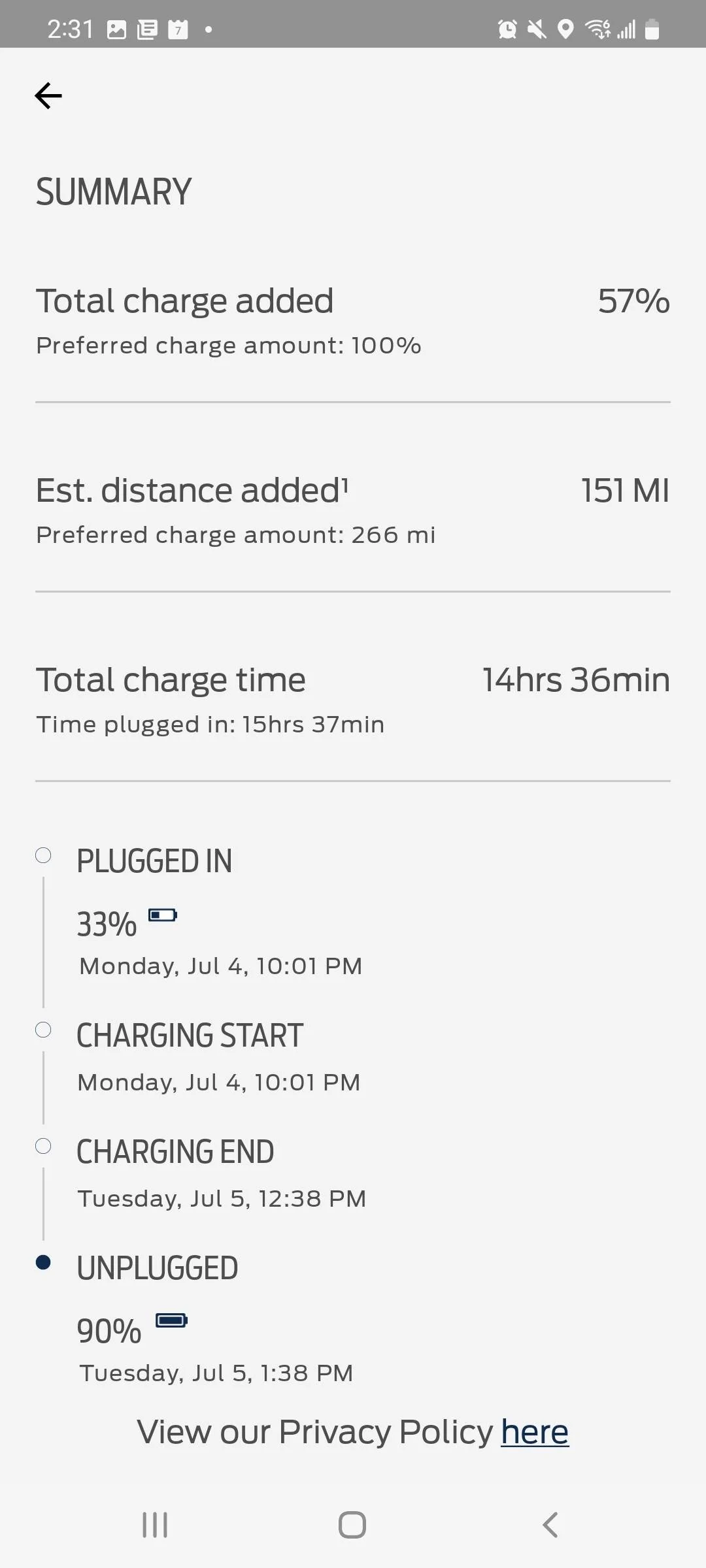

My 240v charger used to charge at 6kw/hour, now only does 3kw/hour (this started happening last week) Do you think it's the charger and the dealership would give me a new one if I report it?
Thanks!
Thanks!
Is it overheating like described in previous posts in this thread?
