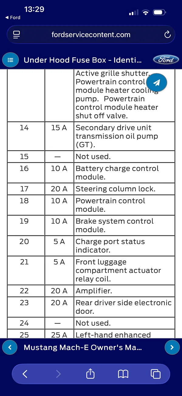

I suggest you check the fuse (see attached) which is difficult to get to but instructions are to be found in the manual, and then start circuit testing etc.
I really looks like there’s an electrical fault, possibly with circuitry or the electric release itself.

No.... I've checked in ForScan and I have the first version (job1) and the BCM was not updated for this option.
