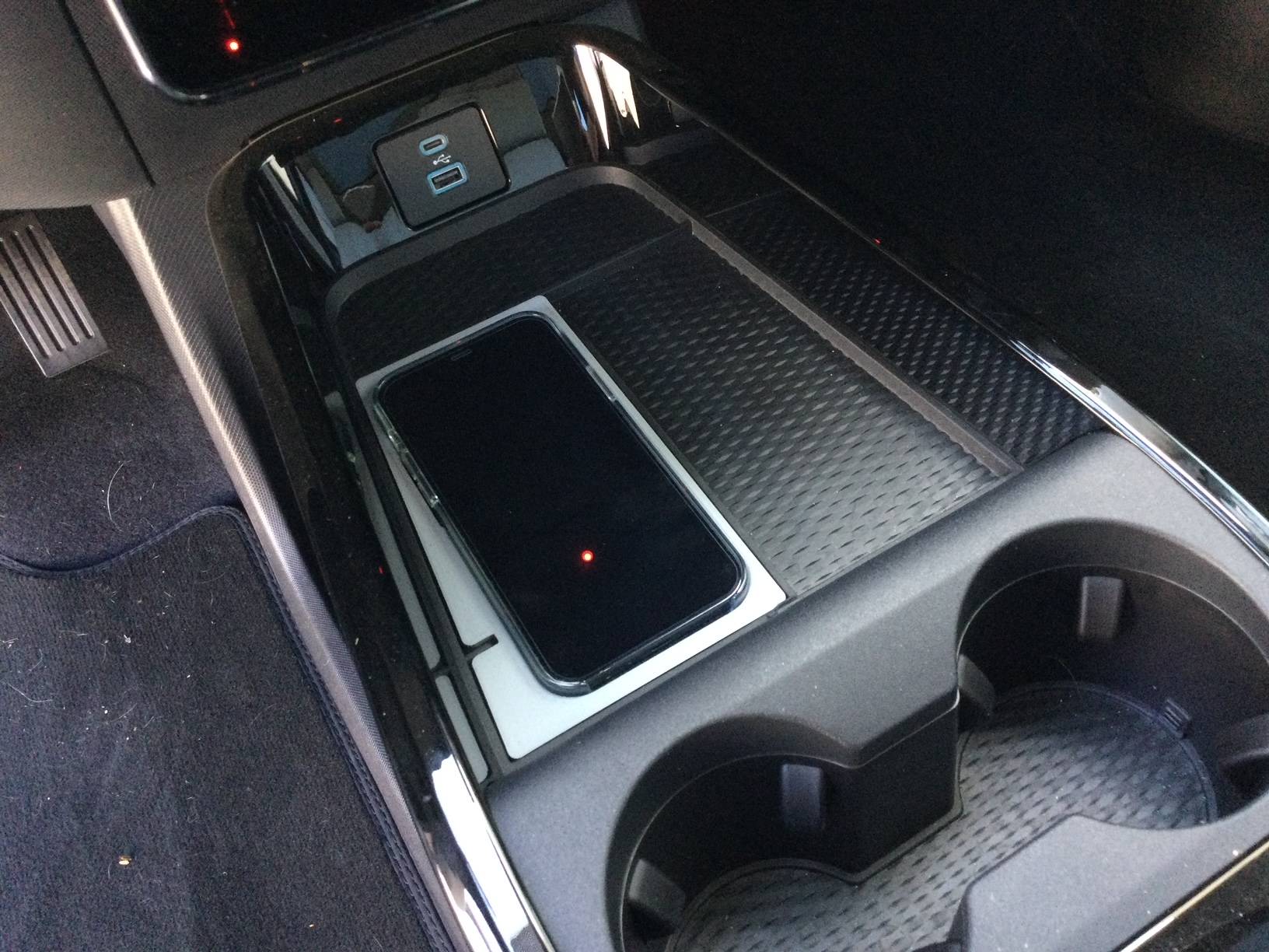

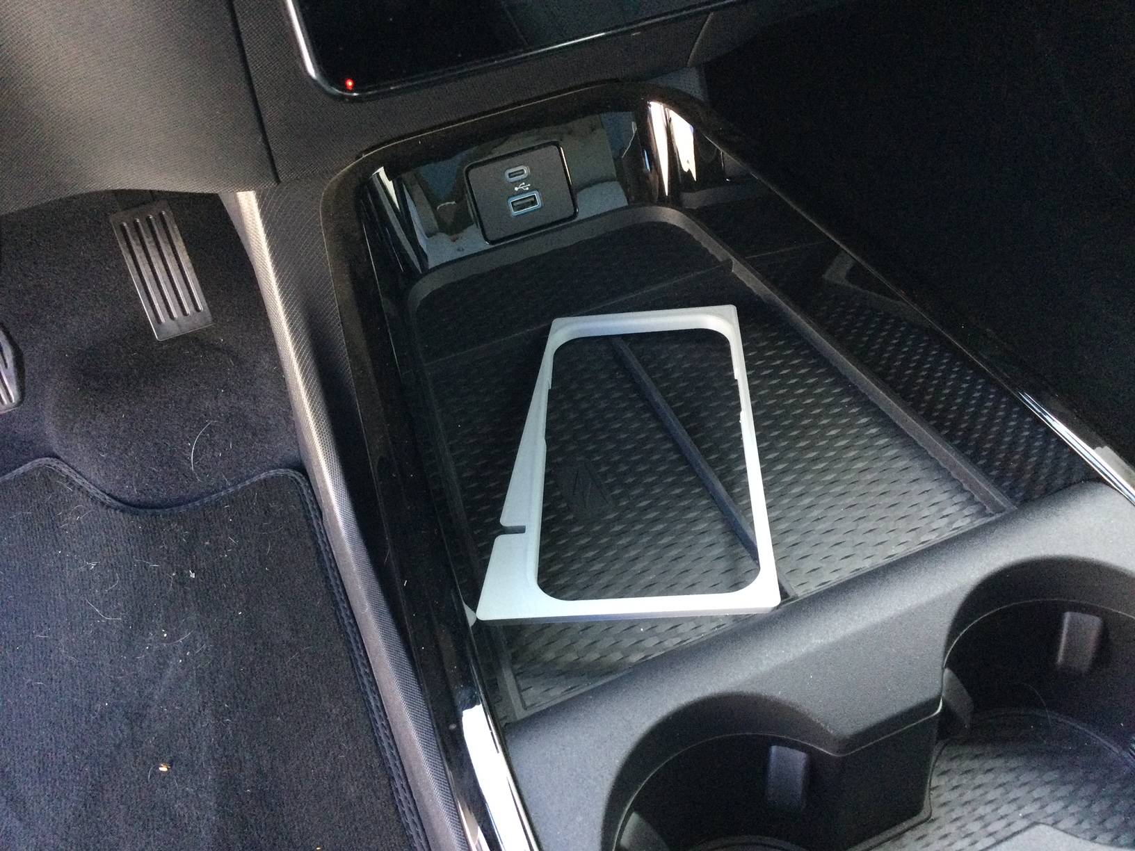

NOt sure f this was happenign to you but my phone would charge and then 30 seconds later stop. I do product design and own a number of 3d printers so I figured I can solve this and I did. I 3D printed this possitioning insert and now the charging works everytime all the time. This was built for an Apple Iphone 12 Pro with a magsafe case around it. It is currently printed out in PLA but I am going to print it out in ABS or polycarbonate so it can stand up to heat. PLA will deform. Anyway thought I would let people know this solves it.

Nice work, but my experience has been that it's not a matter of alignment so much as it is a matter of the thickness of the OEM mat. Qi isn't THAT fickle, but putting a 3 mm obstacle in between the charger and the phone, and then putting a case on top of that is quite a bit to work against.
Perfect alignment is helpful. BETTER though is less distance (thinner material) between the charger and the receiver in the phone.
I used a black silicone mat that's about 1 mm thick. You could use a kitchen drawer contact sheet also. The key thing is that you want something tacky so that the phone stays put when the car moves.

Call me stupid, but I don’t understand the problem that is being solved here? I have an iPhone 12 Pro Max in the Apple Clear Case with MagSafe. The phone fits on the charging pad pretty snuggly (a bit of wiggle, but not TOO much) and I’ve never had issues with charging. The back of the phone does get very warm after it’s been on the pad for an extended period of time. I assume this is either due to the nature of inductive charging or the usual “battery gets warm during use”.

My phone is the iphone 12Pro (not max). I know the Pro max fits perfectly in the cradle, mine rides around and looses the charge all the time, not with this insert.

Wow! That's pretty freaking brilliant!

Yup - same here. Holds a charge for a couple min and then goes away. Hoping this solves it (as it looks to align the phone to the sweet spot for charging).
