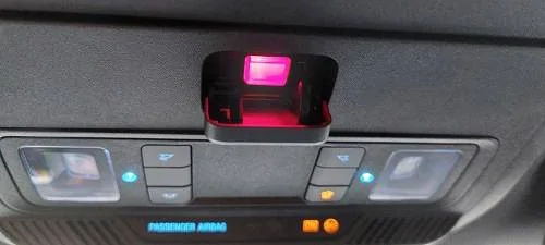

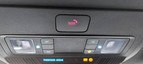

What is an “emergency call button”?

We don‘t get it here, but it’s in European MMEs.

That's right, It is the emergency assit feature in Sync that detects a collision and automatically calls 112 and cannot be turned off, but it does not require a connected phone, it is called by Sync. But the emergency call can also be made manually using the button on the overhead console.
