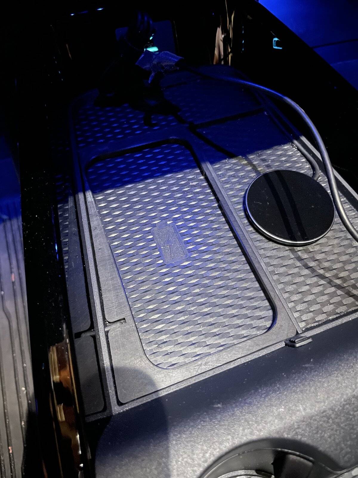

Since seeing this posted, I have been placing my phone in the approximate position the 3D printed template would hold it (roughly centered, instead of up against either the side or the little sticky-outty part on the left, which was where I instinctively had been putting it). I haven't had it drop out at all since doing this. It is annoying to have to think about but works.

Found a place online and received it today. A snug fit and haven’t had a chance to drive with it yet so TBD if it stays charged. Gonna play around to see how it compares vs the MagSafe hack I did on the right.
Thanks for doing this!

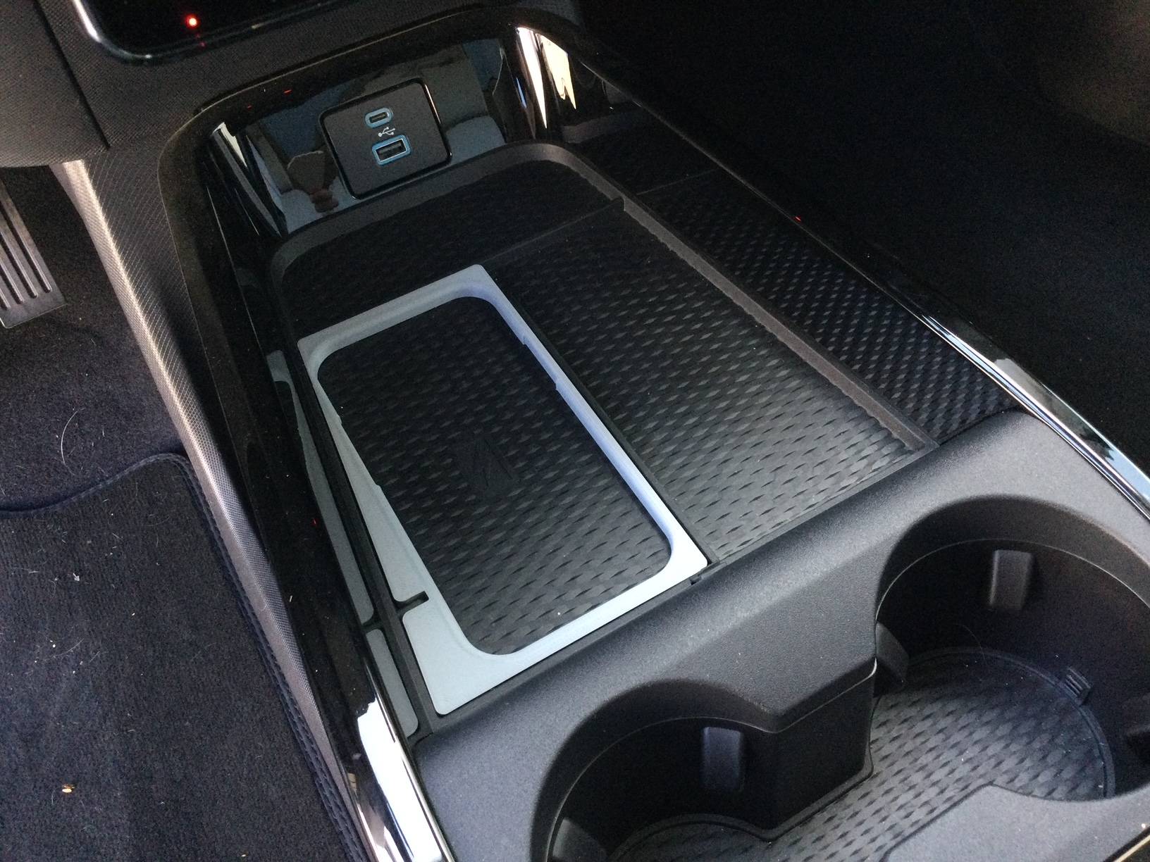

NOt sure f this was happenign to you but my phone would charge and then 30 seconds later stop. I do product design and own a number of 3d printers so I figured I can solve this and I did. I 3D printed this possitioning insert and now the charging works everytime all the time. This was built for an Apple Iphone 12 Pro with a magsafe case around it. It is currently printed out in PLA but I am going to print it out in ABS or polycarbonate so it can stand up to heat. PLA will deform. Anyway thought I would let people know this solves it.
Thank you SOO much for this - such an elegant solution to this problem. Worked great for me!
