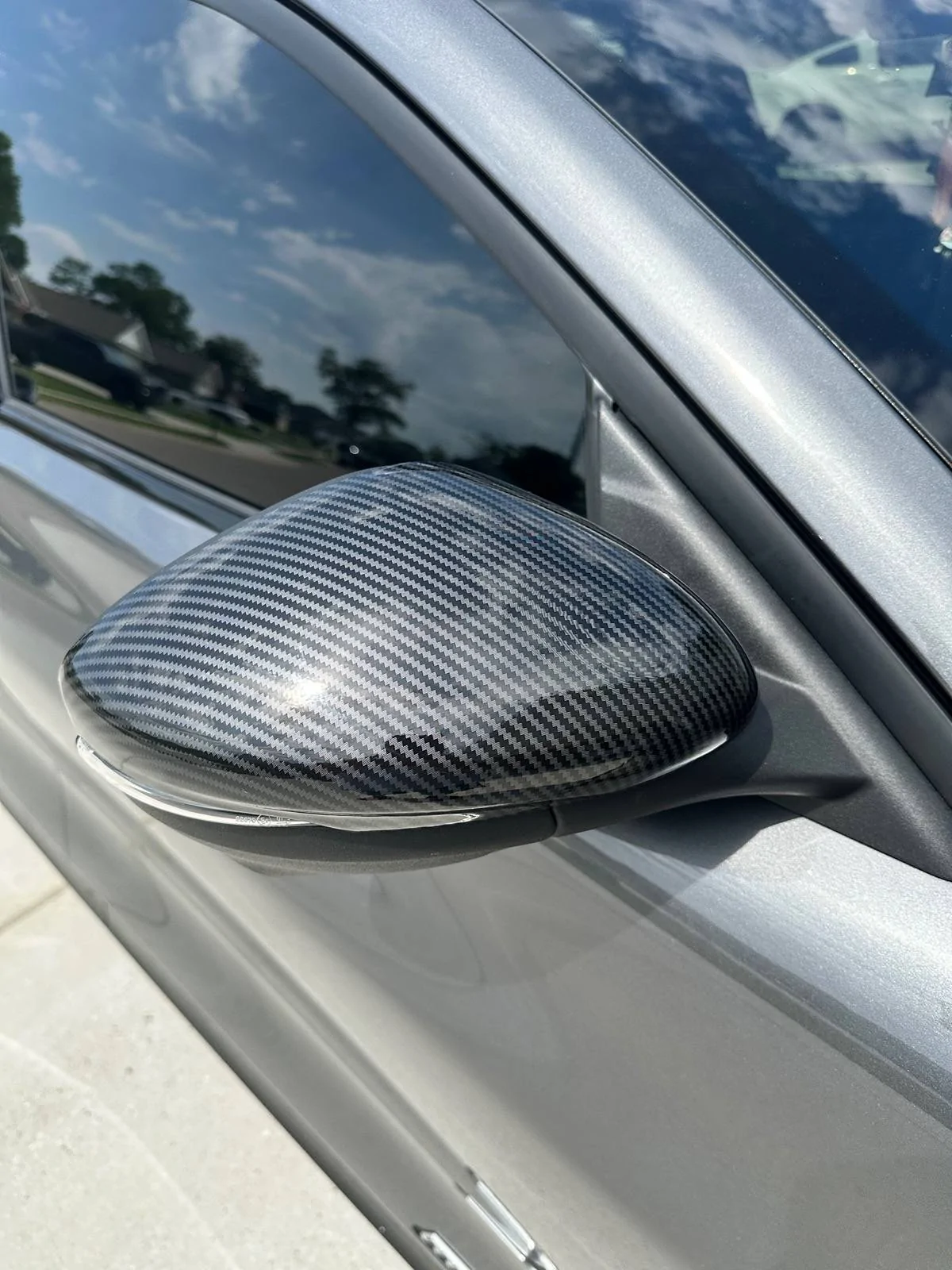

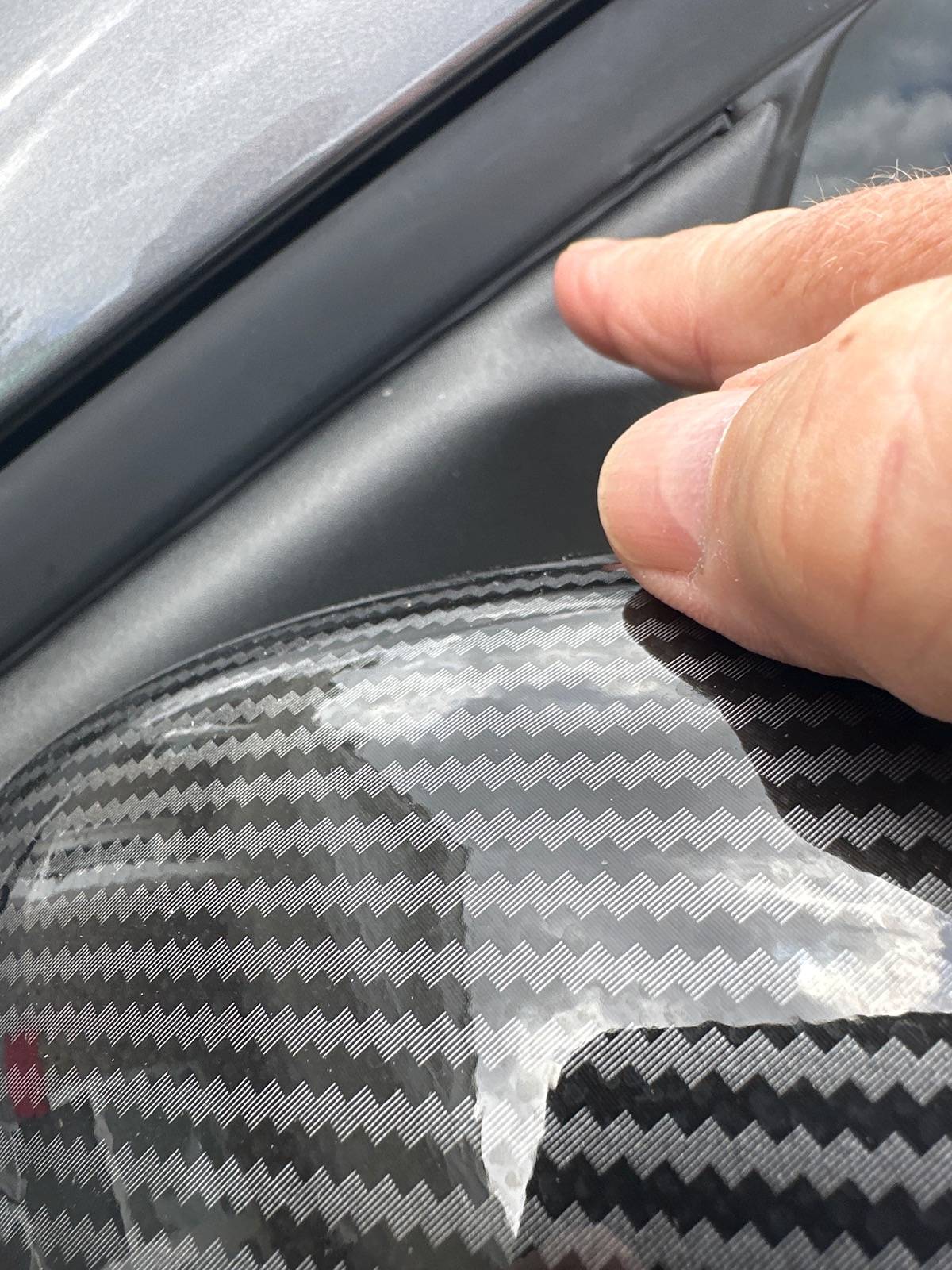

I just added this little 10 1/2 inch piece of screen retainer rubber on each
As a test - I put a large piece of electrical tape to cover that gap and smooth out the entire long are and while it might be a tad better under 70mph, I still hear the wind noise directly over my ear at 75mph.
I think the overhang piece over the door window is the major source of turbulence at high speeds.

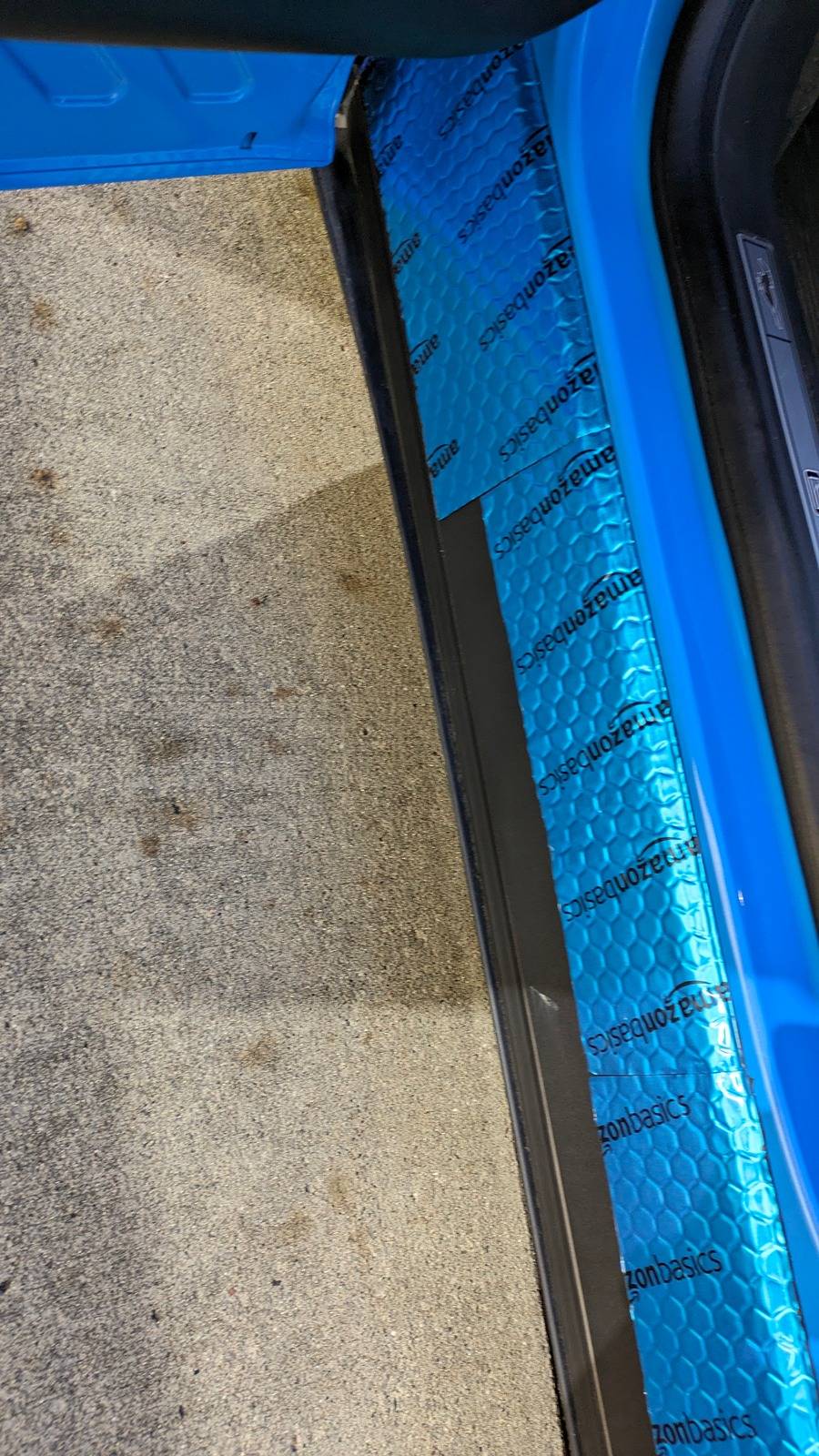

From my untrained ear and no hard measurements, I think the source of the road noise is from the wheel well areas. My current Mach-E is noticeably louder than my former Ioniq 5 which was noticeably louder than the ultra-quiet BMW i4 (I actually owned all three for about 2 weeks before I sold the i4). All of the noise was from the underneath. With the MME you can "hear" the road underneath emanating from the footwell area but on the BWM i4 - the road noise is almost non-existent except for very rough patches.

People (myself included) have had good results putting a thicker rubber piece in that gap.
